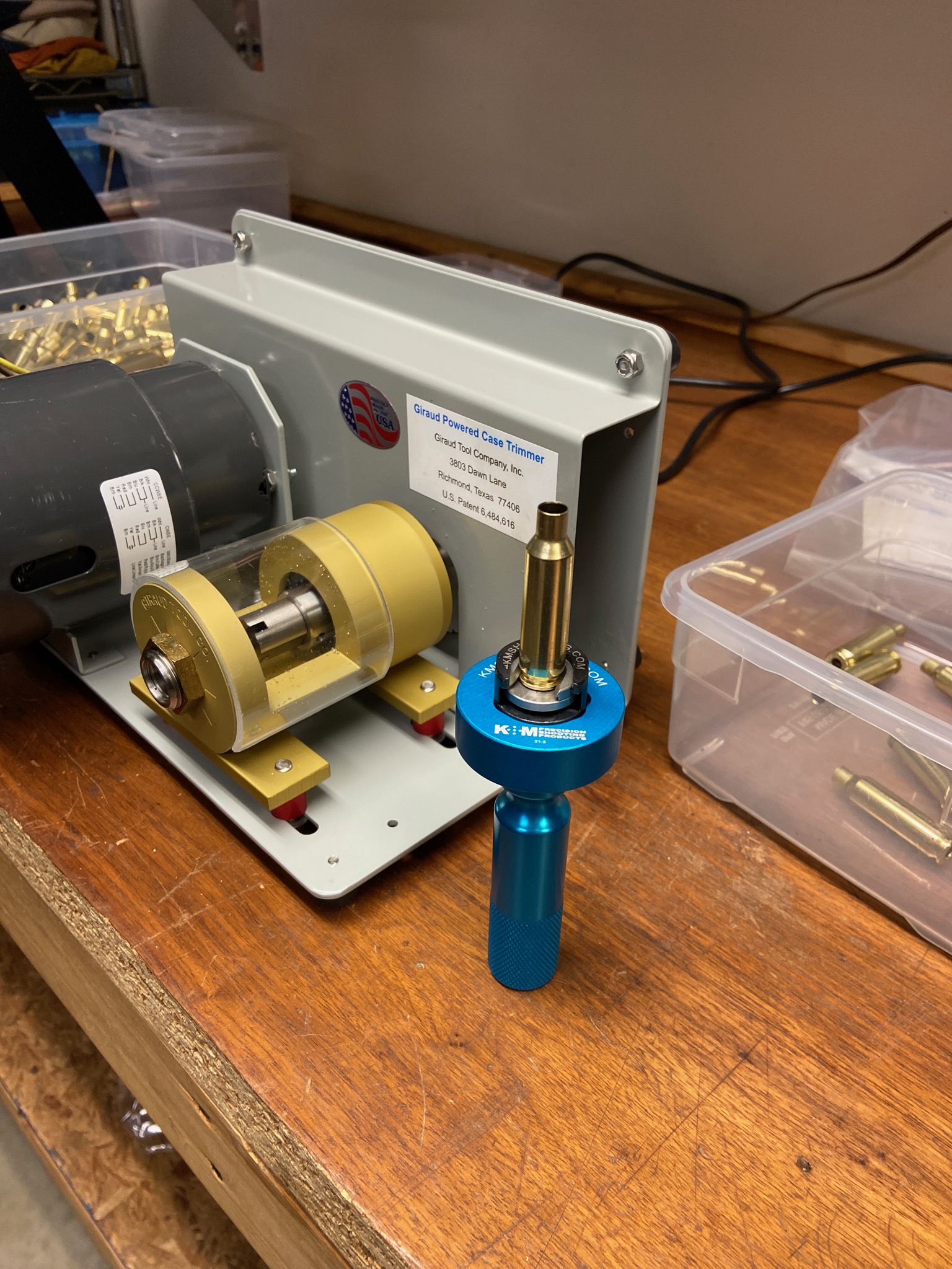

Ya on Giraud from me also. GREAT machine.
Now, some folks complaint is that holding the shell by hand in the cutter gets old on the fingers. Some use a glove to reduce vibration but I highly recommend this tool from K&M . Works like the Lee collet used by the Henderson. Very nicely made and very quick and easy to insert/remove shell. Highly recommend it for use with the Giraud.
Thanks, would I need all 4 pieces?
Well, you don't need the shell holder if you already have one. Its just a plain jane Lee shell holder.
You don't need the power grip (the blue ring that you turn to lock/unlock the case) but you really kinda do.
When I bought mine it came to $80 incl shipping but shipping was a bit expensive (UPS ground). I'm sure like everything else its probably a bit more expensive now. Check it out.

My quote comes with a shell holder for the 300 WM & the 6.5. I like the idea of holding the case as pictured, easier on my hands 👍
I see that you need all 4 👍🙂

You don’t need any of it. I use my hand and it’s fast and easy. It’s not hard on hands at all. Stick it in, half twist and pull it out. Simple. Try it before you buy a bunch of stuff.

If you do want to use a case holder, K&M has another one that holds the case by the body taper, rather than the rim. I'd look at that one instead. But as @padom said, try it first before you go crazy buying accessories you don't need.
I use a giraud as well.
For mag cases, there is plenty of case to hold onto.
For small cases like 300bo or 6br, they are so short you can really only hold them by the rims with the tips of your fingers when inserted into the trimmer. My soft computer hands dont have any clauses anymore and so my finger tips do hurt a bit after pressing down on a hundred little rim corners. A nitrile dipped cotton glove from home depot relieves the sharp pressure in the finger tips just fine and were like 5 bucks for 3 pair. Might not be enough for arthritis or actual joint relief in which case the k&m would be a handy crutch.
Been using the Giraud for years and highly recommend them. So fast and easy.
Well maybe the nerves in your finger are dulled but I definitely, absolutely, positively like the experience far better using the K&M.
And I have used gloves in the past....and still think that for ME the K&M is a massive upgrade for not too much money.
If you have hand issues this set up is the cat's pajamas for other trimmers like the WFT or motorized case prep stations.

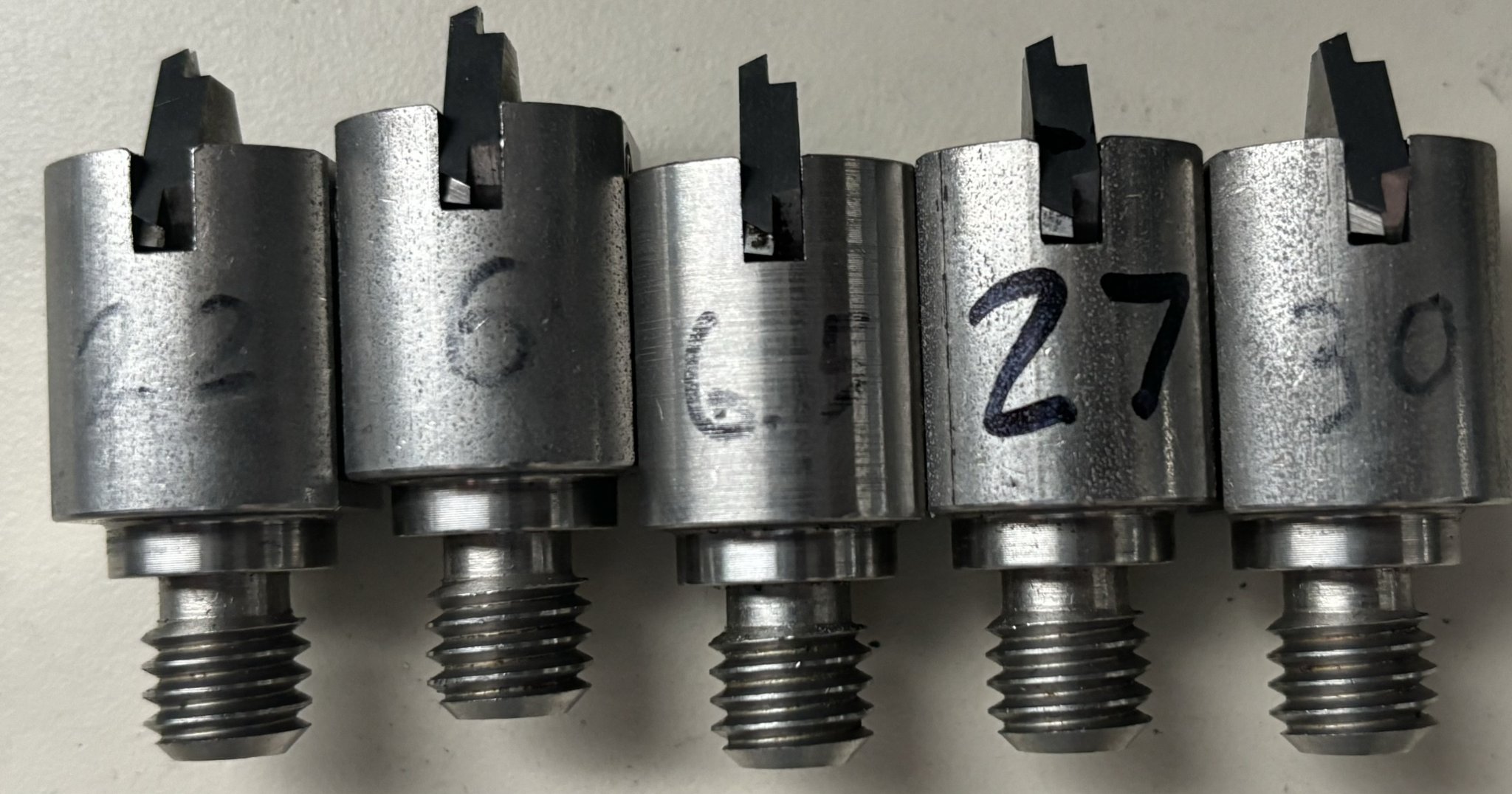

I like my Giraud. But I hate changing the cutter and setup for a new caliber. I also feel the chamfer was a bit aggressive than I needed. I ended up swapping in a flat cutter and just chamfer deburr on my Lyman case prep center. Takes a couple more seconds per case, but Im far happier as I can leave my trim chambers on my Giraud permanently set with a lock ring.
Would I buy one all over again? Yes
I cannot get behind this thought process. what a waste of a superbly designed machine.
You do you man. This setup gives me a perfectly flat square cut on the end of every case that is absolutely repeatable with a cutter that costs $5, never needs to be adjusted, and will last forever. I just dont like tinkering with the cutter setup for 10 minutes everytime I change a caliber. The rest of the machine is perfect for my use.
Then buy a cutter per caliber and quit changing it?
I've given Doug enough money over the years. With 7 calibers I currently use the Giraud for? That's another $385 I would have to shell out to just in cutter head assemblies. I do think those do come cutters, but if not, then its another $35 a pop. For ease of setup and use, the brass coming out the trimmer exactly the same, time after time, the flat cutter is just better for me.
Yeah get the cutter head set where you want and just pull it out when you change caliber. It’s super easy. I have a head for all my calibers. I wouldn’t waste my time cutting it flat and then having to go back through and chamfer and deburr. Totally defeats the purpose of the trimmer.
I mean, an end mill in a drill press would do the same thing as a flat cutter, and prolly be cheaper w/ a Harbor Freight drill press ... essentially just like using a Worlds Finest Trimmer (which would be even cheaper)

I do this but different neck thickness and neck tensions still results in a fair bit of adjustment headaches. No way id go back to trim, chamfer, debur in separate steps though.
I have found a happy medium where it does my br, dasher, creed, xc necks all with the same 6mm cutter. Havent had to change it in years across lapua, alpha, peterson, starline or hornady brass.
