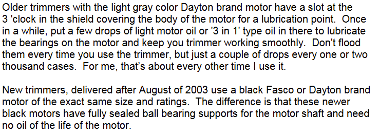

The motor with the grey case is the non-sealed bearing type and must be oiled occasionally. The black motor is the newer sealed bearing unit.
No, documentation is the same with no update about this.

Clip from current doc on his site

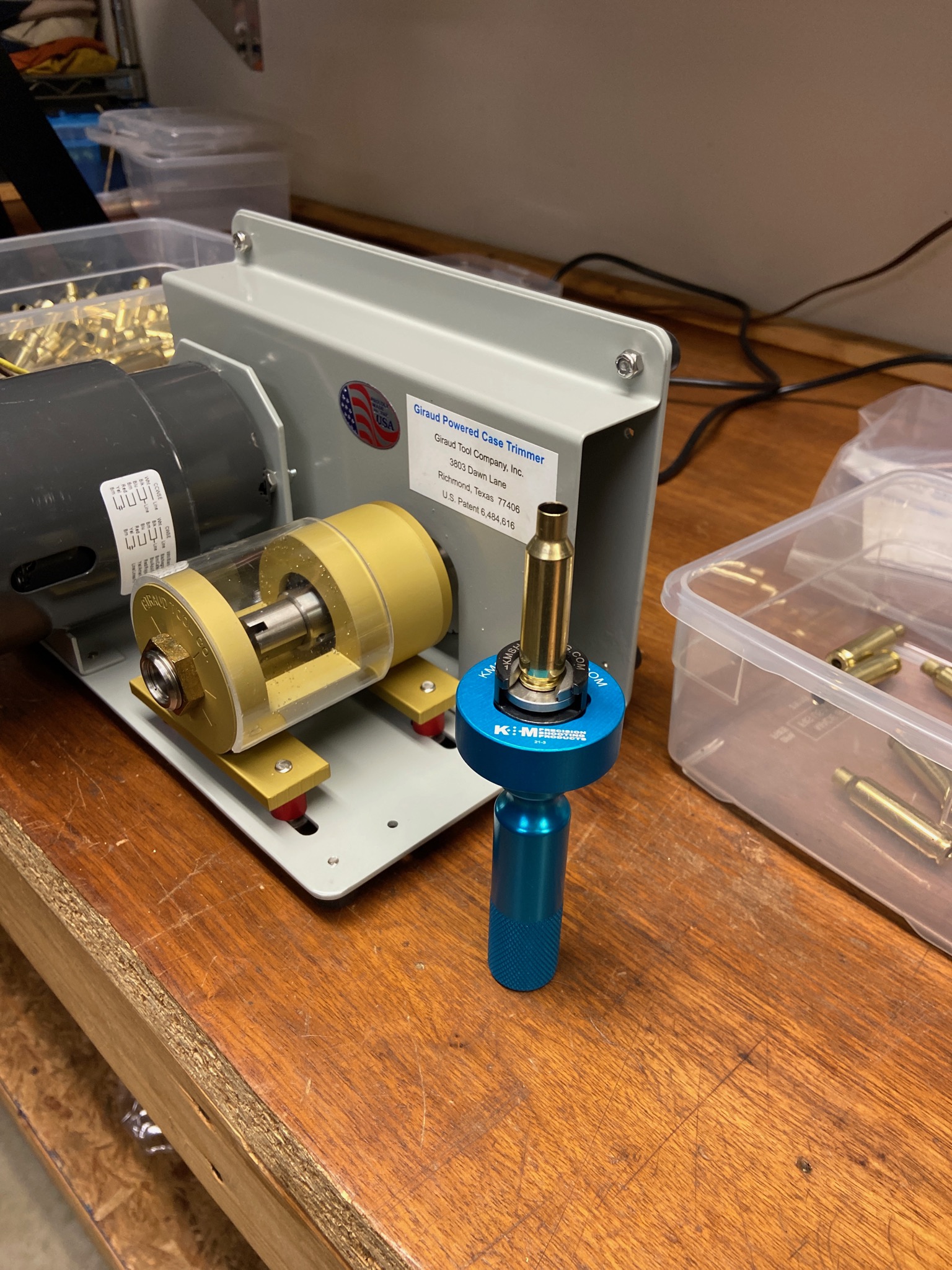

The unit does work well for me but my one...eh, complaint?...is the vibration up thru your fingers when holding the case against the spring pressure to trim. I was using tactile gloves which helped but was no optimum and I really was looking for some sort of collet system like the Henderson that I could use as a case holder when trimming.

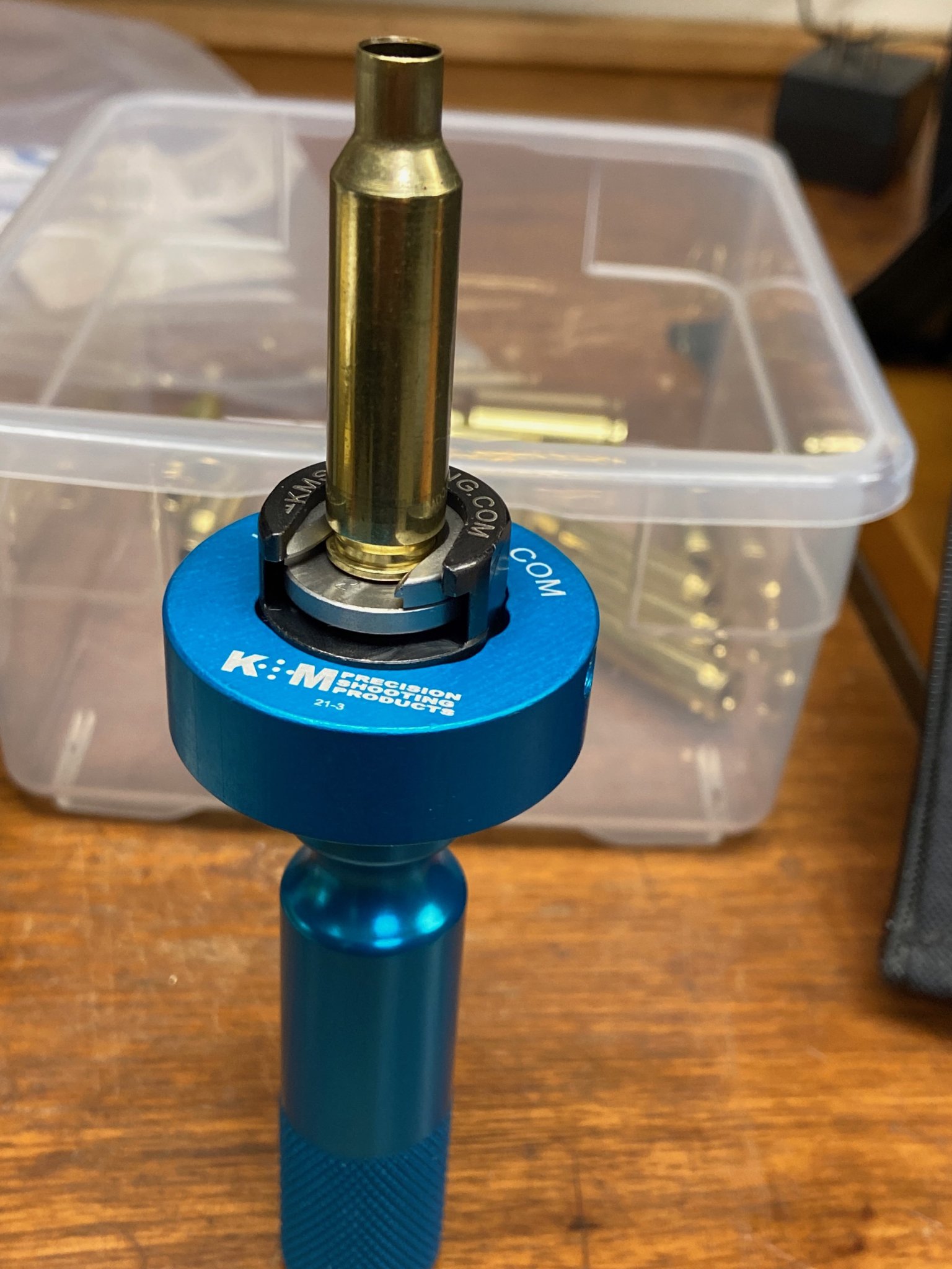

I found this at K&M and it works wonderfully and should be an accessory every Giraud user should consider.
About a 1/16th to 1/8th turn of the ring locks/unlocks the case in the holder so its quick, easy, and functions very much like the Lee collet in the Henderson. (NOTE: in this pic, the motor looks black but that's an artifact of the picture and its actually dark grey...and you can see the slot in the side of the casing for a bit of oil)
Link for the K&M "power adapter"...if you scroll down you will find the ring, shell holder, and handle to go with it. Total cost was about $65 and works perfectly. Your hands will thank you.

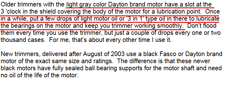

"I heard back from Doug and he says to apply 1 to 2 drops in the 2 oil slots of the motor every 10,000 to 20,000 trimmed cases. He says other than that, there’s no difference. It sounds like he has made the switch to this kind of motor and has no plans on changing back to the sealed version."
Note, in the manual he says every 1-2 thousand cases but when pressed by Creedmoor on WTF he would even consider going back to a non-sealed motor (like on my grandmother's sewing machine FFS) he came out with the 10k-20k interval and we never got him to explain the difference between that and what's in his manual. IMO, when he said 10k-20k he was just trying to minimize the apparent impact of his penny wise/pound foolish decision and I don't trust it (or really him) a bit. I'm going with the 1-2k metric, personally.
And mine is not light grey either...its dark grey and definitely not black....and Giraud confirmed that this model needs oiling.
You do have the slit in the case at the "3 o'clock position" for oiling on your motor, right? Its shown in my pic with the K&M tool in the post above.
Do as you like, but if bought at all recently then it has a motor whose bearing needs oiling.

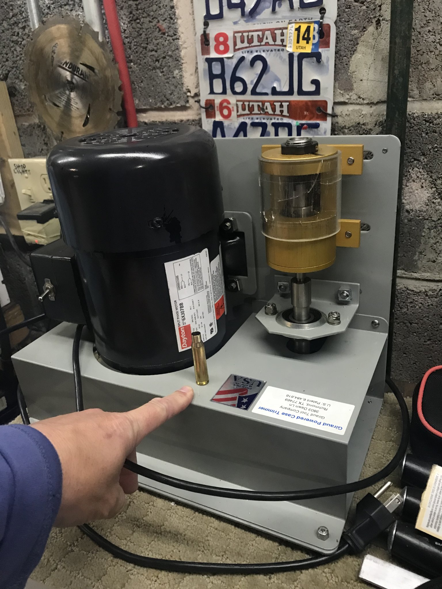

Here’s my Giraud with a 308 case how much oil does this motor need LOL
mine is almost a decade old, never a hiccup of any sort, I have worn out 2 308 barrels, a 260rem barrel, 6.5 creed barrel, and add another 200k 556 cases, I have done zero MX to mine, I would like to see some detailed pics of the bearing failure, or any other fubar parts
View attachment 7798499Here’s my Giraud with a 308 case how much oil does this motor need LOL
That looks like the motor is black...is that true? If so, it does not need oiling.
Does your motor housing have this slit in the side and a oil port that can be seen in this pic? If not, then you don't need to oil.
If it is grey and has the slit then...

It was a joke because the thing is massive. I’m pretty sure it’s a non-oiler
