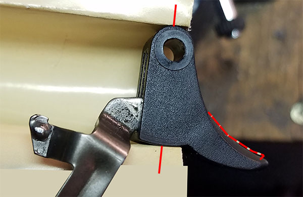

I have a Glock 21 Gen 3 and a Glock 17 Gen 4. The G21 slaps my trigger finger making it almost impossible to shoot well. You think recoil and flinch make for poor shooting. This is worse. Unless you have experienced this unpleasant phenomenon, its hard to describe. It is the trigger safety bar hitting your trigger finger when firing because it sticks out too far at the end of trigger press.
When getting ready to sand and polish the safety bar, there is a trick you should note. The problem is the safety bar protrudes too far forward when the trigger is pressed fully to the rear. When sanding and polishing, the key is to hold the safety bar fully to the rear within the trigger while performing that work. If you don't hold it to the rear when removing polymer, you may end up removing too much polymer. What you want to achieve, without removing material from the trigger, is a totally smooth trigger face and safety bar interface with the trigger pressed fully to the rear. My solution is shown.
I placed the trigger & safety assembly in a padded vice that held the safety bar fully rearward. Caution: Too much clamping pressure will crack the trigger mounting hole. Then, remove excess safety bar with a Dremel drill with fine grinding wheel on slowest speed to avoid heat. The excess trigger bar was removed without touching the trigger surface. Finally I polished the assembly until the trigger face was one smooth surface and then cleaned out all polishing compound with Hoppes # 9 (old school for old farts). You don't want to leave any grit in the interface to ensure the safety bar functions properly.
In the attached jpg, I indicate with red vertical lines where the vice clamps the assembly to ensure the safety bar is fully to the rear. Also, I show a red line indicating where the original safety bar was protruding from the front of the trigger with the trigger fully pressed. That is the ouch part that no longer exists. Took it out today and shot 100 rounds of 230 gr ball ammo @ 880 fps. No pain. First time I've shot more than 20 rounds at a time from this gun. It's not a recoil issue. I've read threads from other sites blaming the shooter ... improper grip ... etc. etc.
I think Glock simply missed this on several model guns, mostly higher power guns. Fix it and have fun.
