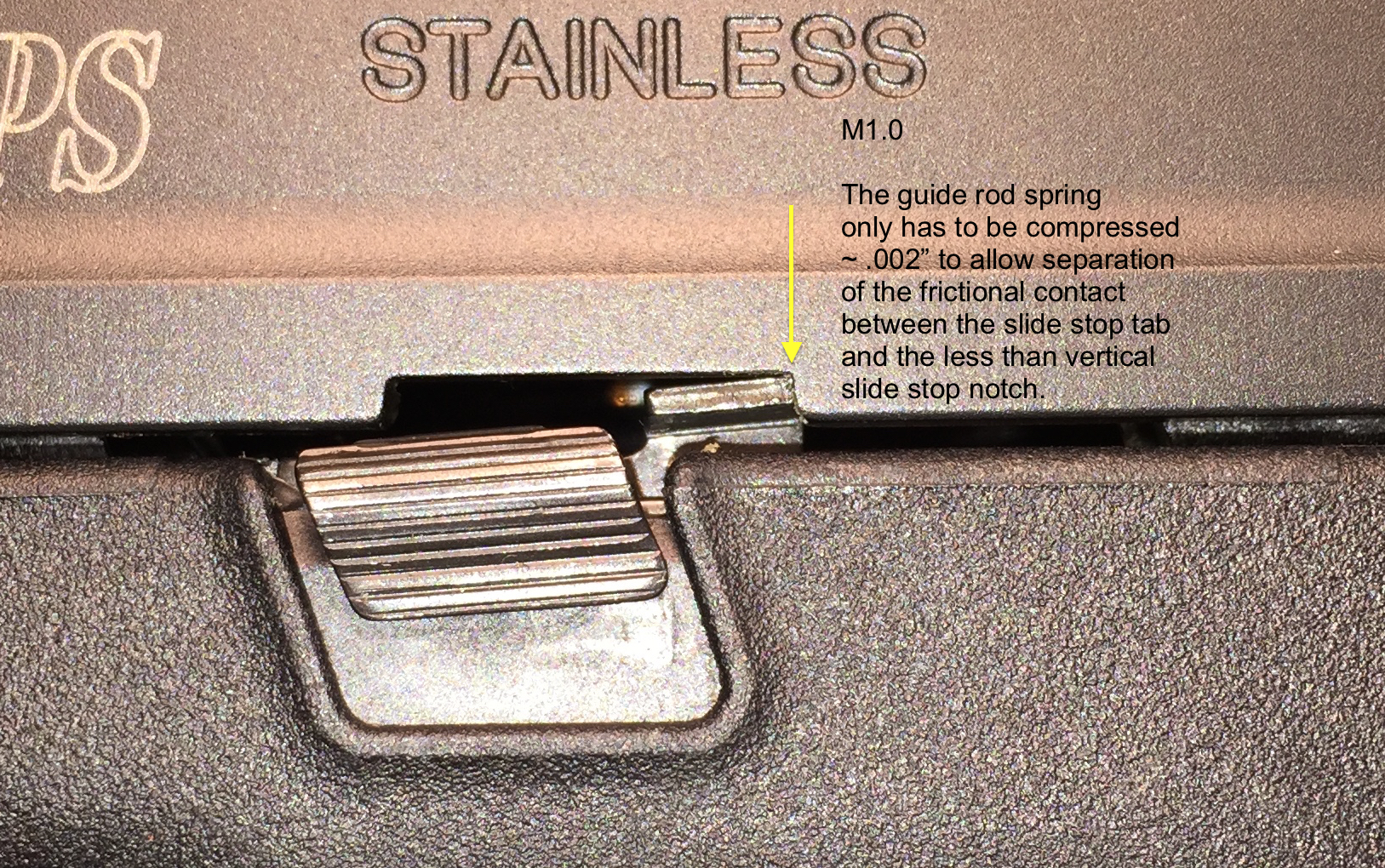

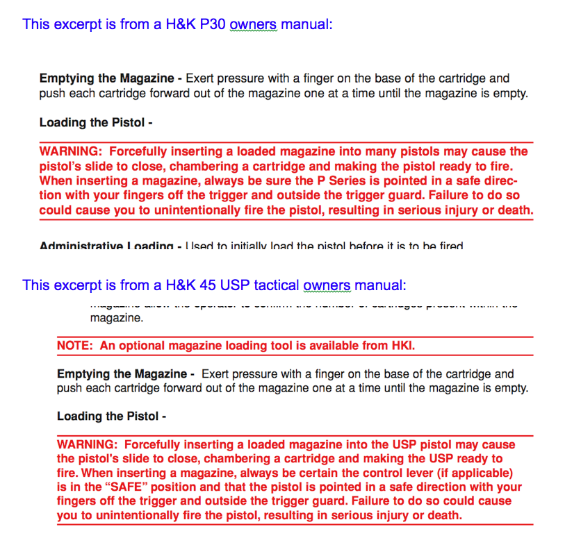

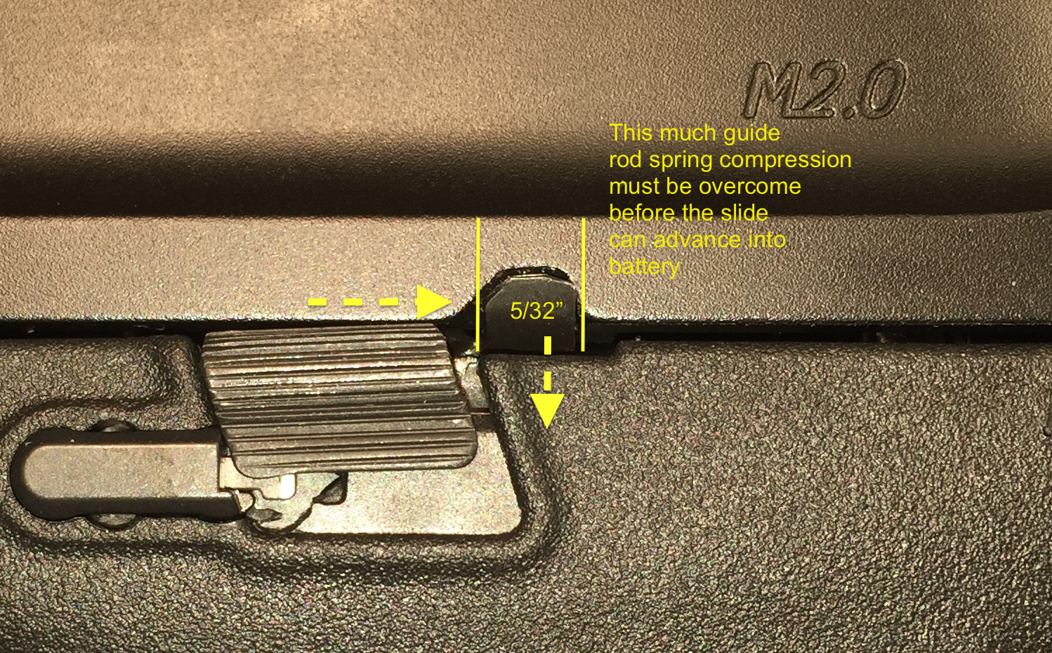

Virtually any semi-auto will advance the slide into battery IF one violently inserts a magazine into the firearm; read their respective firearm Owner Manual and it's mentioned. The slide lock device on most semi-auto's have a vertical face apposing a near vertical slide stop notch surface. The jarring incurred by the force of insertion allows the slide stop / release to momentarily disengage from its frictional contact with the slide notch; because the slide stop / release is spring powered downward, the slide stop/release mechanism immediately moves downward that then allows the the slide to move into battery under guide rod recoil spring power. The S&W M&P 2.0 has a patent pending mechanism that incorporates a spring loaded detent separate from the slide stop lever engagement AND requires the slide to move rearward about 5/32" before the slide stop engagement is powered downward by its separate spring. All others only to have the slide / slide stop lever engagement move a few thousandths of an inch to break frictional contact, thus allowing the slide to move forward due to forceful inertial loading of a magazine. This is Newton's First Law of Physics in action; a body (slide stop / release lever) at rest tends to stay at rest. This observed phenomenon has Nothing to Do with the health of a spring, i.e. a "tired" slide stop / release lever spring.
Violently inserting the magazine into the firearm sufficient to advance the battery forward is reason to respect the fact that the primary safety on any firearm is muzzle direction; always have that muzzle pointed safely when performing a reload.
