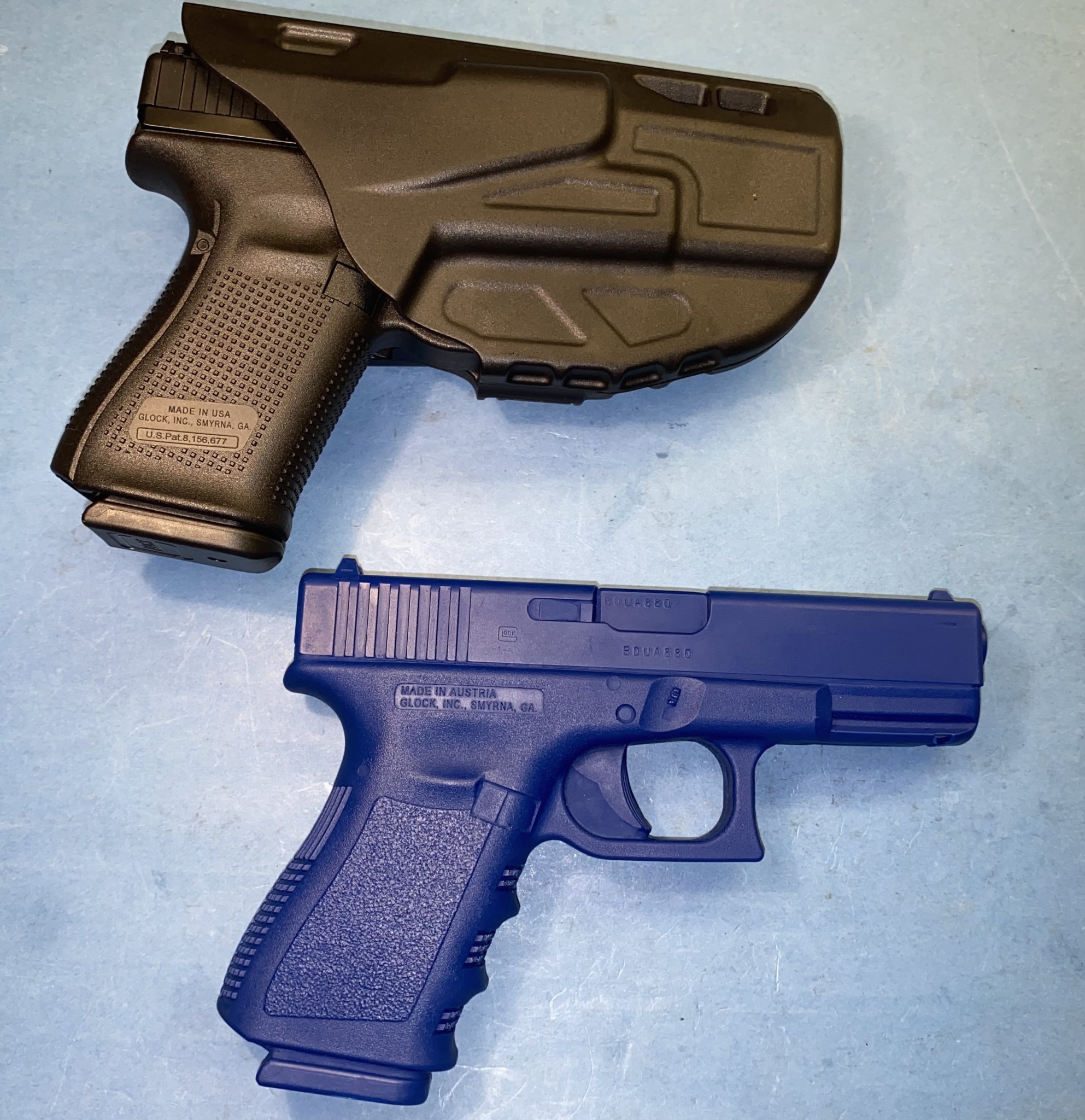

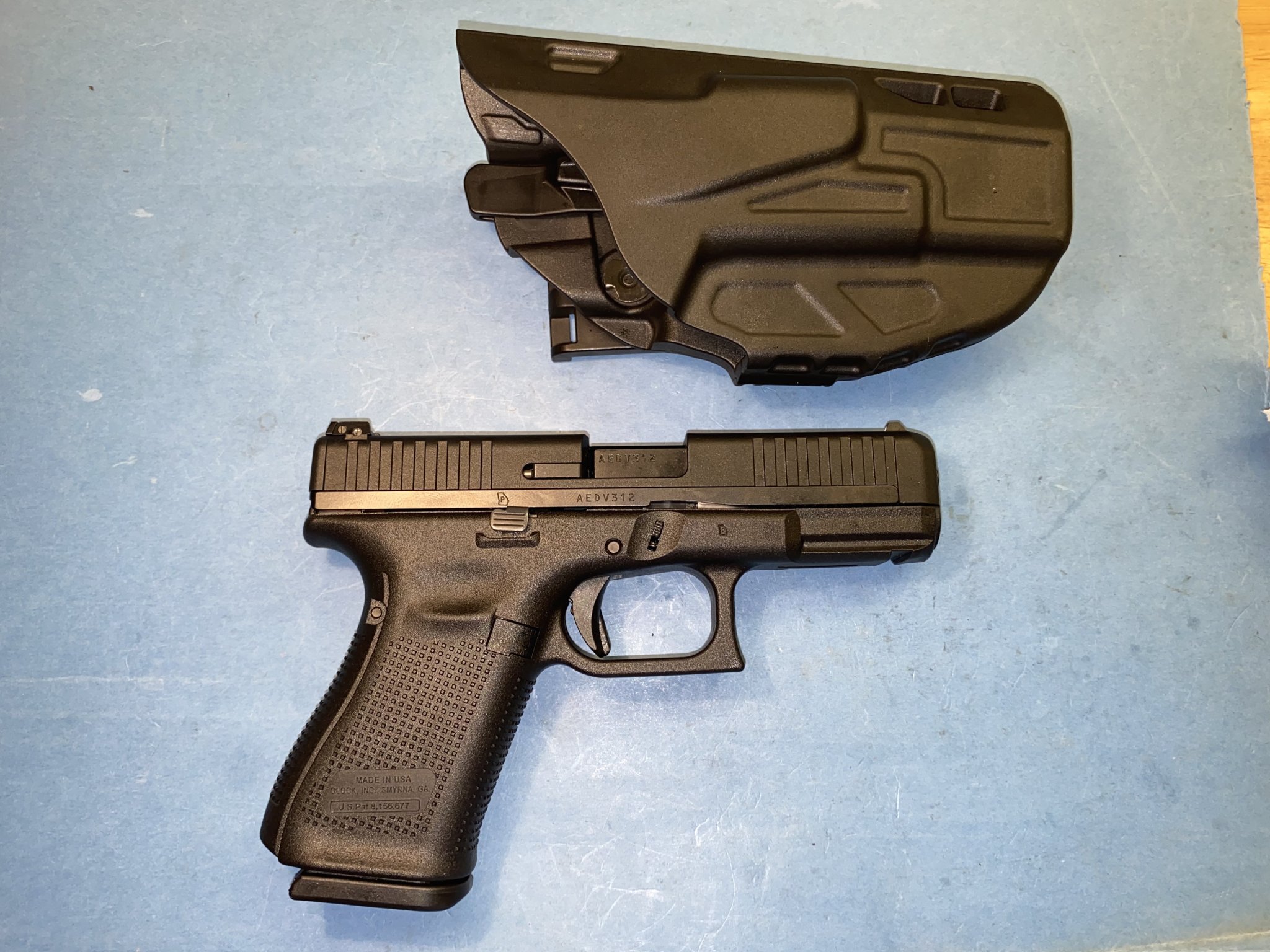

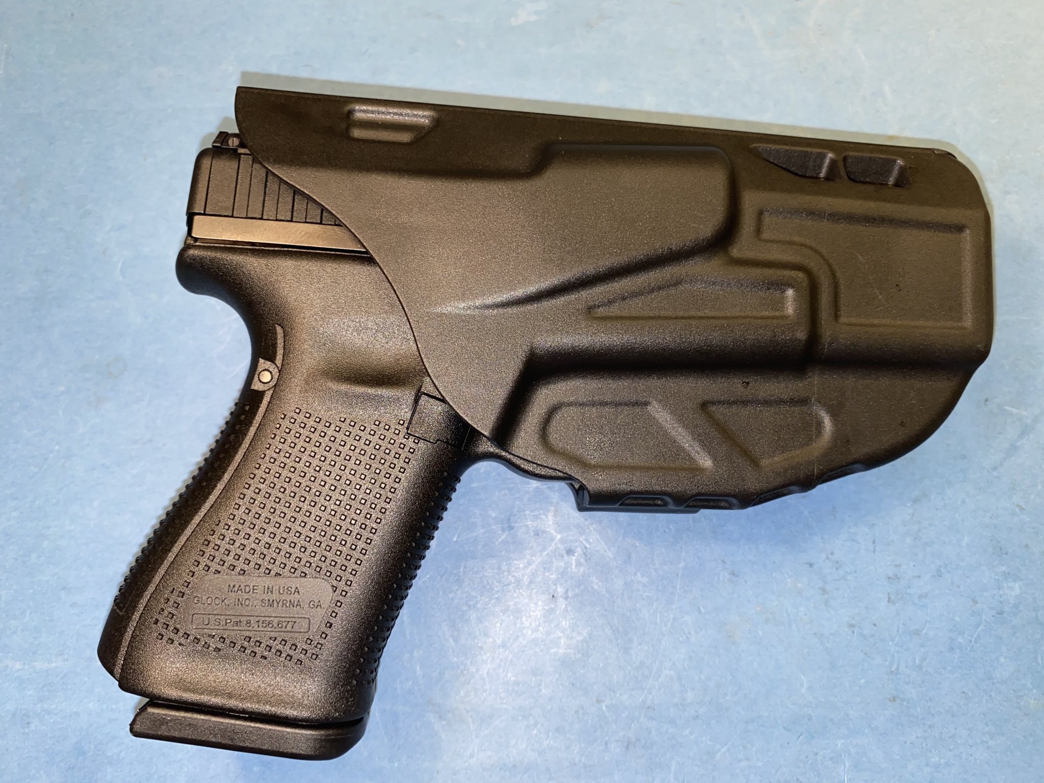

IF it doesn't have to be soft, I am a Safariland fanboy for most of my sidearms; I appreciate the security. I use their G19 ALS. The blue gun fits just like the real one.

The Real G44 shown is a Gen5, the blue gun not.......it has finger grips which were eliminated with the G5 iterations.
Reactions: USMC22
The G44 does not fit Safariland G19 holsters unless you remove the post which locates the muzzle. The barrel axis on the 44 is lower in the slide, and of course is a smaller diameter.
It will work in a 17 or 34 length Gen5 holster.
