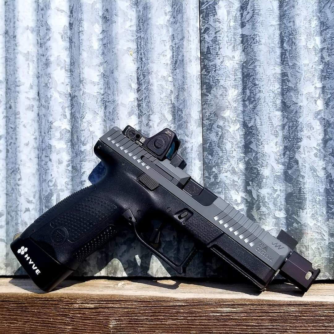

I used Jagerwerks for my P10c and they did great work. Also had them do the forward serrations as well. At the time I had it done, I received the slide back exactly one week from the day I shipped it however I didn't have them cerakote it.
