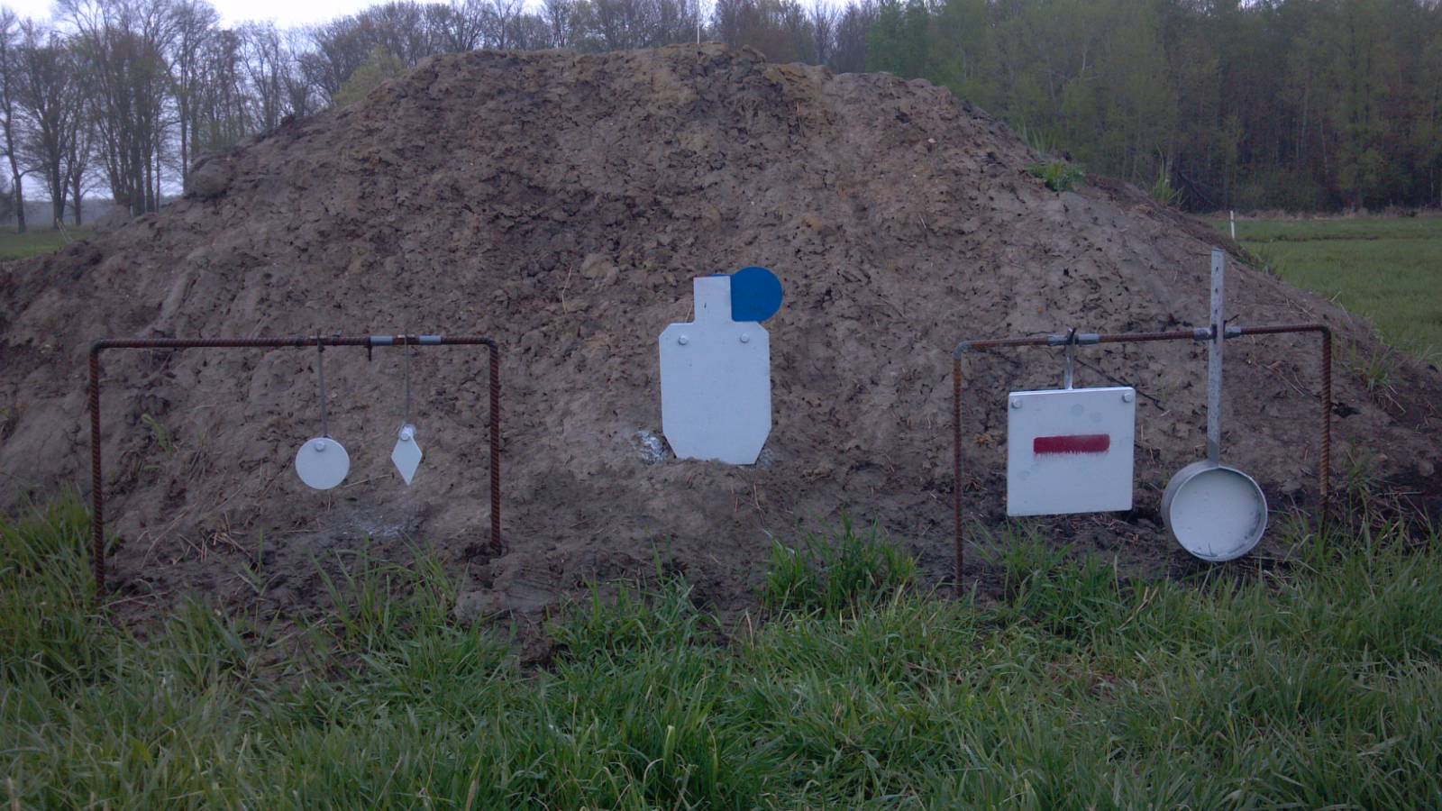

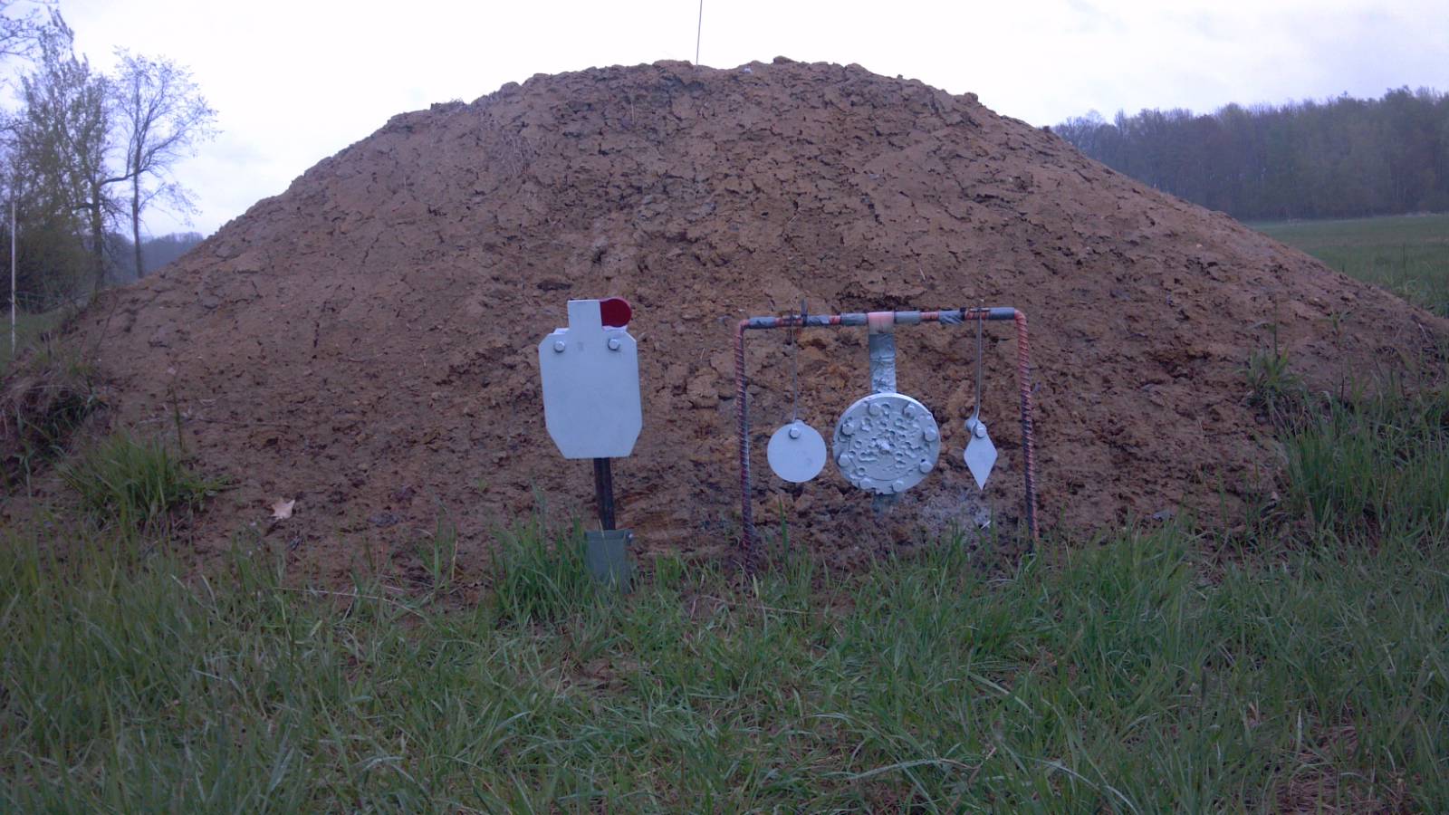

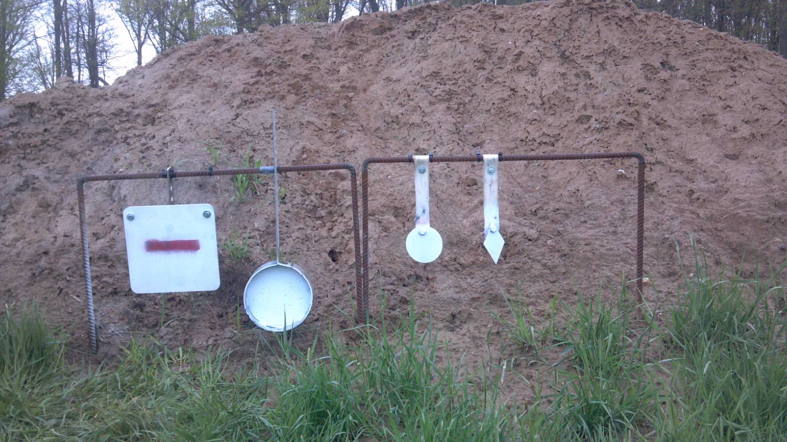

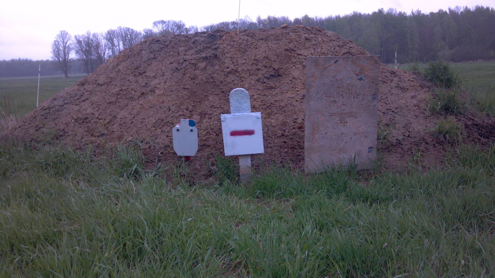

All I have are pictures of the targets at 500, 600, 700 and 823 in my back yard
Everything is AR500 other then the 9" gongs and the head on the headhunter
Miniature Hostage targets located at 500 and 600
3”x 5” diamonds
5” rounds
8” rounds
12” Squares
JC’s Hostage target – a high use target, tends to get a lot of use located at 700
A couple 9” gongs
A homemade Head hunter target with the 12” square as a chest plate
We have steel for another private range to accommodate shooting to 3600 yards as far as 1 moa targets.
Total on this range
Six 5” square targets ½” AR500
Three 6” square targets ½” AR500
Three 12" Square targets ½” AR500
Two 24” square targets ½” AR500
One 36” square target ½” AR500
Three 100% IPSC targets ½” AR500

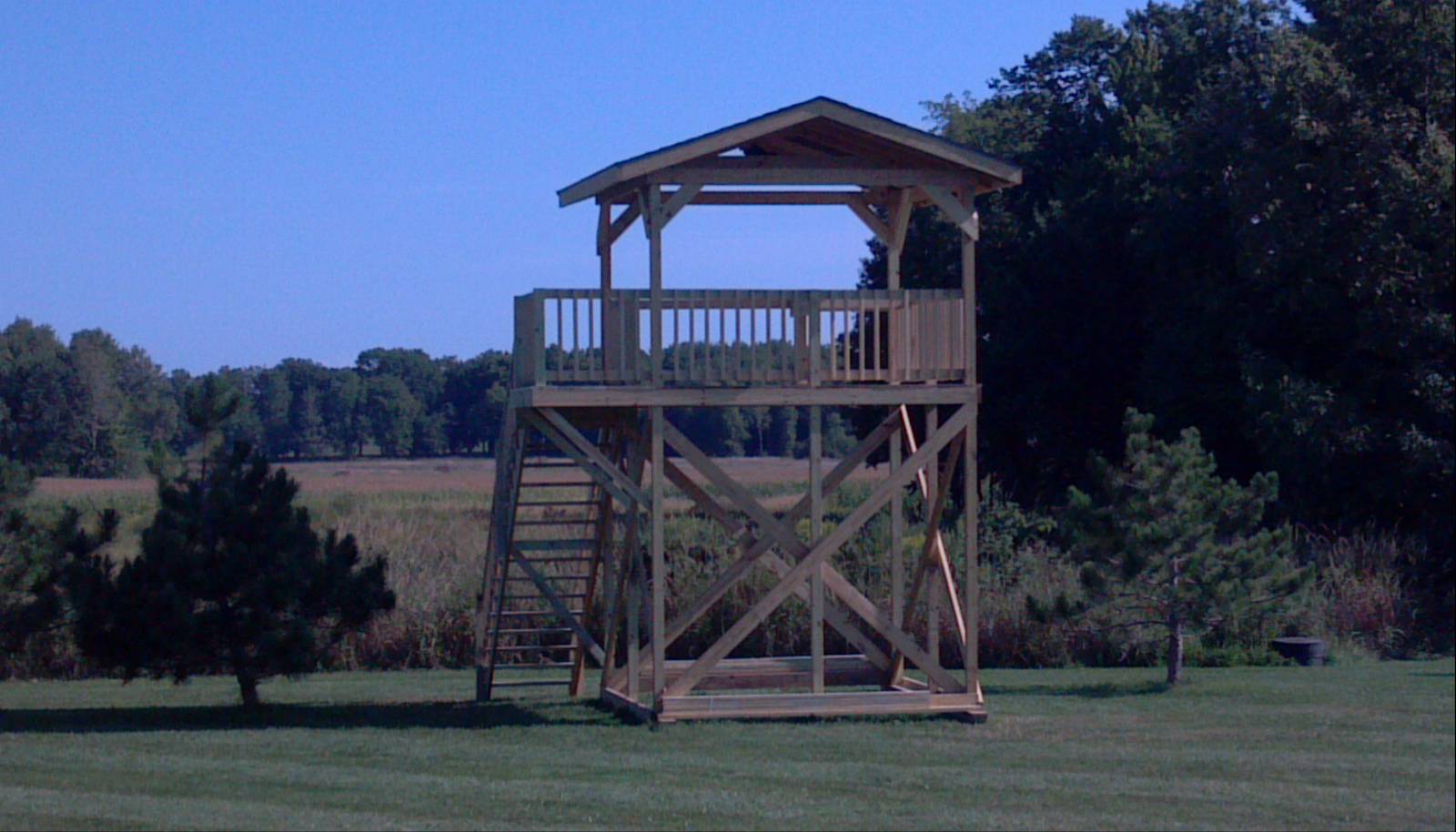

The shooting platform is elevated to 10' and allows three shooters to shoot prone easily as well as a shooting bench for those needing. The platform is very solid.

OS-OH, nice tower!
How much you have into it?
About $1500.00, with the help of a few shooting partners and three weekends it was done. we built it to be rock solid. (all treated wood)
