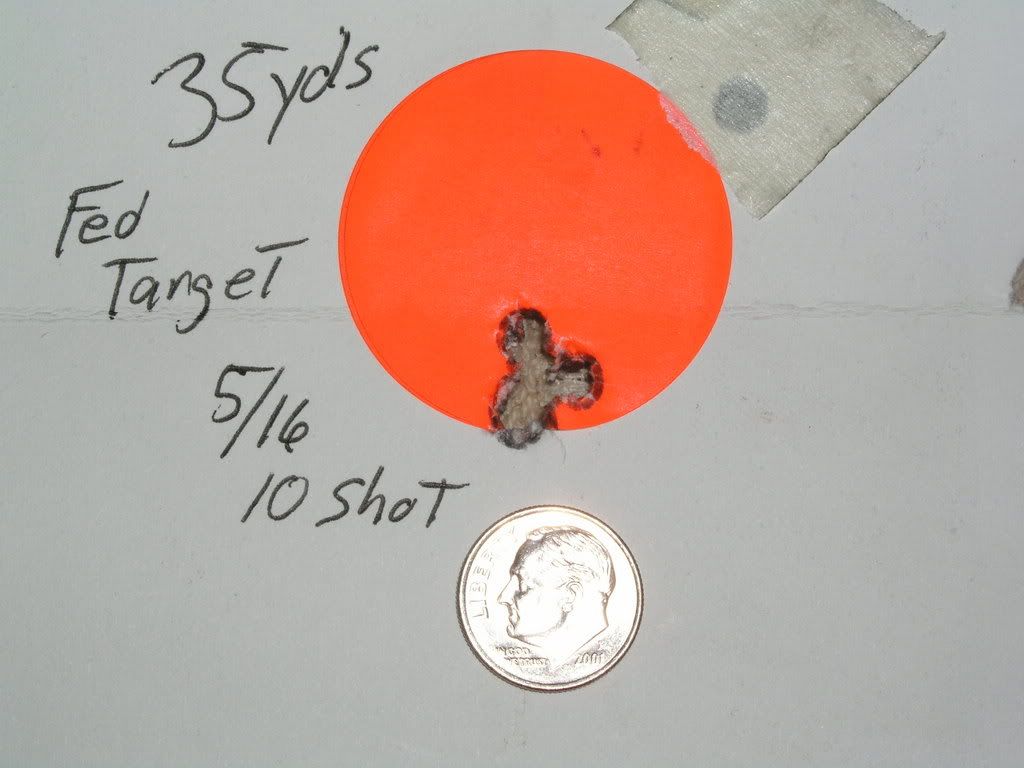

I done the same thing but being a poor college kid at the time I kept my build as cheap as possible. I had the trigger worked and put a Green Mountain 20" barrel on it. Bought a cheap plastic stock and after running hundreds of rounds of various types of 22lr ammo through it, I got this group. I was aiming at 6oclock. Group .3125 -.22= .0925 group.
