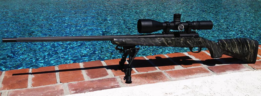

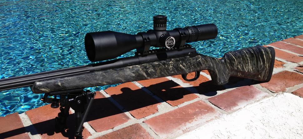

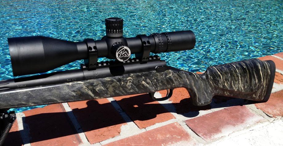

I am the VERY happy owner of a new 7STW. Specs are as follows:
Surgeon 1086 action
McMillian Rem Hunter stock 50%black, 25%OD, 25%Lt. Tan
Krieger 5.5 taper fluted 9.5 twist 28" long
Jewell trigger
Nightforce 5-25 ATACR scope MOAR reticle
Initial load development with 140 Accubonds yielded 1/2" groups at 100 yards. 80 grains of IMR7828 resulted in a velocity of 3477, SD5, ES12.
Can't thank Robert Gradous enough for both his beautiful work and his patience in working with a rookie like me to select the parts for this rifle.
