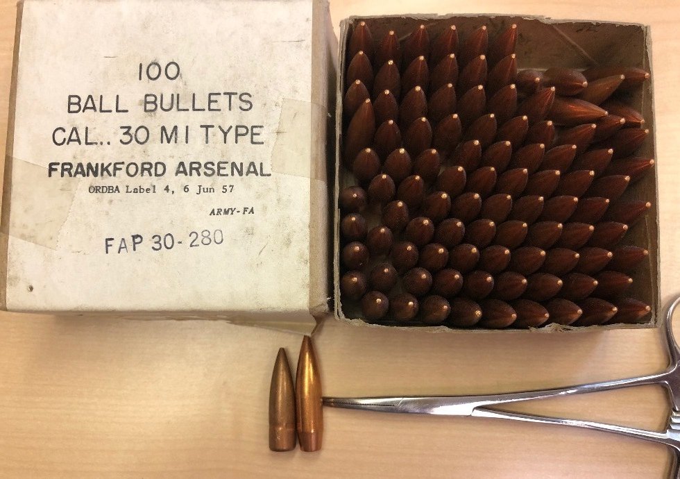

What is the weight and profile of the 1939 National Match ammo that you have?
It is the M1 bullet, 172 grains with a 9 degree boat tail, 30 caliber. It was introduced in 1929 and it still used in M118 special Ball. You used to be able to buy them in bulk from the CMP.

"What is the weight and profile of the 1939 National Match ammo that you have?
lonegunman7.62x51 answered the question, and attached is a picture of the profile of some 1957 era M1 bullets (174 grain) with the boat tail design. (To the left is a typical 150 grain M2 bullet which replaced the M1 bullet back in 1940 for the M1 Garand, but the heavier and more efficiently bullet design was used post-war for match ammo).
I'm curious about the twist rate in your rifle, have you checked it? I have a Remington 40X KSSB in 7.62 and an M24, both use 1-11.25" twist instead of 1-10.
Thanks for the bullet information.
