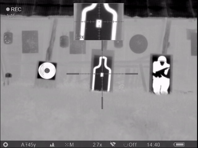

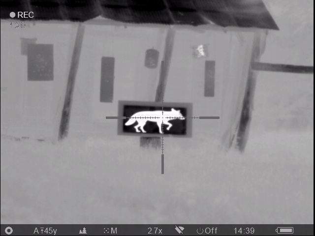

Here is a pic through the XQ50 at 45 yds. The 2.7x optical mag is really nice and the 384 17 micron core is impressive and a great alternative to the 640 if you want to save some $. vlcsnap-2017-04-13-21h58m03s707.png
