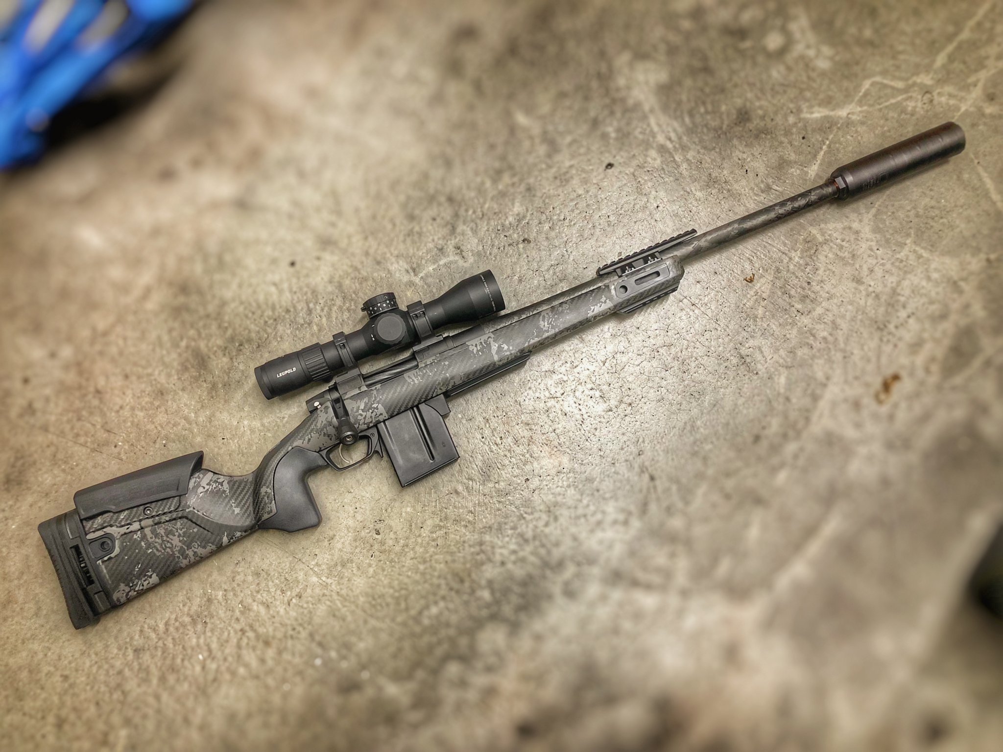

I just bought a Gunwerks ClymR with the titanium action and proof barrel. Fit and finish is about the best I’ve seen on any rifle plus I really like the ergonomics of the new stock. I’m not sure how it works with proof research rifles but with Gunwerks they also give you the load data then once you confirm the ballistics they burn a turret for you. I went with a Swarovski X5i 3.5-18x50 on top.
I’m loading up a few of their loads and a bunch of other loads to see if I can burn up some of the powder I’ve got here, heading to the range tomorrow.
I’m loading up a few of their loads and a bunch of other loads to see if I can burn up some of the powder I’ve got here, heading to the range tomorrow. View attachment 7007436
Two things. Thanks for sharing the photo. Looks amazing, I’m curious to see your grouping tomorrow. Is that a savage barrel nut on the barrel?
2nd question is who’s hand is in the photo ? Lol.

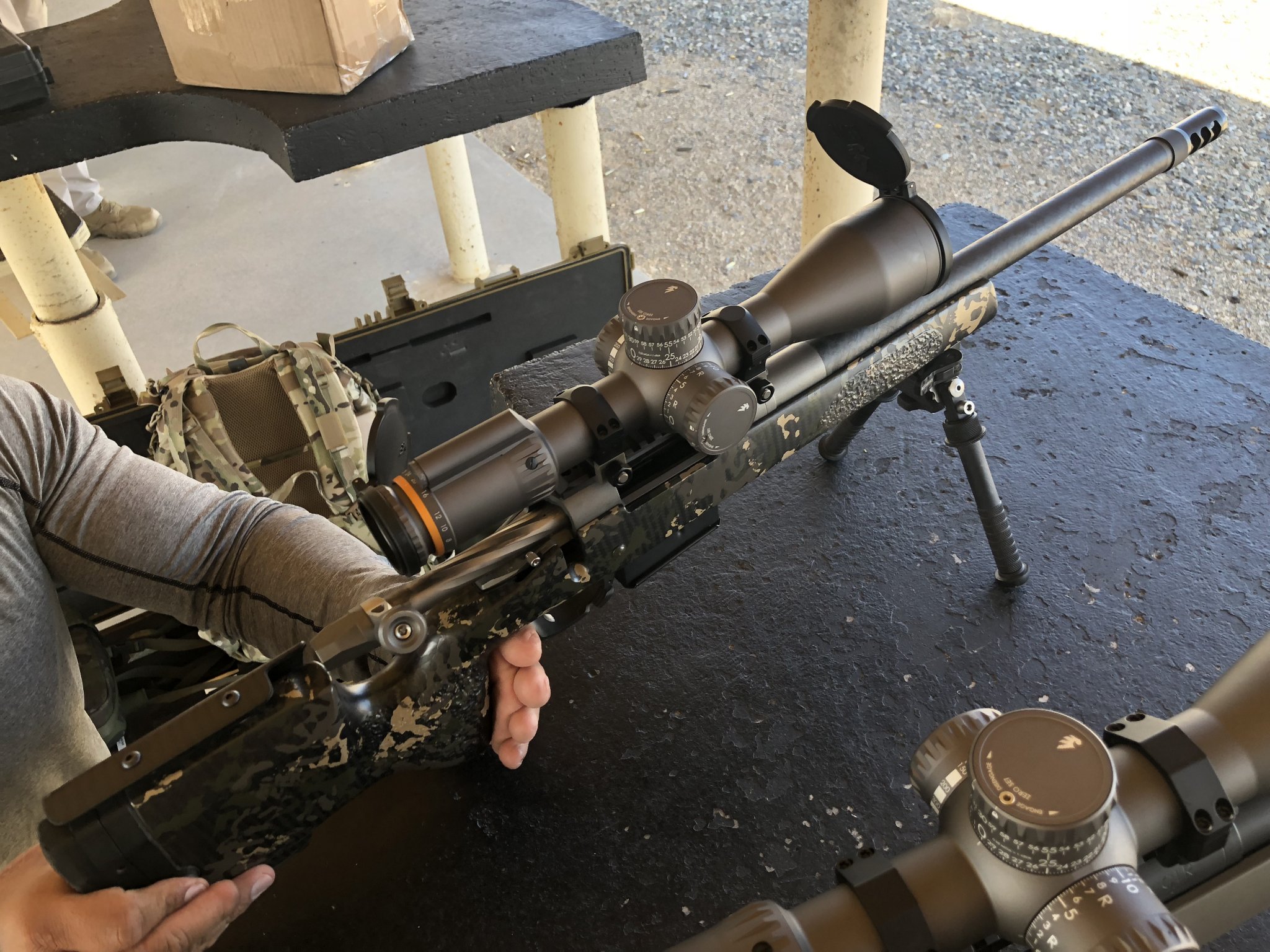

This was the drop gun. I think they named it the CoPilot.
I think they make their own barrel nuts and actions and use proof barrels.
The hand is a gremlin who lives in the island in my house. Lol.
That drop gun looks like it’s sitting in their Verdict stock, nice looking bench gun.

First drop gun stage was just 5 rounds on a single distance so the scope didn’t even have to be on, it was already dialed to the distance.
We got to actually use the hud on the 2nd drop gun stage which was using the Gunwerks Verdict in 30 nosler. 3 or 4 yetis (don’t remember off the top of my head). RO gives you the ranges and you just dial on and in the top of the field of view is a small hud with the distance. Simple and easy to use.

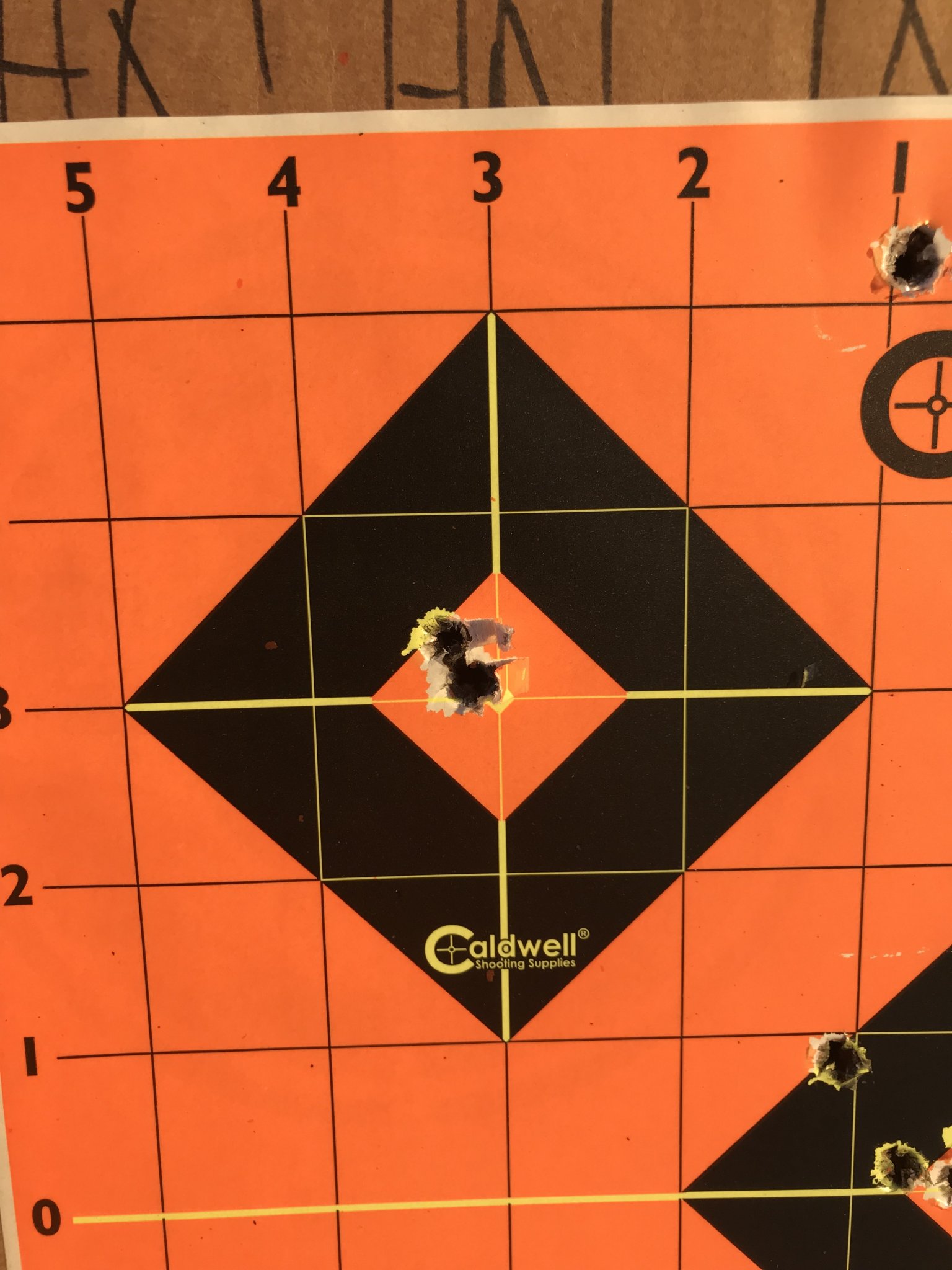

Here is a group from today’s range session using the load data given to me from Gunwerks. Pretty happy with it.

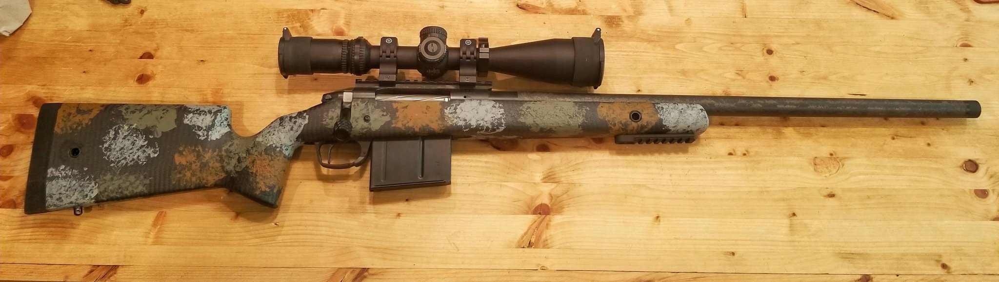

Damn near exactly what I went with for my 28 Nosler, I went with TT special instead of diamond, it's a hunting gun and I want the trigger around 2.5-3 lbs, and then the non adjustable EH1 w/ mini chassis.
The whole cost of my gun with rings, the AMG, and smith work on barrel blank came out cheaper than the bare Gunwerks rifle with carbon barrel.
I could not be happier with the end result.

Nice looking setup!

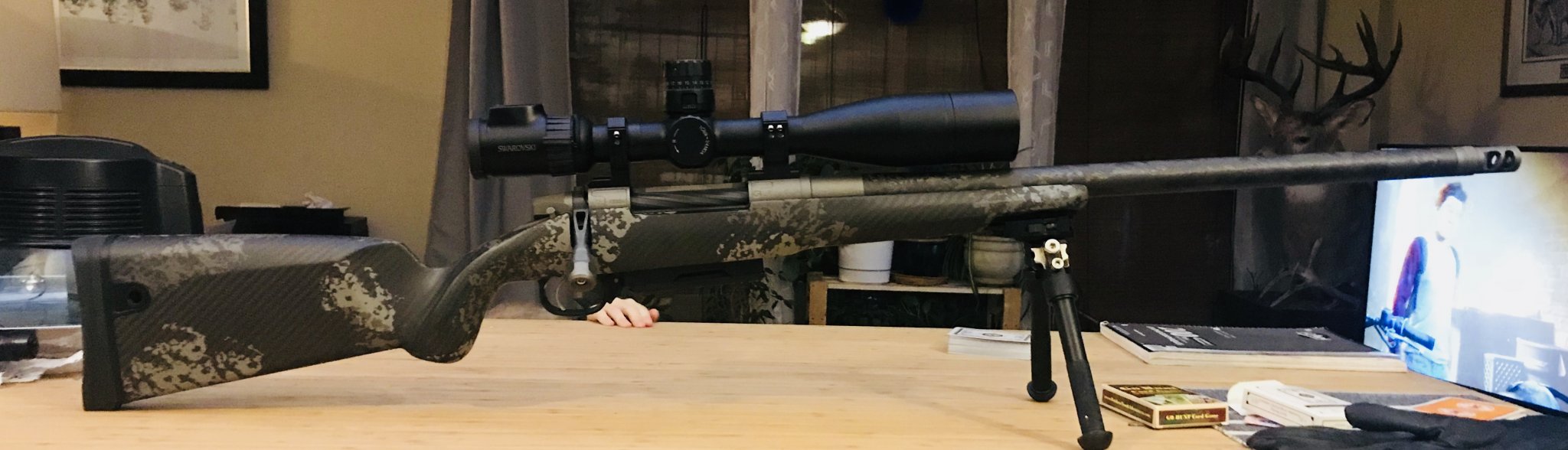

My Ti Verdict 7 SAUM (as pictured) comes in right at 10 lbs with a 24” Proof barrel and Leupold Mark 5 3.6-18. 10.8 lbs with suppressor. You’ll save pounds with a ClymR over the Verdict with the minimalistic hardware on that guy.

Badass. Thanks for sharing. I love the streamlined picatinny in the front and the dovetail in the middle.
You're making me want to cancel my Manners...

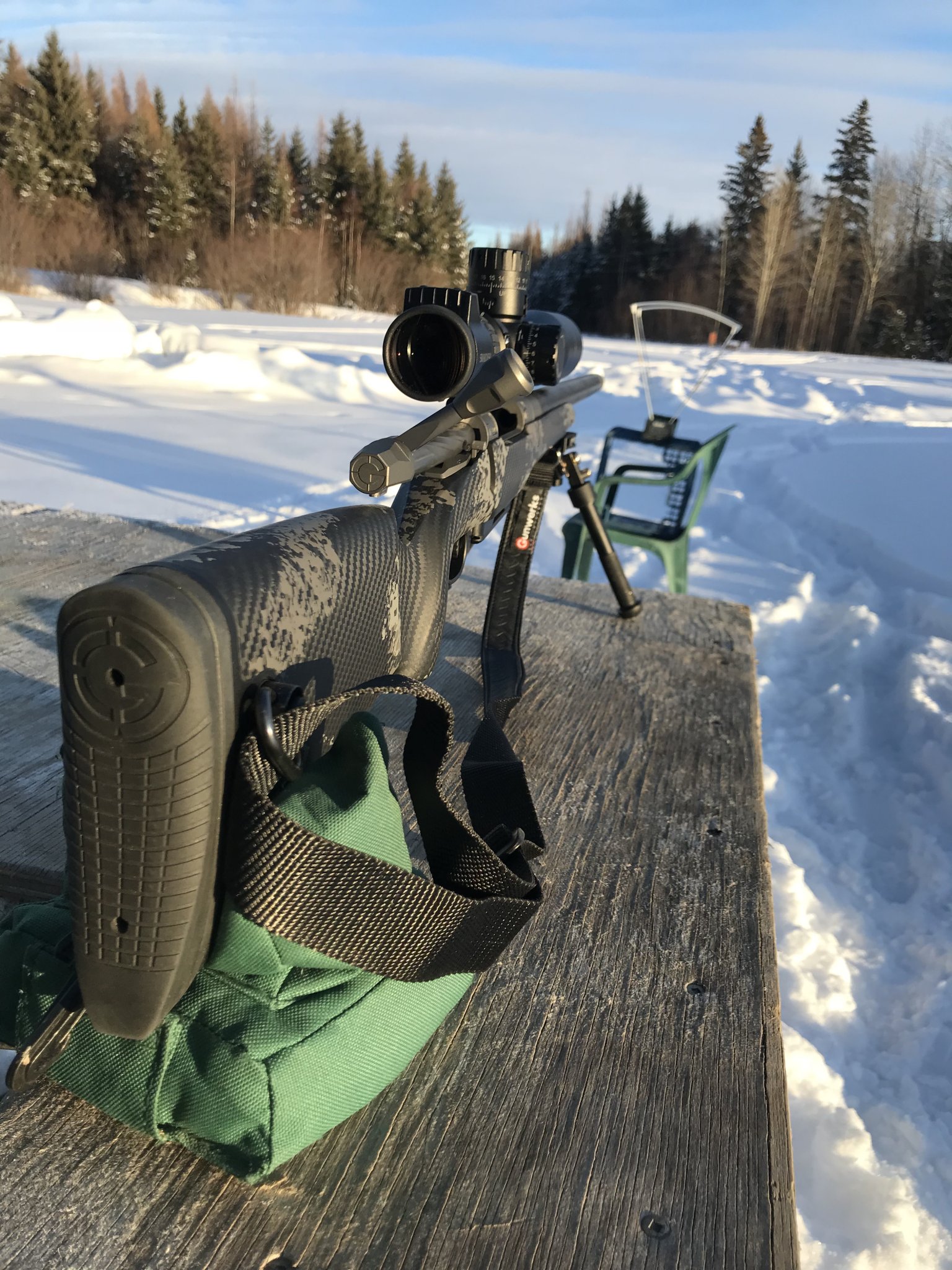

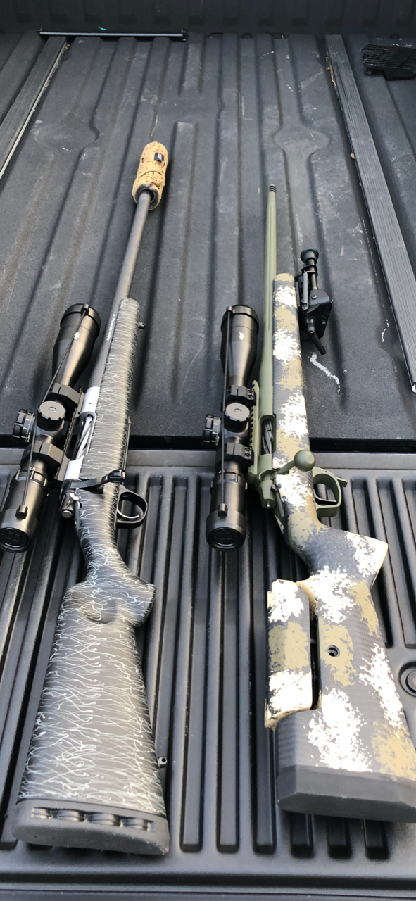

Very similar to mine as well on the right. I started with a GAP Xtreme hunter and changed the stock and action so it just became a base custom. The rifle as pictured is 9.8lbs with no mag. I took it on a horseback hunt in northern BC and my only complaint is the riffle wouldn't fit in the scabbard with the mag so I had to keep it out and in my pack which was frustrating when you had to hop off and grab your gun in a hurry.
I have a 15 day backpack hunt for sheep scheduled and want to build a true light weight pack rifle. Have looked at the Gunwerks Clymr or the Proof Glacier and am curious how much cheaper I can build one for and keep it under 6lbs. Hard to beat either of those two from what I have read though.
