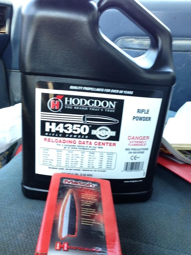

    I finally found some yesterday and am at the range doing load testing.
    I've just begun and bug holes, I can finally say bug holes!
    Glad I bought more than a pound.

    I'll post pics in a bit but a rough ladder from 41.6 to 43.2 and Hornady 140BTHP's gave me a low of.053 and a high of .239 for 3 shot groups.
    Easily 1/2 of any other powder I've tried.
    I'm goin to try to 44 as my 43.2 primers looked primo and maybe find a high node.
    42 gave me the .053 and I'll explore that a bit obviously with some higher count groups and get some chrony #'s, after shooting that I'm surprised I kept the last groups good as I was giggling like a lil schoolgirl.
