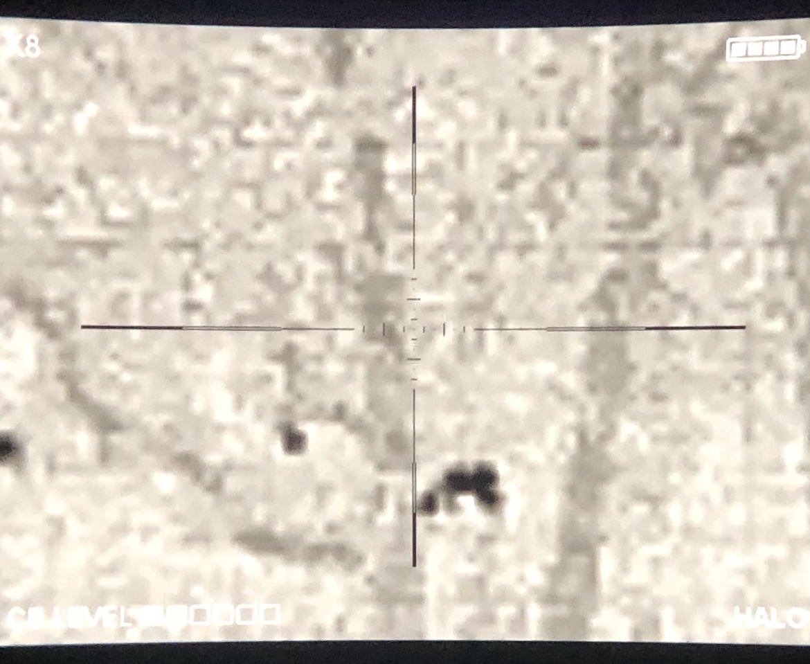

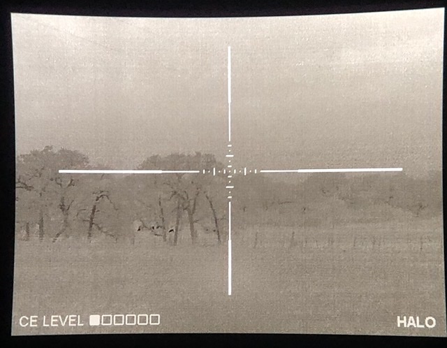

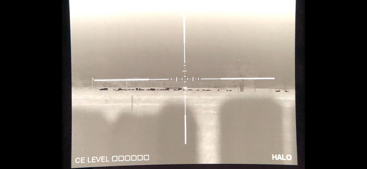

Zoomed all the way out, pic taken with an iphone. Cows on the left are at around 500, right side cows are further out, bridge in the back is right at 1033. Hard to explain, but it's clearer in person.
Overall I'm happy with the optical performance, this thing SHINES at shooting pigs from 20 to 200 yards. When the wind is right I can get to around 50 yards before I light them up and it's a bad day to be a pig. I hunt on foot in alot of river bottoms and wooded area between pastures and it really excels at operating in a cluttered environment. If I was out west coyote hunting I think I'd opt for the LR, but for my use jacking with pigs its pretty damn awesome. The five year warranty and cost are what really pushed me to the 25mm, I'll try and update as I keep rolling along and the conditions in Texas get more humid.

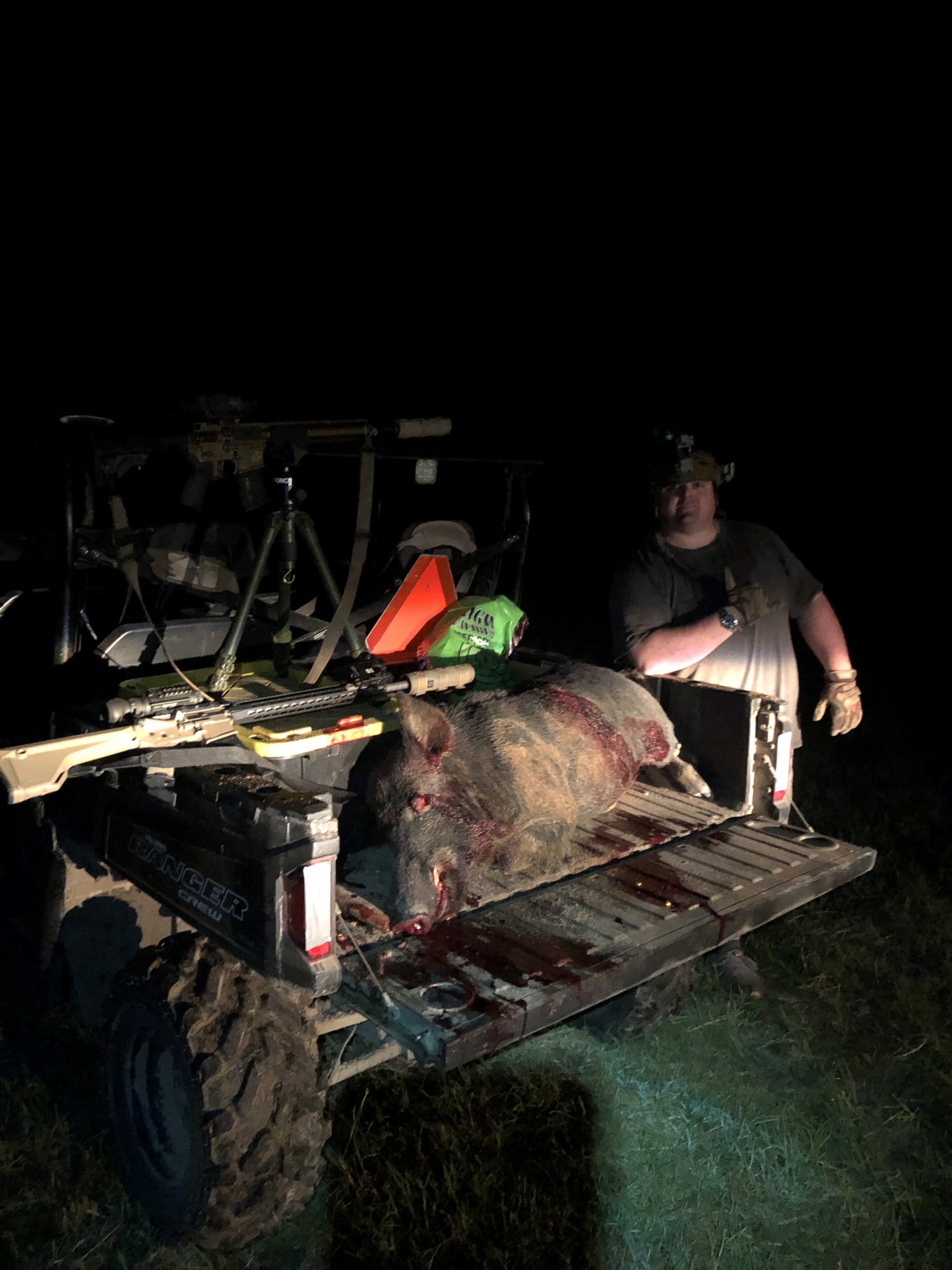

Pretty good run tonight, wound up with 7 dead on the spot and 3 that were leaking bad and running on two wheels. Need to get a dvr pack, took these pictures after I was done for the evening. Deer at 400ish

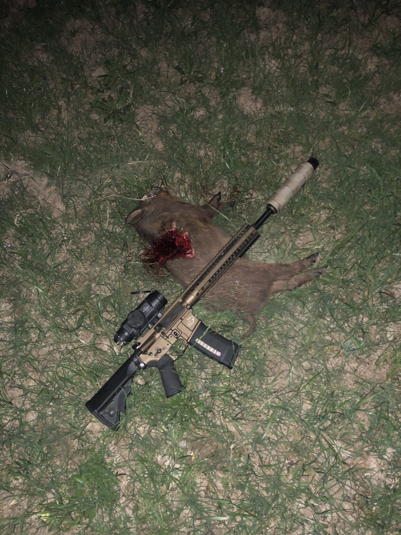

3 down this evening. We need a good rain to get them out of the river bottoms. Halo worked great tonight and I was able to make short work of the pigs despite them being really close each time I got into them, one was killed less than 30 yards from where I set up. Zero issues with identifying anything this evening and didn’t have any false stalks

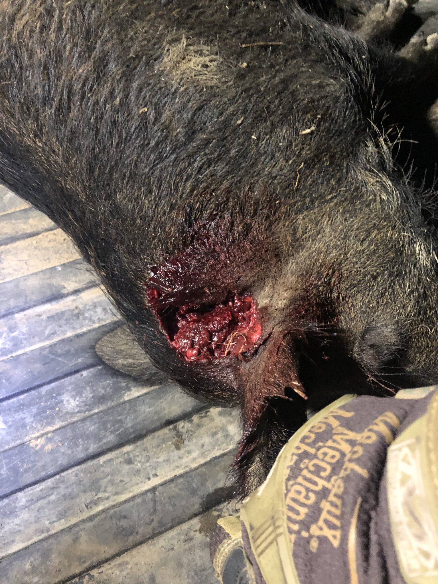

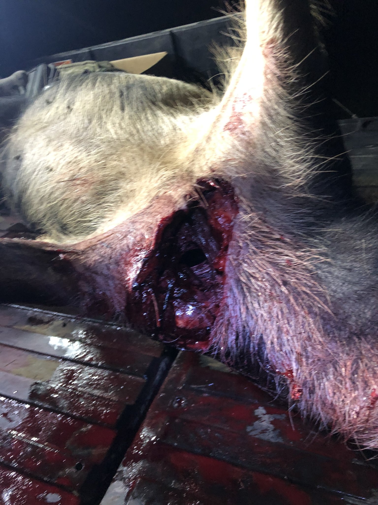

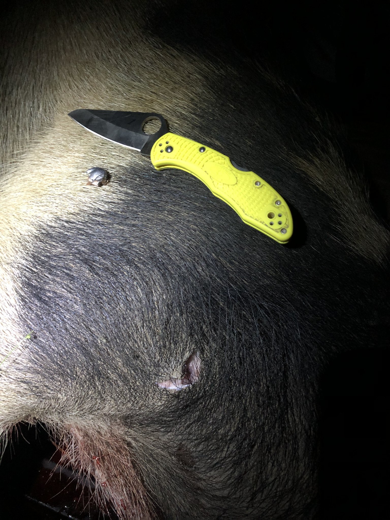

Did manage to recover a bullet from one of the pigs, first time I’ve recovered one of the S&B 110gr pts bullets. It looks like it shed a lot of weight, I’m not totally surprised, with the ranges all sub 75 yards tonight I figured the round was going to hand grenade. I’ll keep running them for the time being, but when ammo supply catches up I’ll give the bonded 90gr a try. I’ll weigh it tomorrow.
Hunted in less than optimal conditions tonight. 92% humidity, 54°F and intermittent rain. Detection range was 8-900 yards, but IDing wasn’t for sure until around 300 or so. I didn’t false stalk up any cows, but I spent more time looking at stuff and trying to decide what it was for sure. It all fairness I did still manage to kill 3 pigs and I think any unit would have had a hard time in those conditions.
Zero is holding perfectly, big bore was shot from 150 and impact was just behind the ear as intended. Overall I’m satisfied with how the optic did in shitty conditions, going to be interesting to see how it does this summer in the God awful humidity.

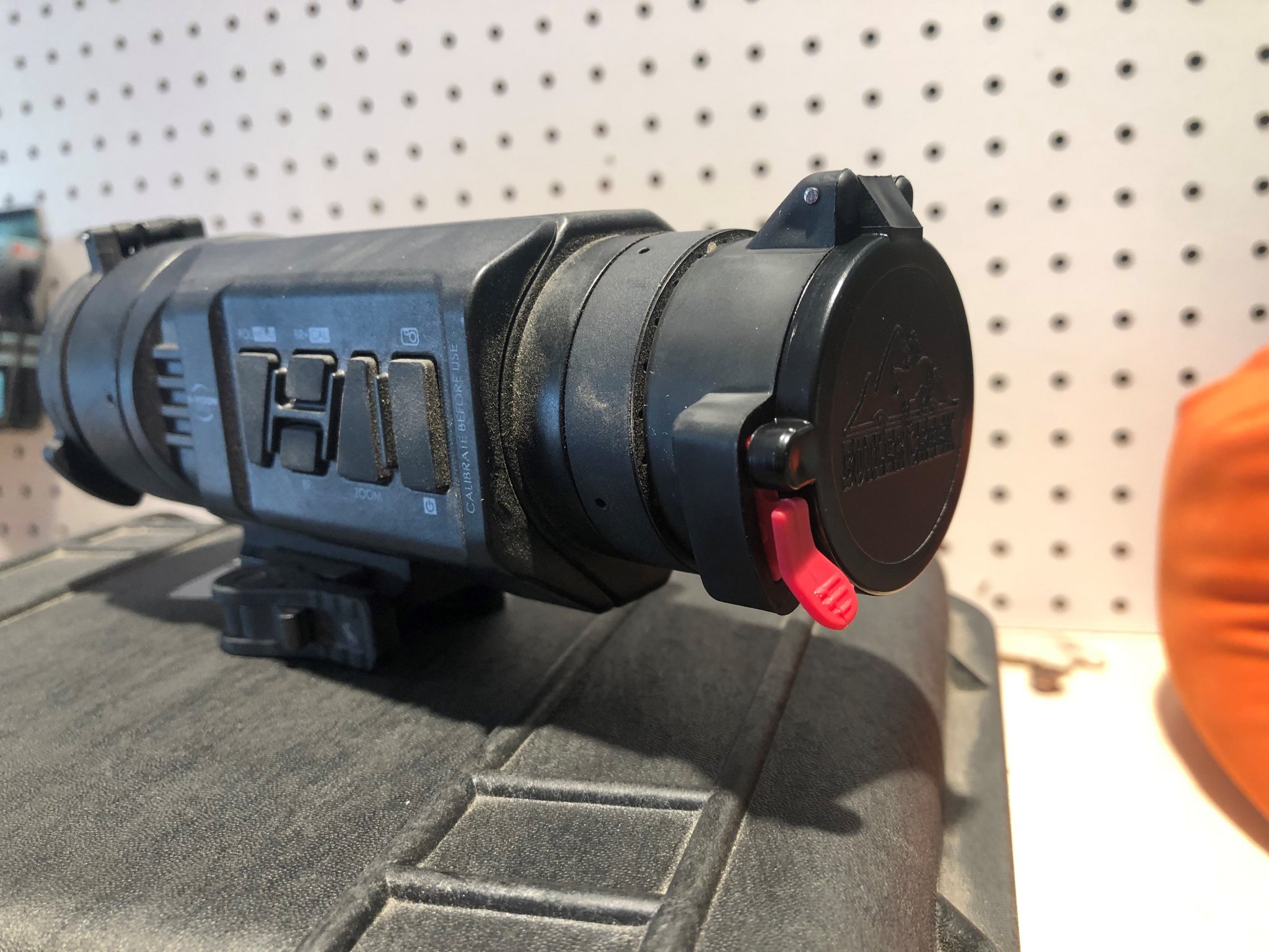

Only thing I've changed is I added a Butler Creek flip cap (#16) to the rear. The places I hunt are pretty dusty and I was getting tired of blowing crap out of there with a can of air.

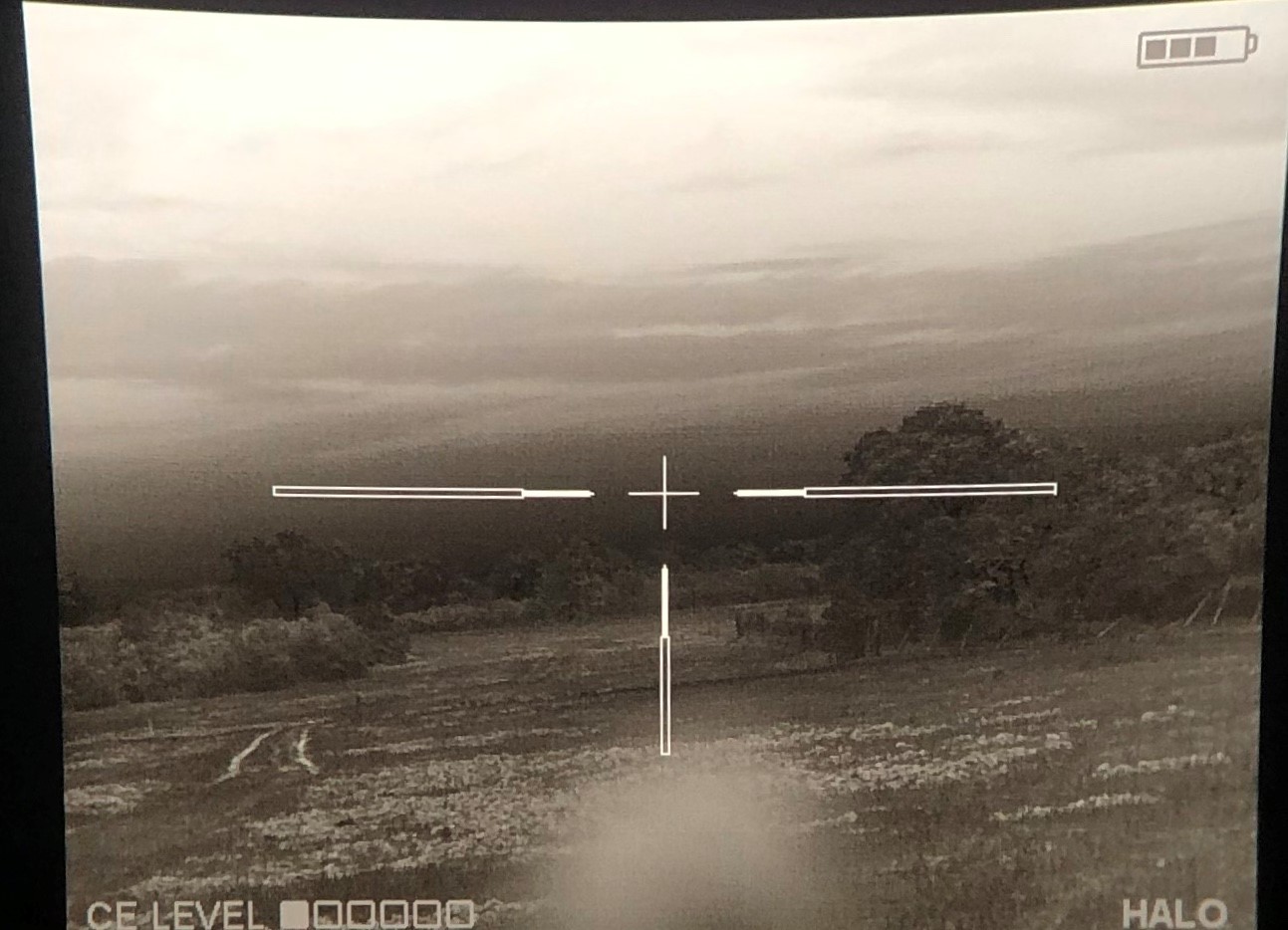

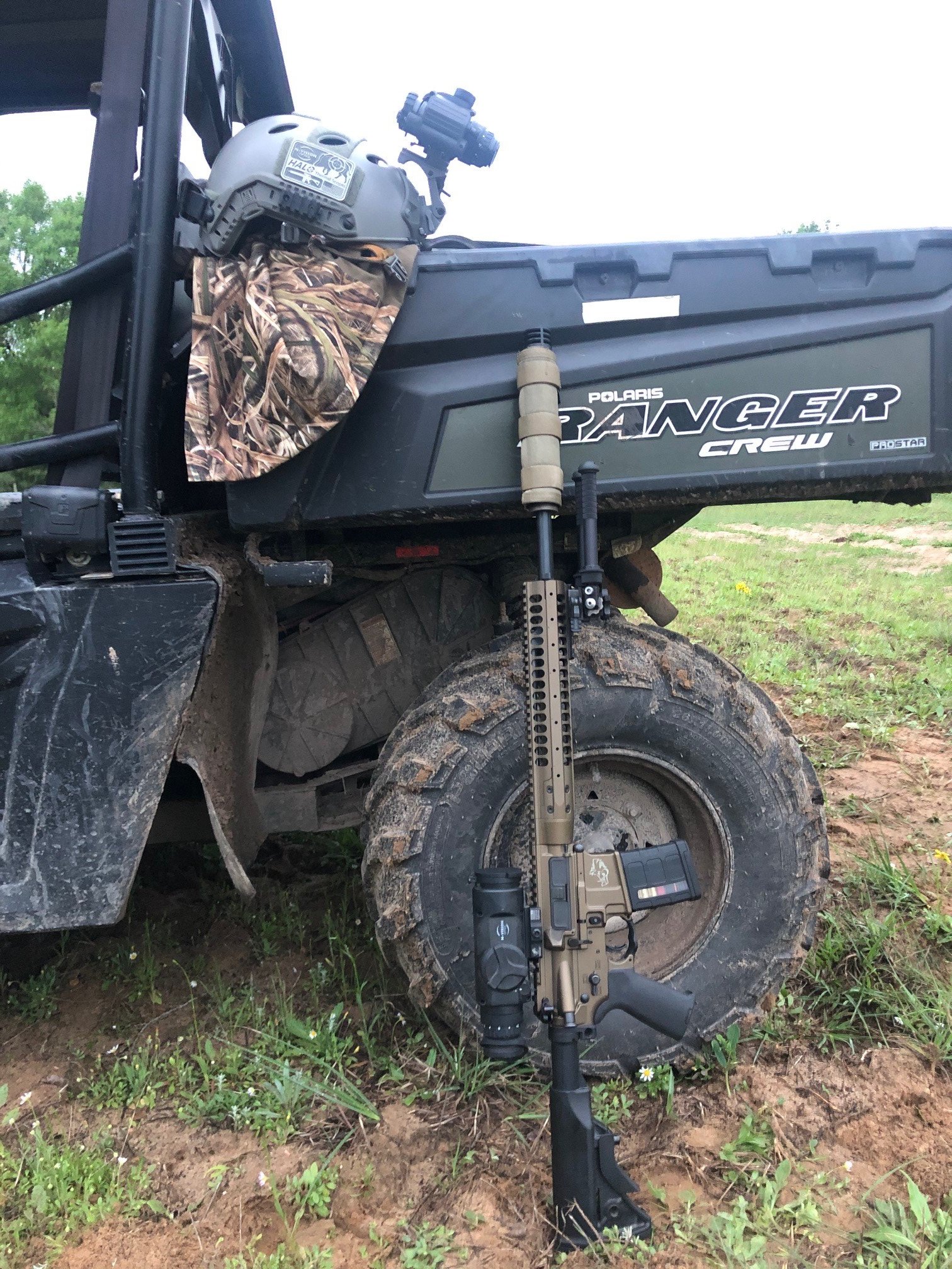

Had the rifle up on the tripod last night and got this pic. Fence on the right ends at 375 and the tree line beyond it are at 600, ranged using the white trash raptar (look through the pvs 14 while walking the ir laser from the sig range finder onto what I want to range and then look in the eye piece of range finder and see what the range is)

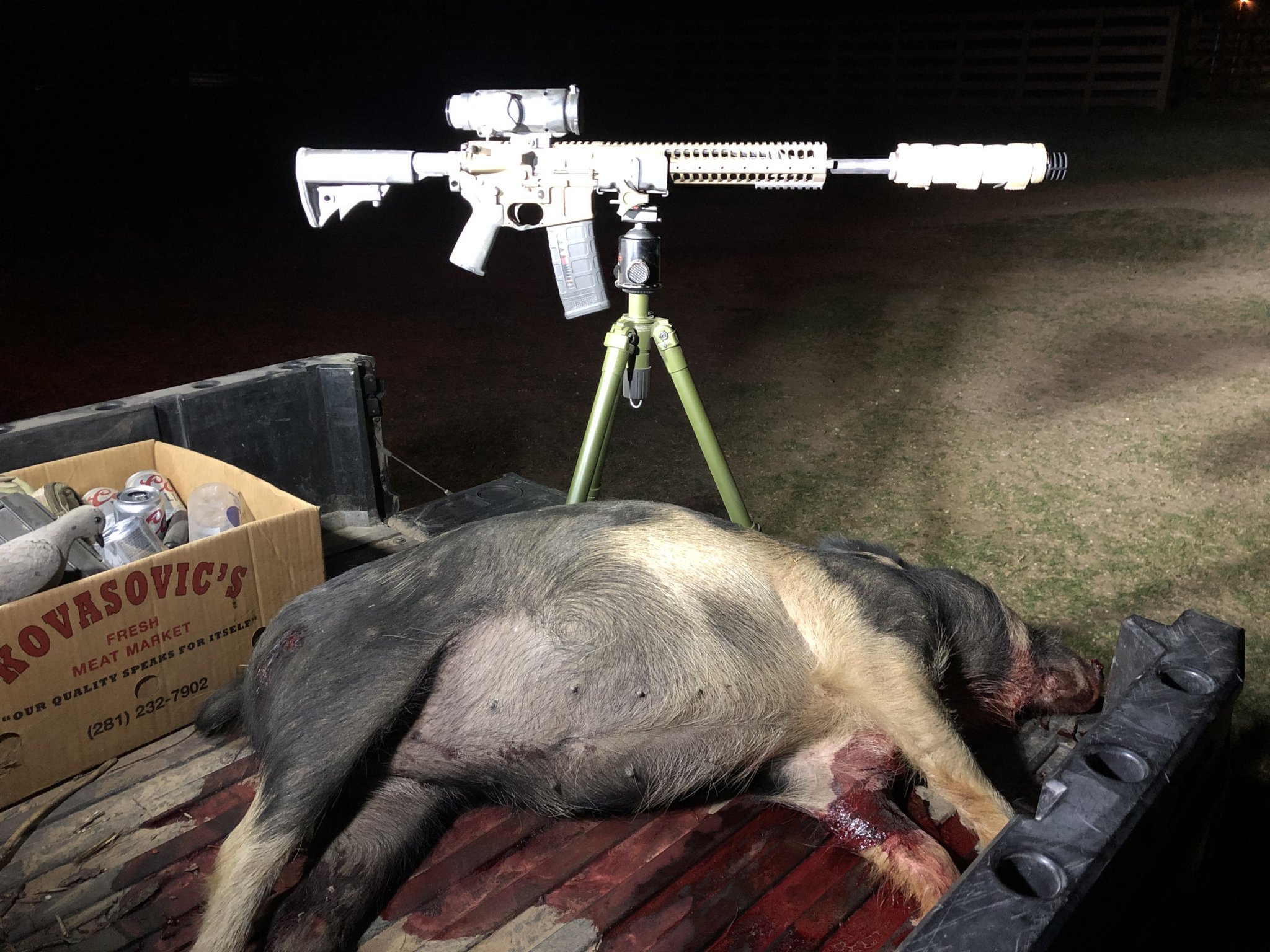

Still smashing on them with the halo. Hunted right after a thunderstorm last night and the conditions weren’t optional, but the optic performed well. First group we spotted was at about 400 yards down a hill. We got to within 150 and a big bolt of lightening illuminated everything around us. I don’t know if the pigs saw us or the lightening spooked them, but my partner and I decided we had better go ahead and send it because they all perked up and we’re looking our direction. We did the old 3,2,1 and started shooting. When the dust settled we were shooting cleanup and I was able to shoot one right in the melon from 205 off of the the pig saddle.
I’m still super impressed with the 25mm, shooting runners is where this thing really shines. When we were shooting clean up I increased the magnification to one notch bellow max and anchored the pigs. Had one false stalk last night on a lone calf wayyyyyy out in the middle of a hay patch. Spotted the calf at 8-900 yards, drove to within 400 and closed to 250 on foot before it was absolutely clear it was a calf. It was about a 50 pound calf bedded down in tall grass by itself, oh well I could use the walking.
The butler creek cap on the back was awesome for keeping crap out and cutting down on light when moving around.

View attachment 7283097 Zoomed all the way out, pic taken with an iphone. Cows on the left are at around 500, right side cows are further out, bridge in the back is right at 1033. Hard to explain, but it's clearer in person.

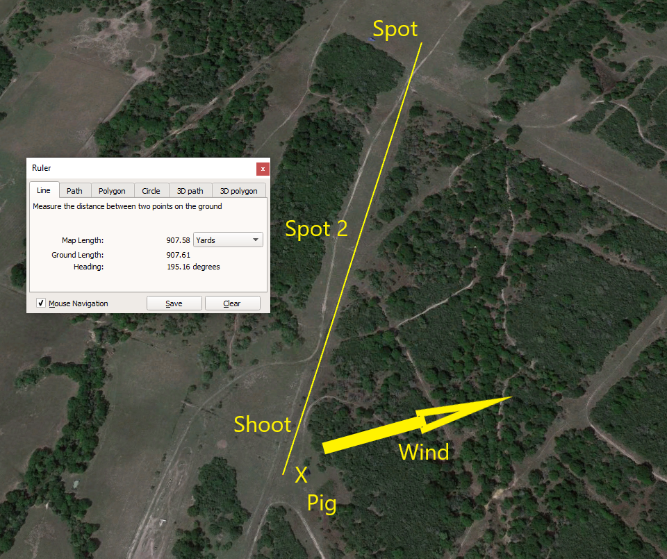

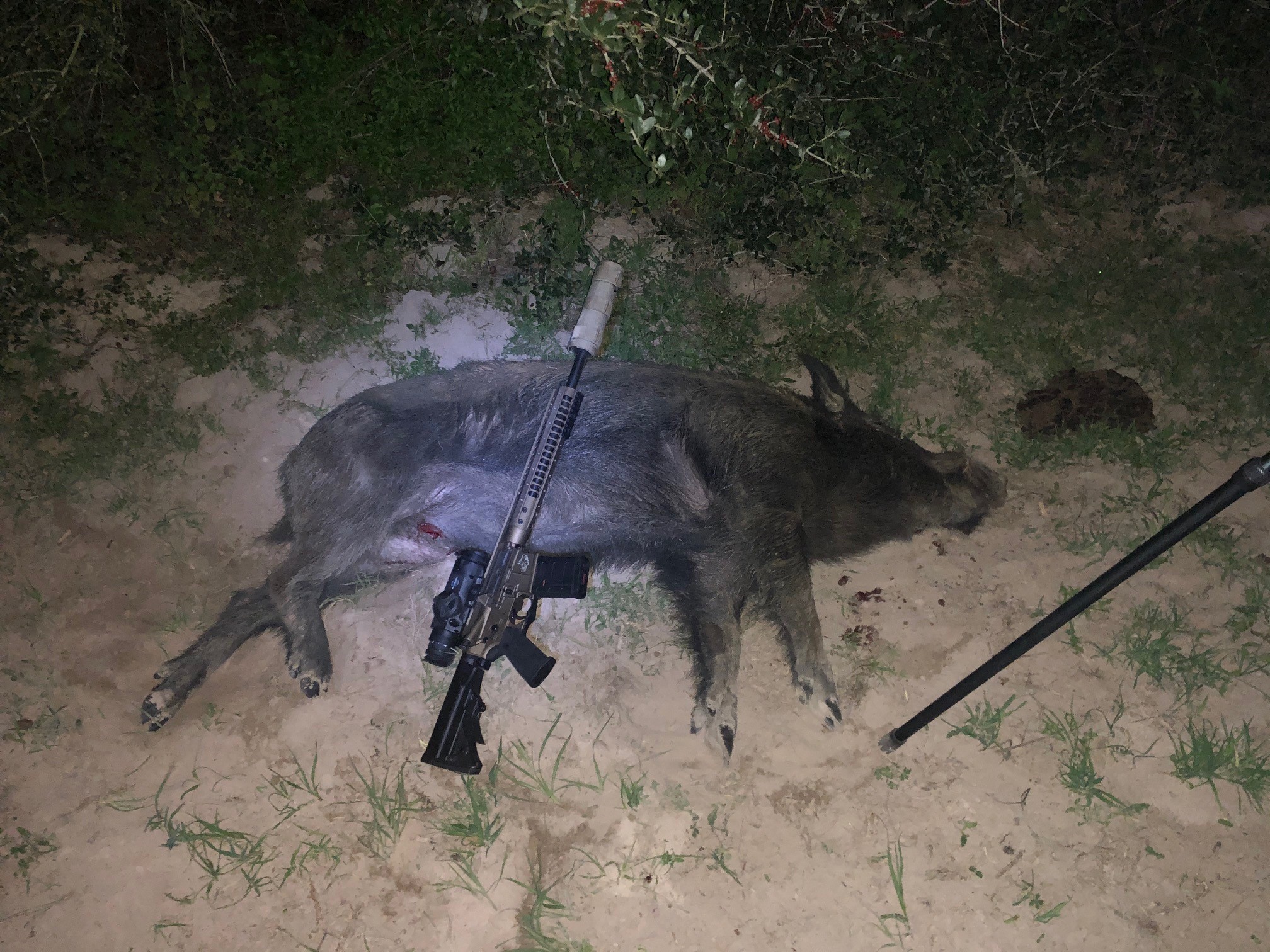

Last night was the best conditions I've had the unit out in to date. 55 degrees and 41% humidity, felt like I could see forever and a day. First pig was spotted at around 900. At that distance I couldn't positively identify it, but watching how it moved, how low it was to the ground and that it was by itself made me pretty sure it was a large lone boar. We walked down from the hill and at the second little rise in the ROW stopped and took another look. At 400 it was pretty clear that it was a big lone boar. The wind was in our favor so we closed on foot as close as we could and made it to 50 yards or so.
Exhibit A:
So were set up on tripods, both shooting 6.8 and I'm thinking were about to bang flop this pig hard.....wronggggg.
Pig is perfectly sideways, I'm holding eye socket and I count down. 3,2,1 and we both open up and Mr. Pig runs straight at us while eating a truck load of rounds. When he falls, he's 20 yards from us. My fist rounds went through both his eyes and did not really do much else, my partners shot was too high on the shoulder and just left a nasty wound above the spine. As he was running towards me I went semi auto cyclic tagging him in the chest and that was a wrap. All in all pretty fun, but mad stupid....moral of the story: don't be cute and aim for the neck or skull like normal. Do I think the pig was charging us? Not really. I think he was blind, pissed off, running from the loudest sound (rounds impacting him) and he just happened to pick our direction to run.
The halo keeps trucking along, the low base magnification is super useful for how we are hunting, when timing is right I'll pick up another form the wife. I really think had I been using the LR or another optic with higher base magnification, shooting that pig as it ran at us would have been tricky. My partner was shooting a Flir PTS233 and it was equally good for the shots we took up close last night and general detection duty, but lacking in longer rang IDing. I think that having one really dope thermal and another serviceable thermal is another really good option for deciding on a second unit for a wife/kid/buddy/freeloadingassholeswhodontbuytheirownshitbutpayforbeer.

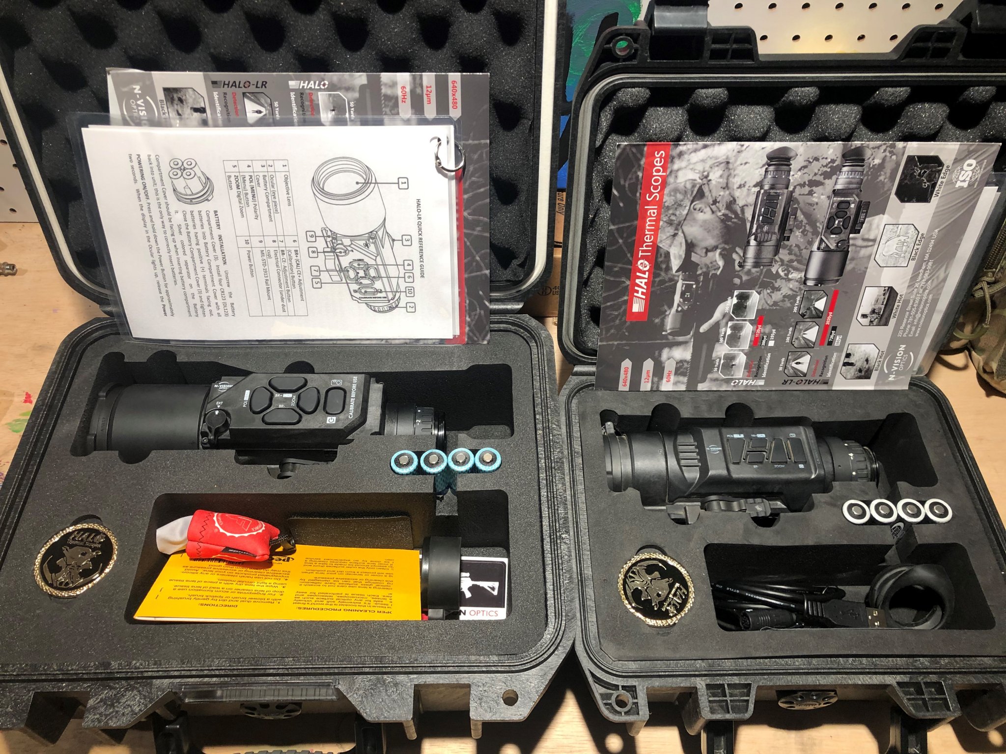

Well boys, the 25 has been a ball of fun, but time to play with the LR. Got some new property to hunt that is a turf farm and the shots can get stupid long. I was going to keep running the 25, but I have some work coming up in West, Texas this month and we have access to some large ranches out there that are ate up with yotes....everything is pointing to taking longer and longer shots so time to change up the gear a bit. So long 25, been a great unit, wouldn't hesitate to pick up another some day.

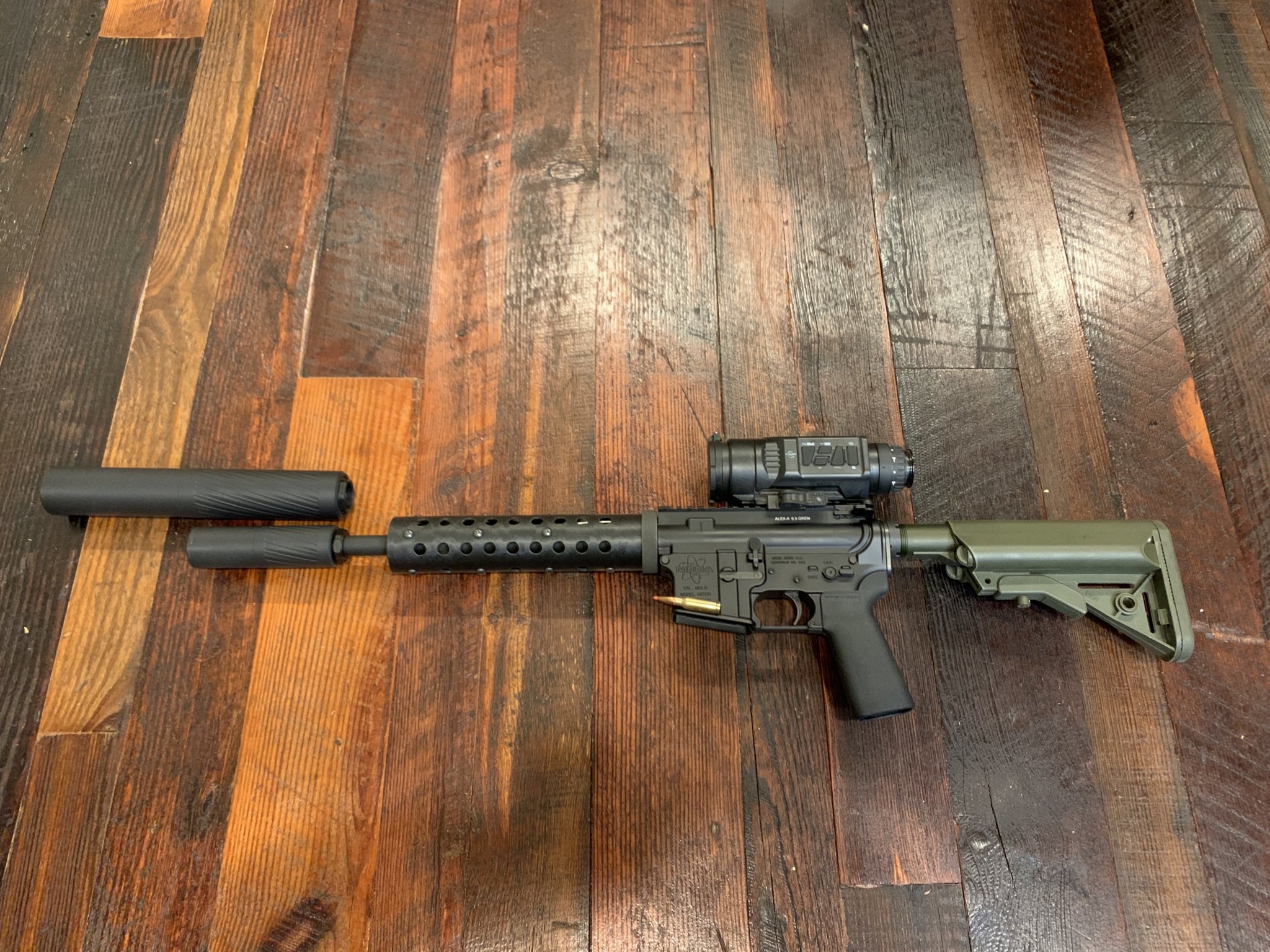

With the Ultra 5 and 10rnd mag it’s a light/nimble setup for walking the roads and swamps. The 338 Ultra and 17rnd mag are more cumbersome, but more pleasant to shoot from a blind or stand.

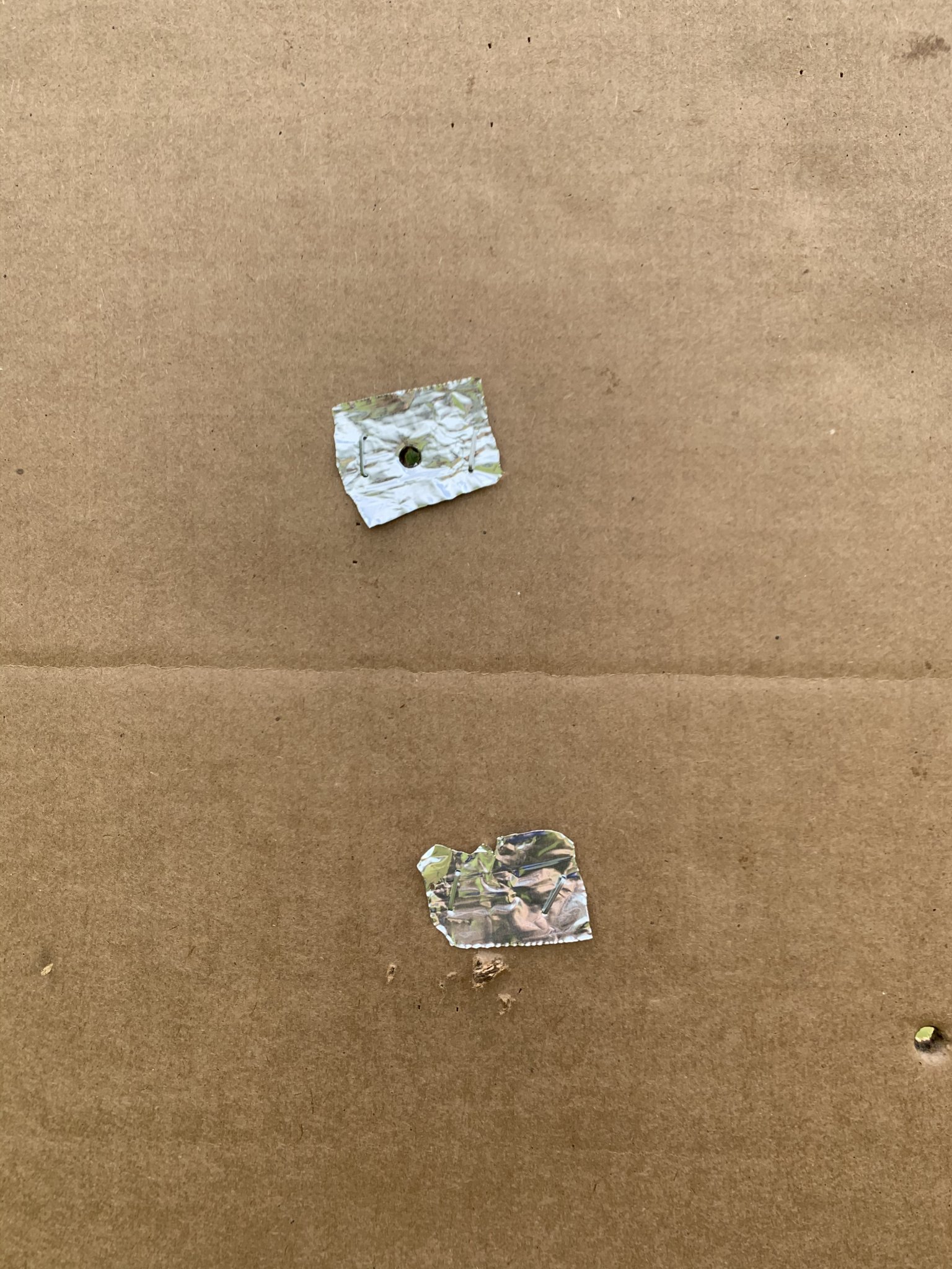

Sighting in: I followed the Lone Star Boars - Huey Outdoors method to sight in. (YouTube) Stapled a small piece of foil to a big piece of cardboard and shot. I hit low right, and covered the hole with another piece of foil. While holding my initial point of aim (top foil) I nuc’d it, then entered zero mode. I moved the crosshairs to the center of the bottom foil (over the bullet hole) and saved it. Aimed at the top foil again and center punched it. The 1 shot Zero claim is accurate...2nd shot to confirm 😉 I swapped cans back and forth a few times and put 5 shots total into a sub 3/4” group.
This was at 35 yards, which according to Ballistic AE puts me 1” high at 100yd, on at 150yd, 1” low at 175yd, 2.5” low at 200yd. I’ll confirm on steel later.
