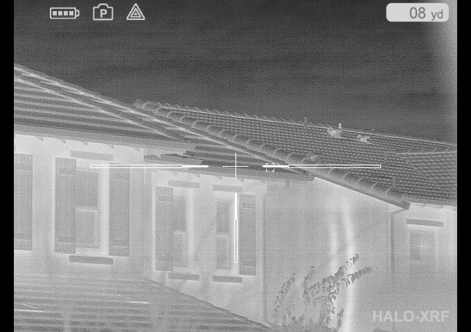

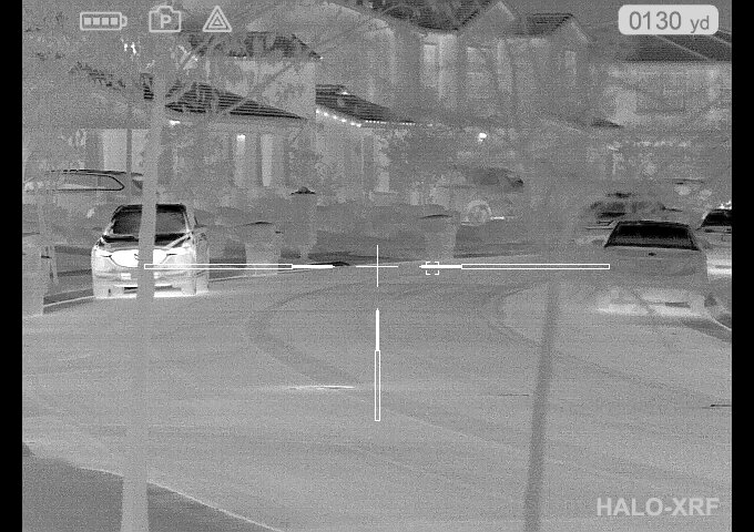

This is what I've seen every night I've been out with it for hours at a time while other units in my group will be working fine right beside it.

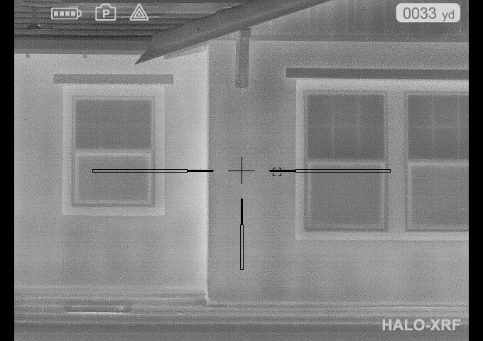

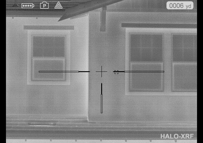

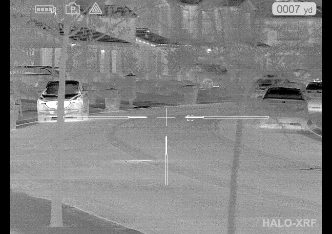

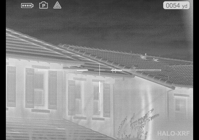

Brand new N-Vision XRF out of the box. LRF simply doesn't work. I also noticed out of the three XRF's I've been through ALL of them have the LRF box in different locations. Seems odd that the box can be located anyplace and not a specific place in every scope.
View attachment 7774101View attachment 7774103View attachment 7774104View attachment 7774106View attachment 7774107View attachment 7774108
Same thing mine was doing before the update. The update didn't improve the functionality, it just changed how the issue is presented.

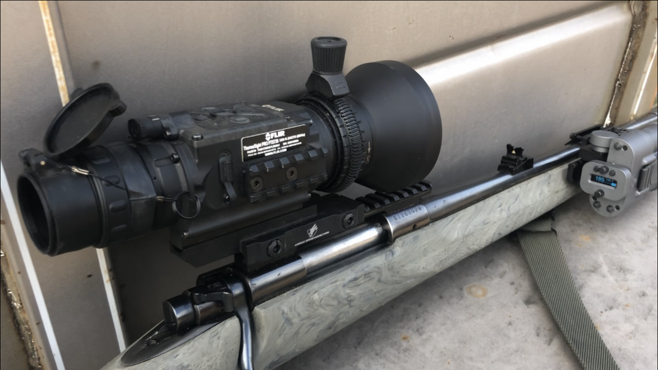

Yep, I just kept it plain and simple for my longer range needs. 270 Win (while an oldie) shoots flat and with authority. So its a Goldie. :)
The PTS 736 at 6x native mag, even at 320 x 256 throws an excellent image and the Radius lets me know how far.
That big ole 75 mm Germanium lens with 12 micron Boson core gathers up a lot of data. :)

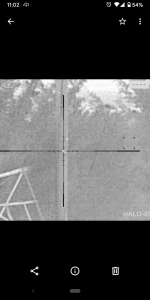

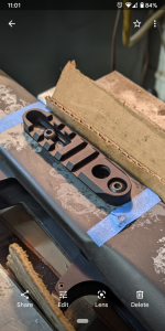

My halo lr had this same issue. Zoom was unusable as it raised the point of impact every time you changed it. I suppose you could measure the change of each magnification and try remember them. Don’t know who would wanna mess with that though

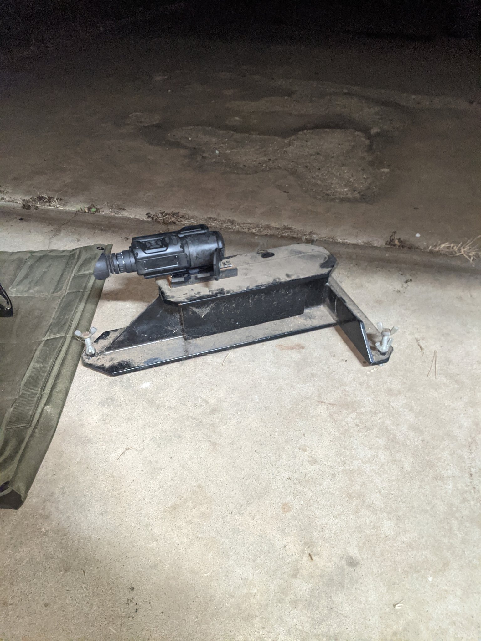

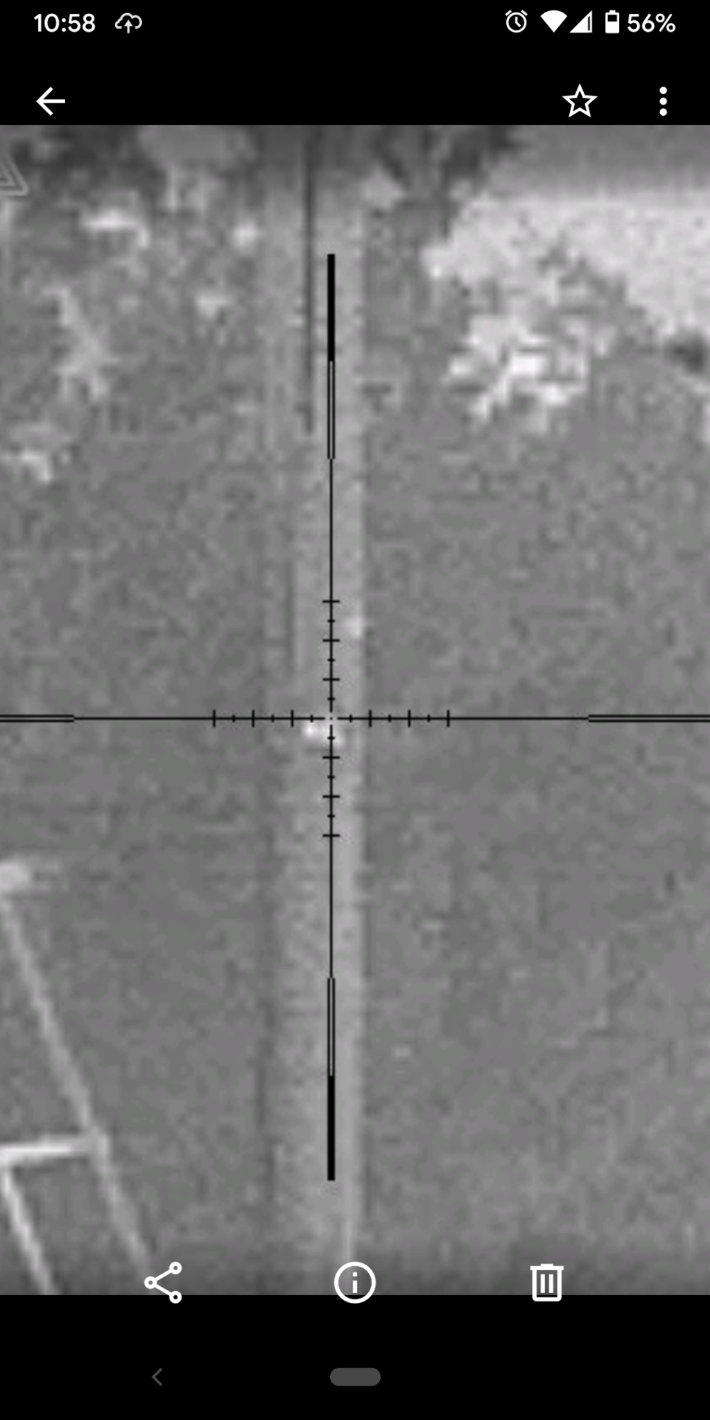

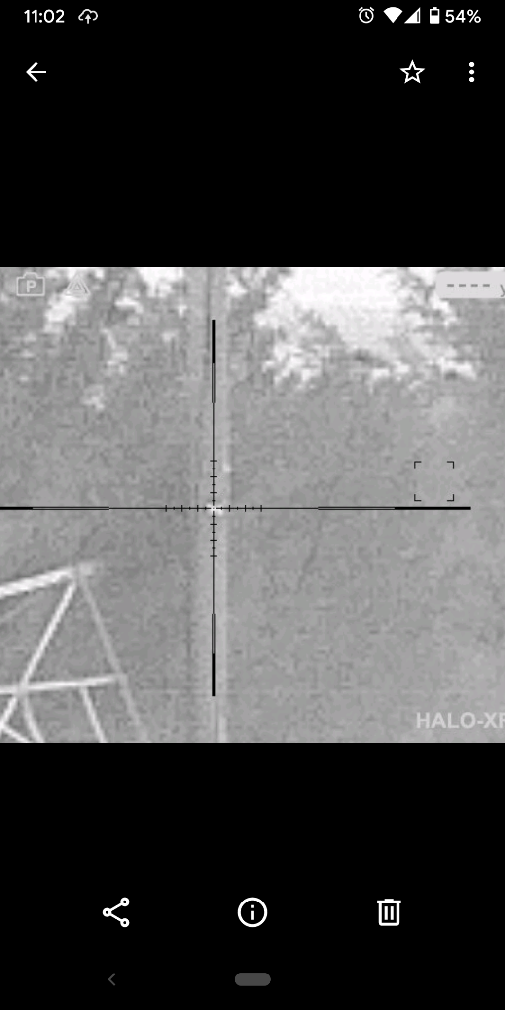

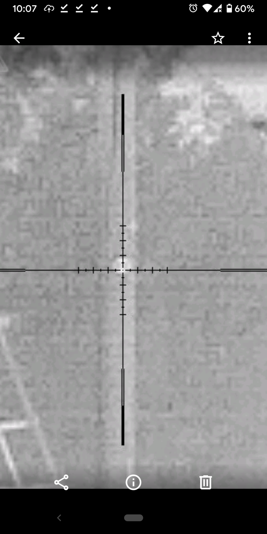

I think you guys cursed me and turned my luck from bad to worse. My zero moved 1.5"@100yds, so now I'm trouble shooting that problem. The reticle definitely "jumps" for a split second with each magnification change, but then it seems to go back to zero each time.
Anyway, I started out by testing the BoBro mounts RTZ on my scope sled. The video is kind of cool if nothing else.
I'm going to let the scope stay in place through a few temp swings and power cycles, then I'll put a day scope on the rifle and check that part.
That problem wasn't hard to duplicate. It was mid 60's when I zero'd a week ago, and about 20* when I rechecked it last night and found the zero had moved low and left.
I captured the first pic after I made the videos. The scope had been outdoors for an hour @40*.
I removed the scope and placed it inside by a heater for 30min to replicate the 60* temp I originally zero'd at. The reticle moved to the bottom of the target when I put it back on the test rig.
I removed it again and placed it in the freezer for 30min. The reticle moved to the top and a little right. Correcting for this shift would push the bullet low-left.
I'm not terribly thrilled to find this, but at least it seems predictable and somewhat minimal. I'd never accept this from a day scope, but I realize there is a lot more at play with thermals. I'll just have to zero in the weather I hunt in.
For reference, my original Pulsar would move 5" for no apparent reason. The Trail 2 replacement held pretty solid.
