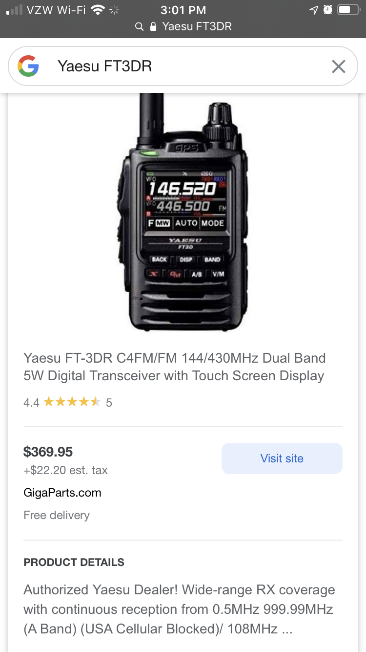

Welp. I went with buy once cry once.
and got the Yeasu FT3 for $380ish
it has GPS and digital capabilities. Picking it up tomorrow.

Are the European radios missing part of the 70cm band we enjoy in the Americas?
