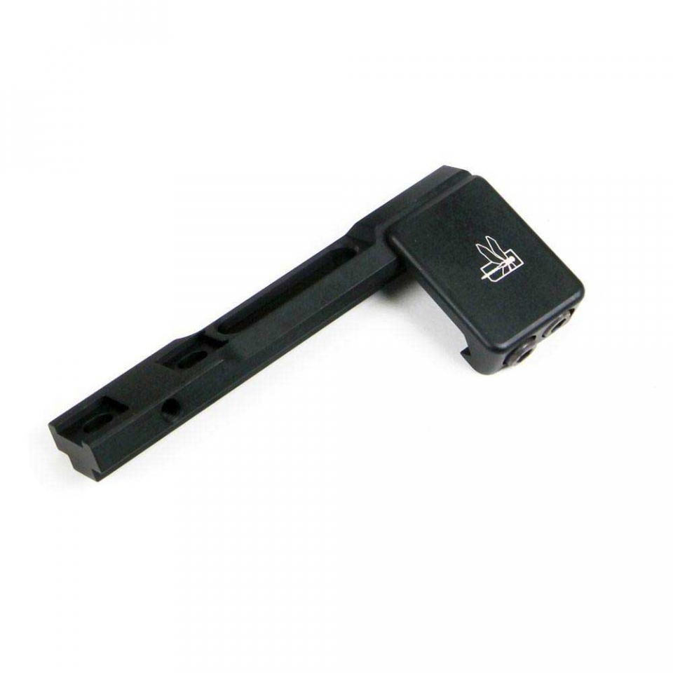

perhaps something like this?
Reactions: TurboTrout

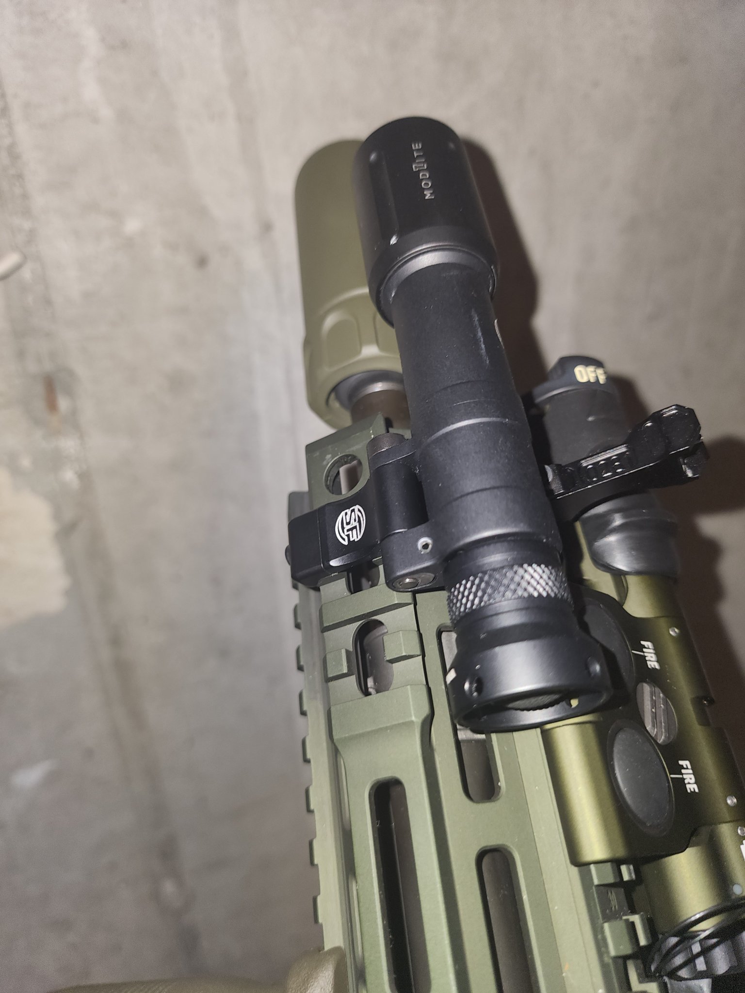

A Surefire Scout picatinny mount would work in that 1-slot, and you can adjust the tension on the mount itself reposition it. It'll work either using the clicky cap for actuation or Ranger band/grip tape/rigger's tape a switch to it using the different Surefire ends. Pickup a Modlite PLHv2 or OKW head and you'd be ready to rock and roll with all the lumens and/or candela you could want.
Edit to add a pic - that is a Surefire scout mount with a 18650 Surefire DualFuel (DF) body, Modlite clicky and Modlite head
Edit to add a pic - that is a Surefire scout mount with a 18650 Surefire DualFuel (DF) body, Modlite clicky and Modlite headView attachment 7935489
