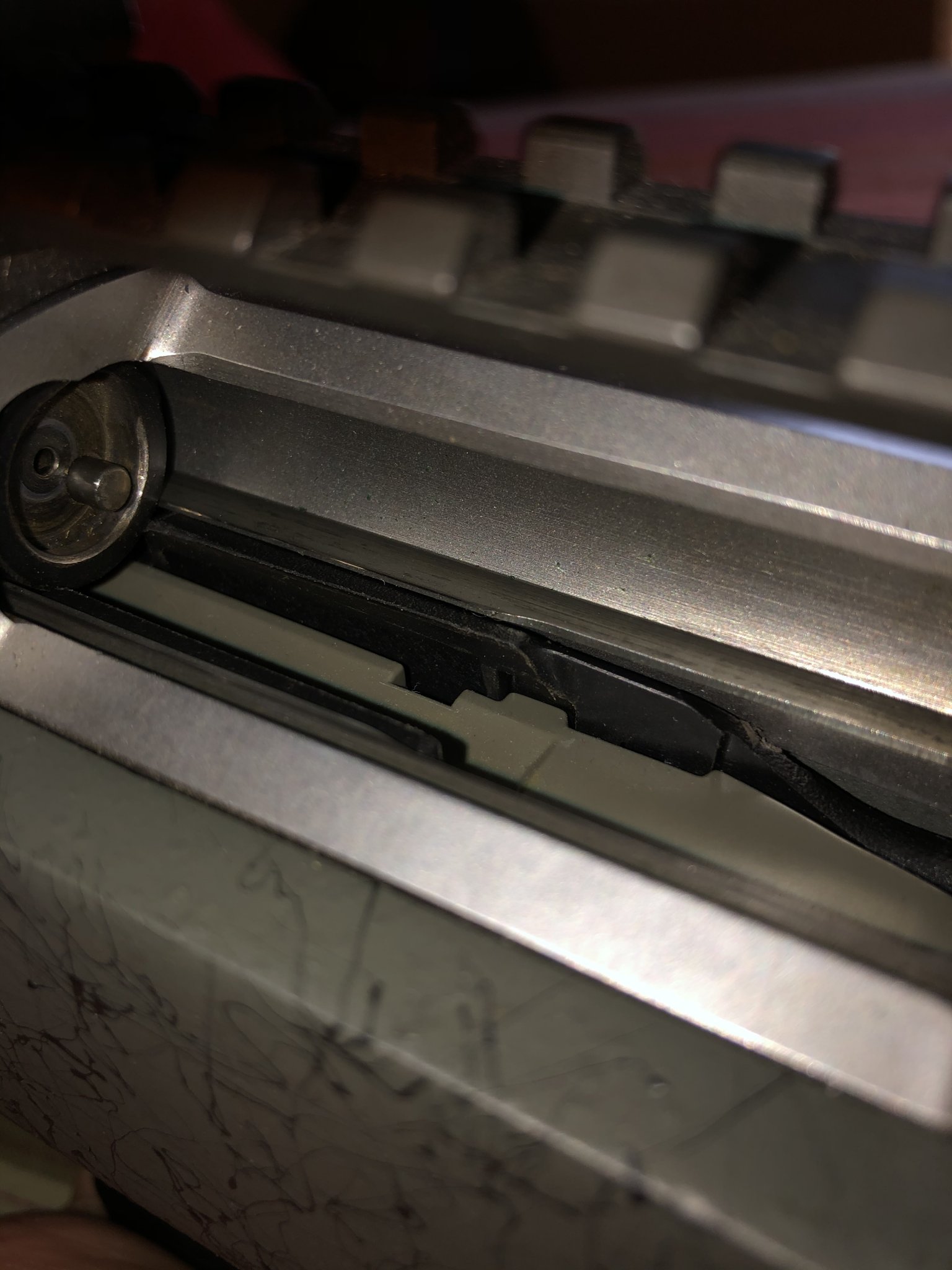

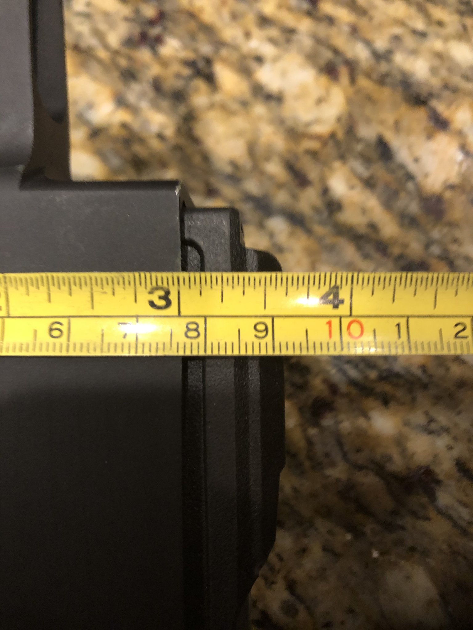

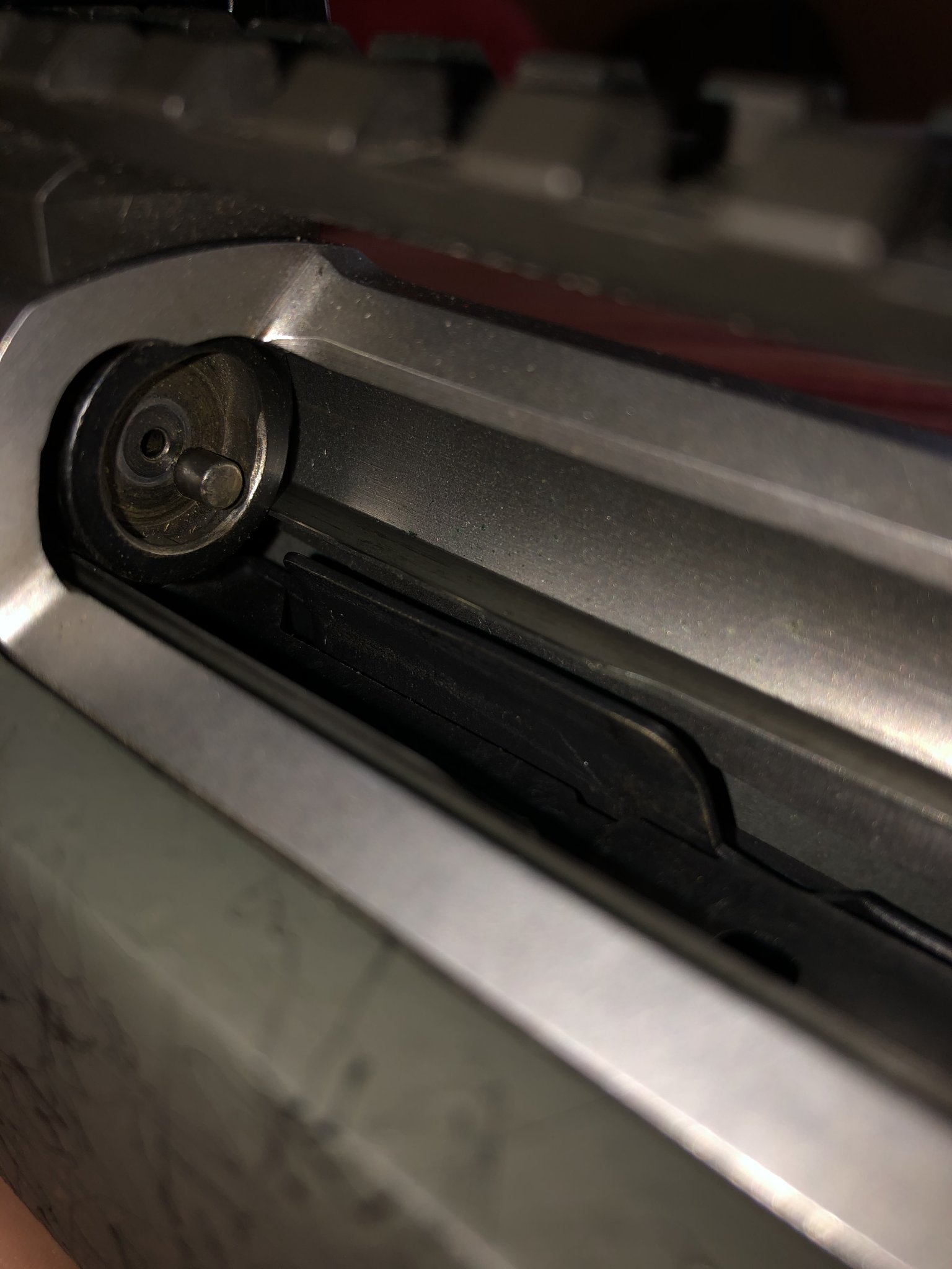

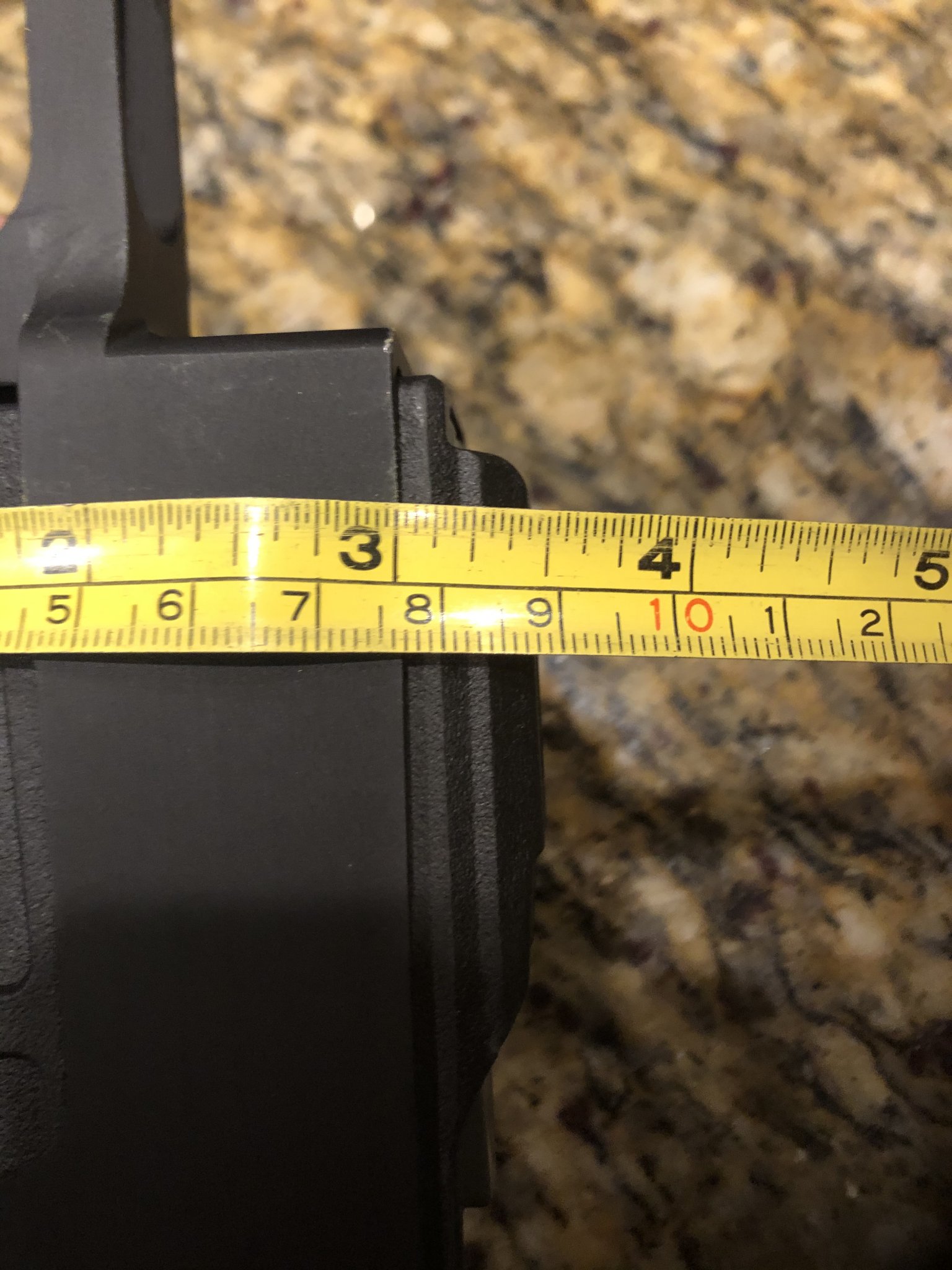

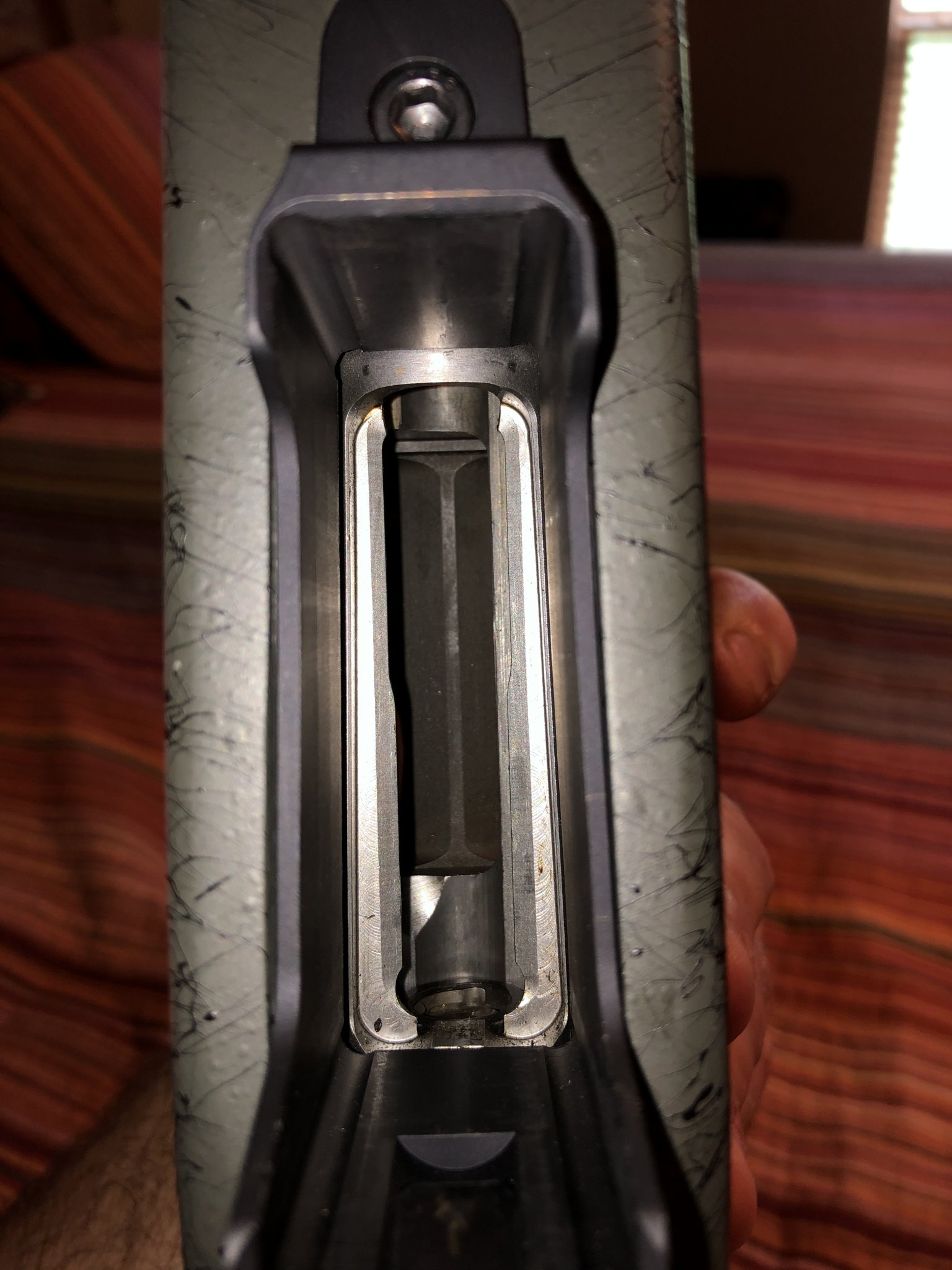

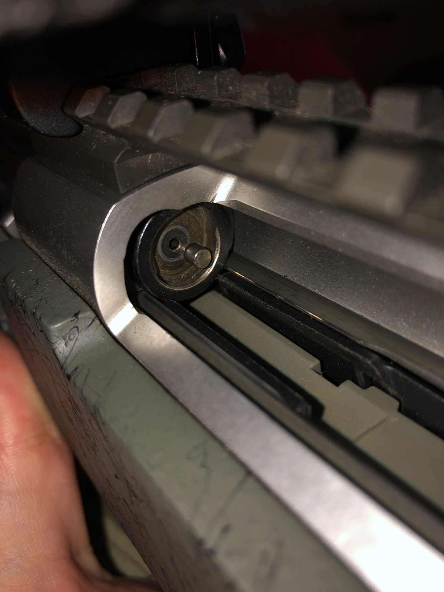

edit: i have a an extra DBM and took some photos with the mag resting on the latch and pushed up. The action in relation to the mag at rest determines if it feeds well. Too low and the bolt rides over. Too high and it can bind. The action itself limits upwards movement of the mag. I did have a pmag left and used it in the photos.

Here are some shitty photos. With a pmag installed and with an AI installed in a remington 700. The ai mag never touches the bolt. Wont even rub it. The pmags feedlips wont when suspended like @WATERWALKER explained but absolutely will dead stop the bolt with upwards pressure. Very little. The action itself limits upwards travel of the mag. A lower latch would only cause bolt ride over when hanging and would still bind with pressure applied. It would likely be impossible to take off enough material from a pmag and allow it to work with a 700 in all conditions. The feedlips would no longer hold the rounds inside the magazine.
