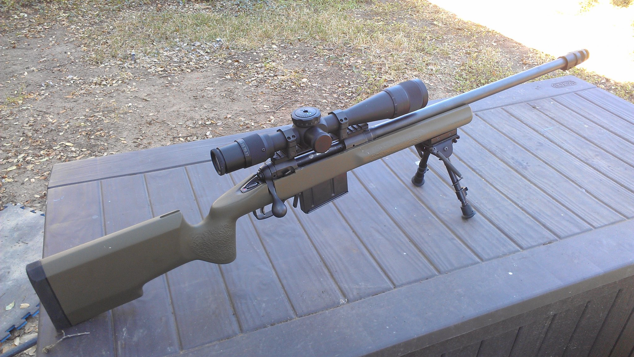

Have any of you ever swapped a .300wm savage over to .300 Norma Mag?
GlockandRoll
Jan 25, 2008
930
117
Austin, TX
I really want to extend the capabilities of trusty .300wm and rebarrel it with a proof .300 norma bbl in and start shooting it suppressed.
Have any of you done this with a savage before?
It's CDI bottom metal for AI pattern mags.
I'm assuming the only thing I will need to do is swap the BBL and bolt face, correct?
Thanks in advance.
