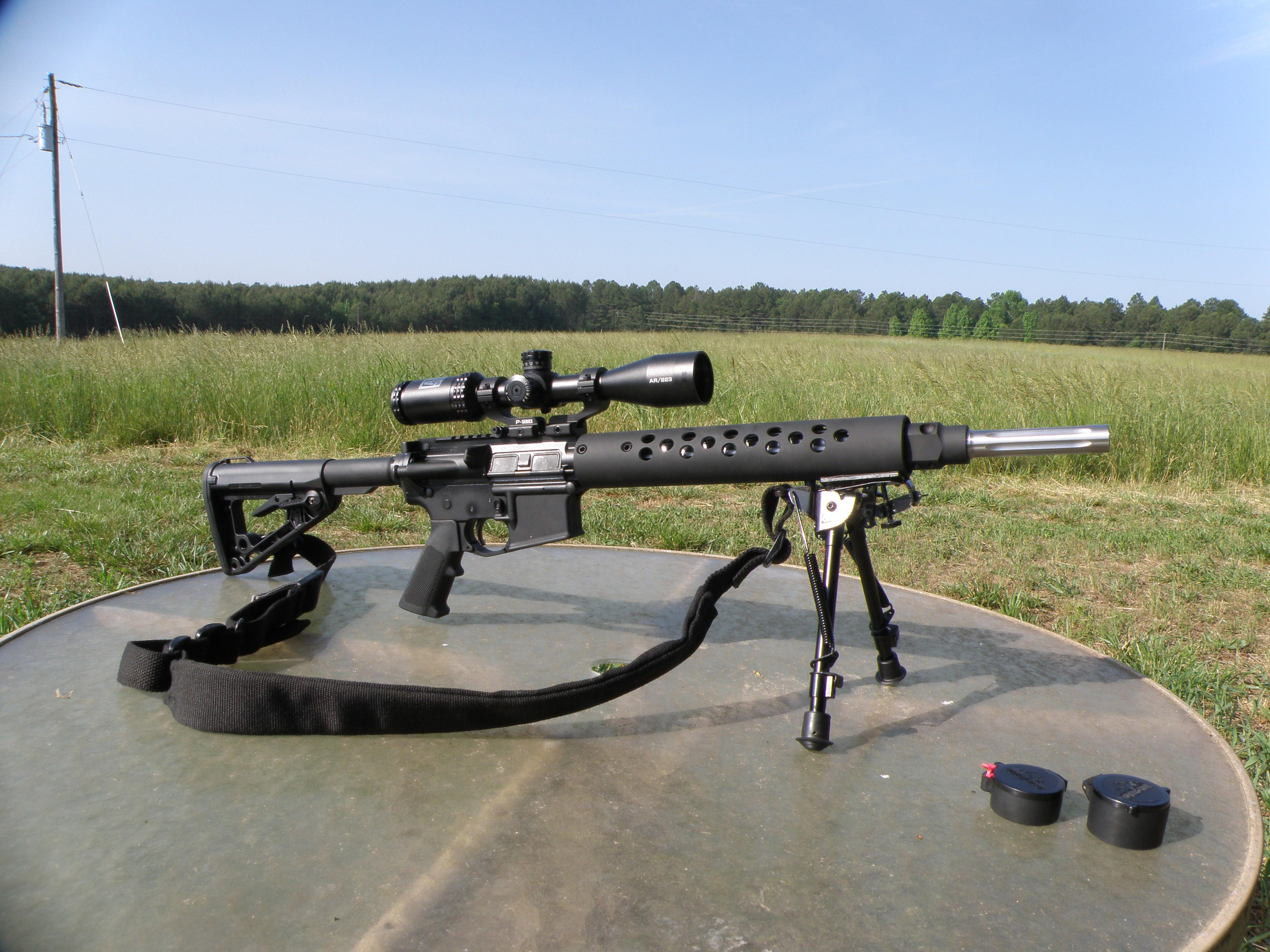

Another thing to consider with the WOA 18" Fluted varmint upper is perfectly balanced right in front of the magazine well as you see it in the picture. It is also very accurate.
