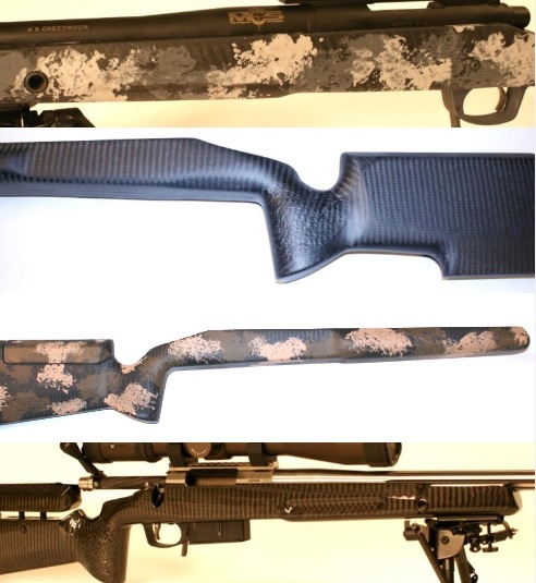

In case you haven't seen them yet this would make a great combo with the new Manners Carbon fiber stocks
