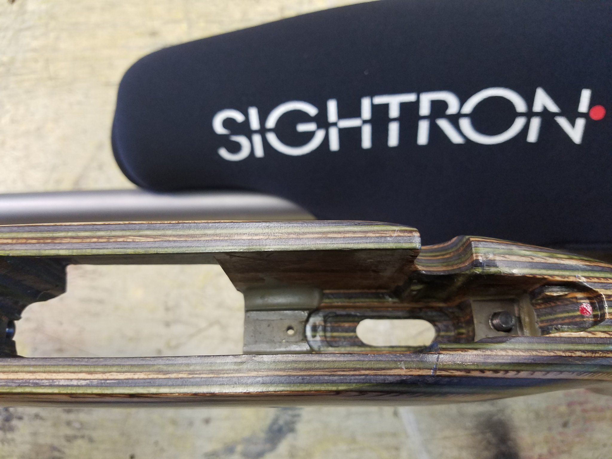

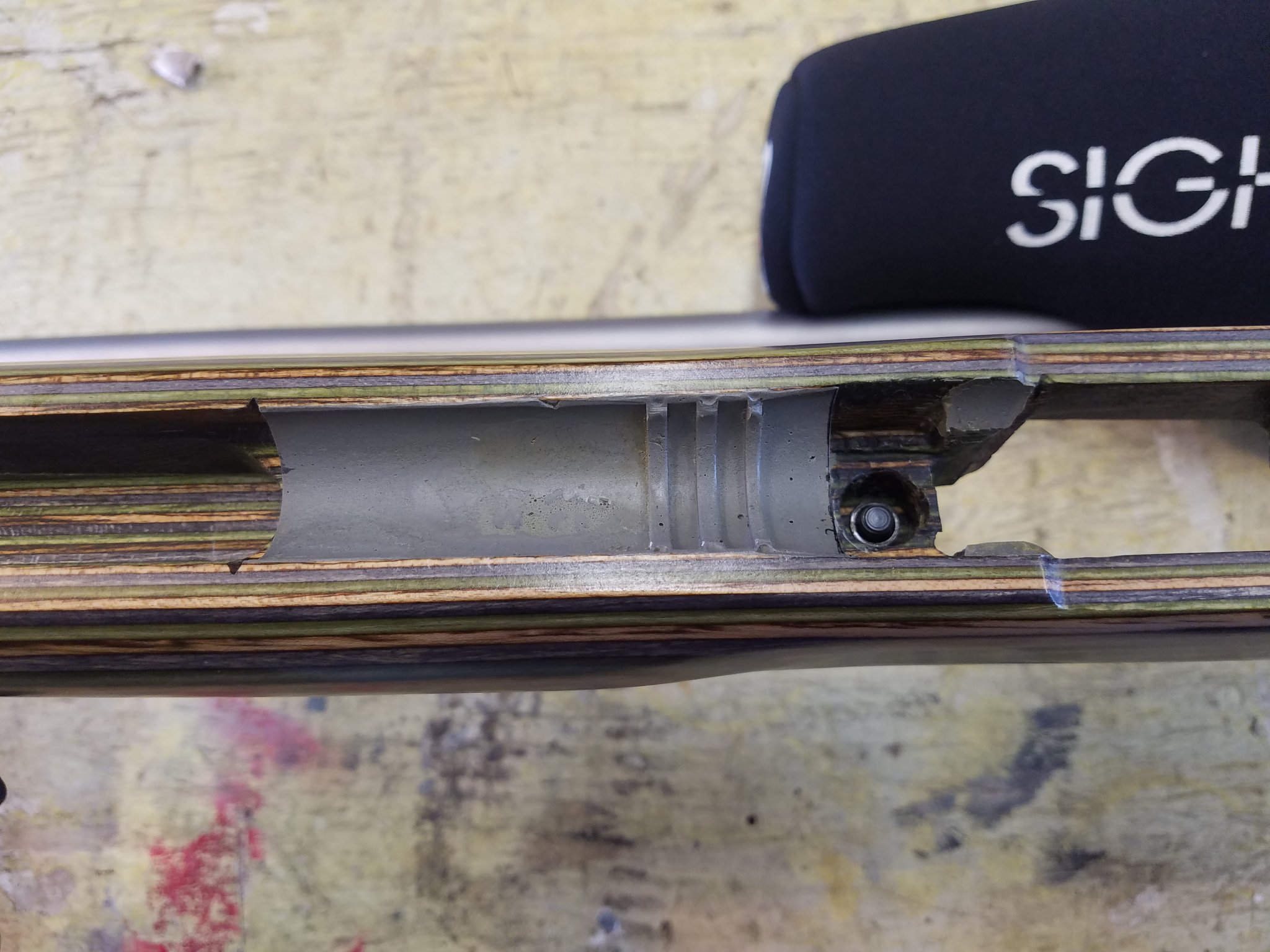

The torque on your action screws make a world of difference if u have a Boyd’s stock because if u look at the stock without the action and barrel in it you can see where the barrel rests on two posts right in front of the mag well if u have it too tight they will hug them posts too tight and cause bad harmonics even if you’ve glass bedded it in my experience mine shoots good and I didn’t bed my Boyd’s stock i shoot half inch groups at 100 yds

If I take it out of the stock for cleaning today, I'll get a picture but when I bedded mine into the Boyds stock I bedded the rear tang, trigger assembly, rear post, ront post and couple inches of barrel. I may have even did the sides. I'll just get a pic loaded up later today. I do remember it didn't come apart real easy and I almost left it glued together. If I remember correct I use something like 18 in/lbs.

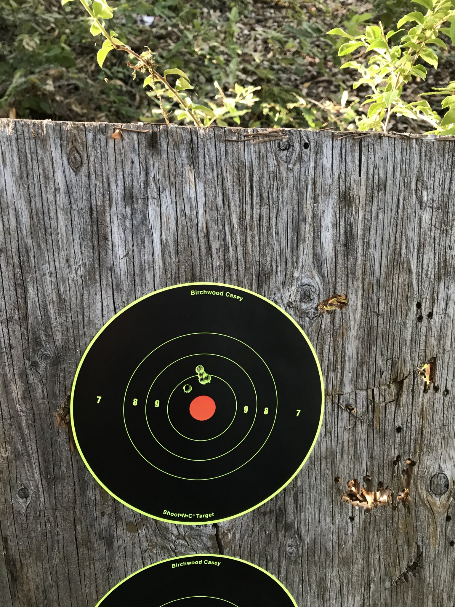

Yeah you want it to be about 15 or so right before it starts to get actually tight this is the group I got 10 minutes ago today at 50 yards 5 shot group with one little flier due to my pull

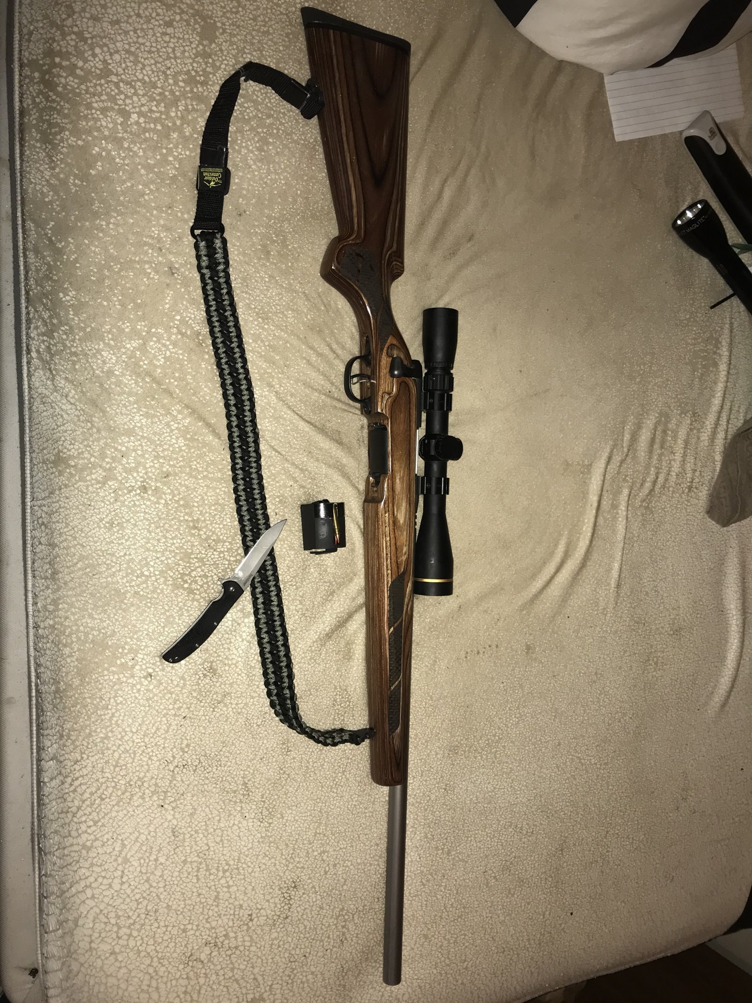

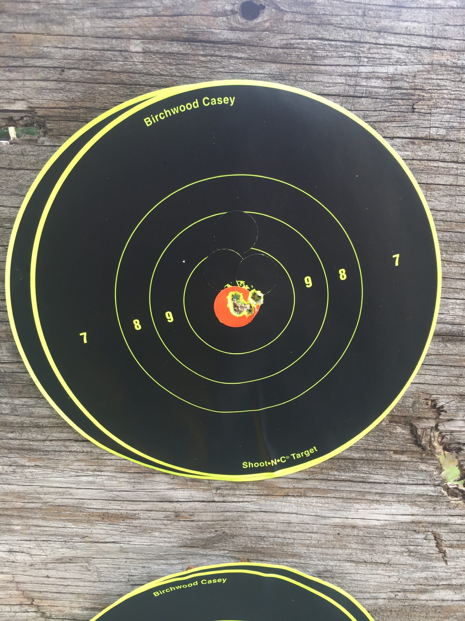

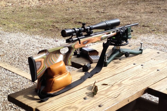

Posting three pics. #1 The rifle. #2 The black/white bull is 5 shots slow fire at 90yds. All in one hole except the last one where the bbl got hot. I think the white ring is 1" in this case and the group well under 1". #3 is three shots at 200y which measure under 1.5". The grid in the pic is 1" squares. I love it. I would call it a 3/4 moa shooter at practical distances if you shoot from a bench/solid rest and have NO WIND, and the bbl is clean. Otherwise you have all of the other Bmag shooters who treat it like a 22lr and wonder why it will not group after shooting 500rd at prairie dogs in a 10mph breeze.

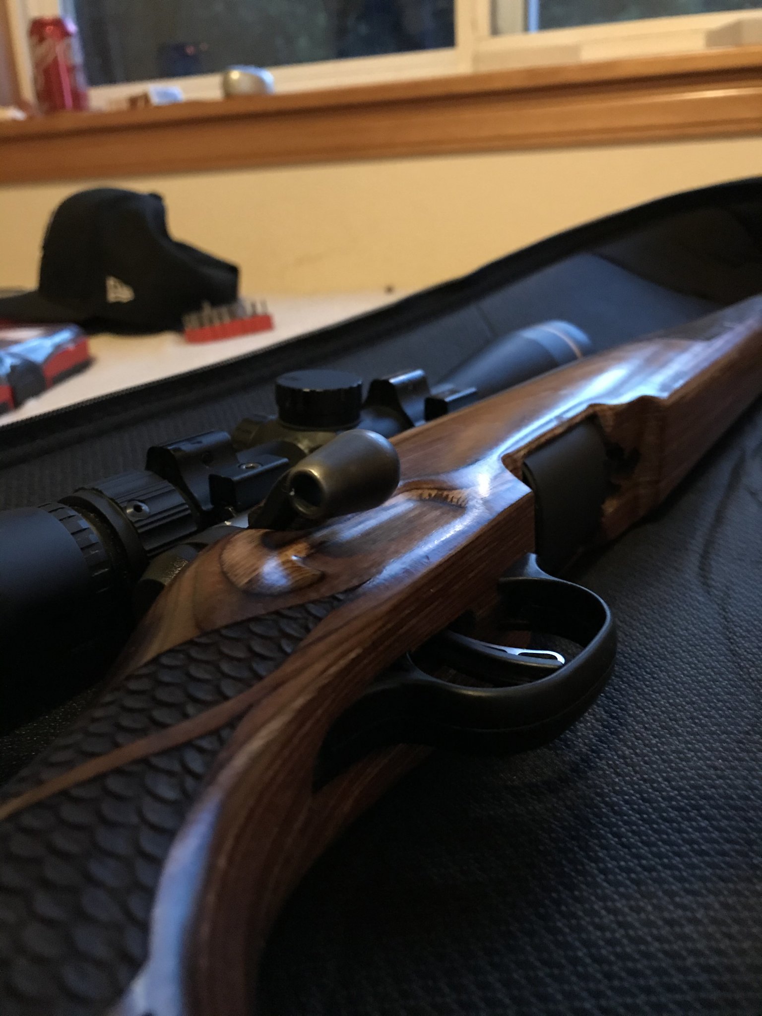

I have been on the fence about bedding it as I have produced some fine groups as is I have also learned that they shoot well when the action screws are set to a low torque like 15 lbs or so here’s a group I shot yesterday with one flier due to my pull 75 yds it was the first shots out of a cold clean barrel I live my bmag I will also post a shot of it tell me how you guys like it or not I put a leupold cz freedom on it do any of you have different points of impact say if you sight your rifle in at thirty mine shoots high at 50 like 2 inches high any info on that???
