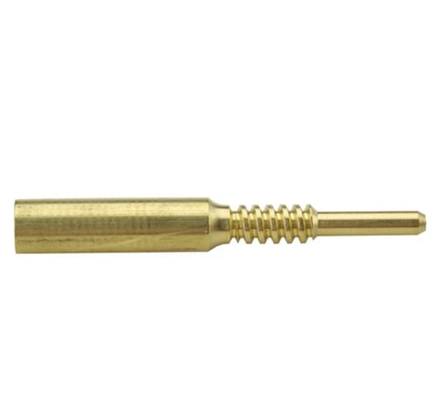

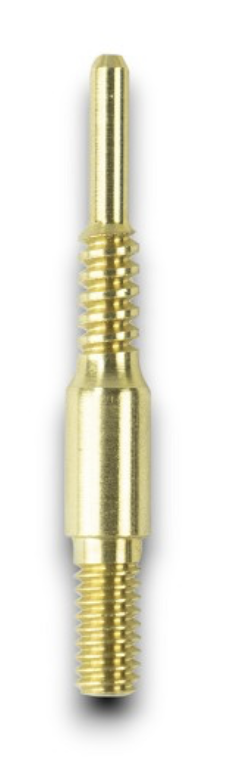

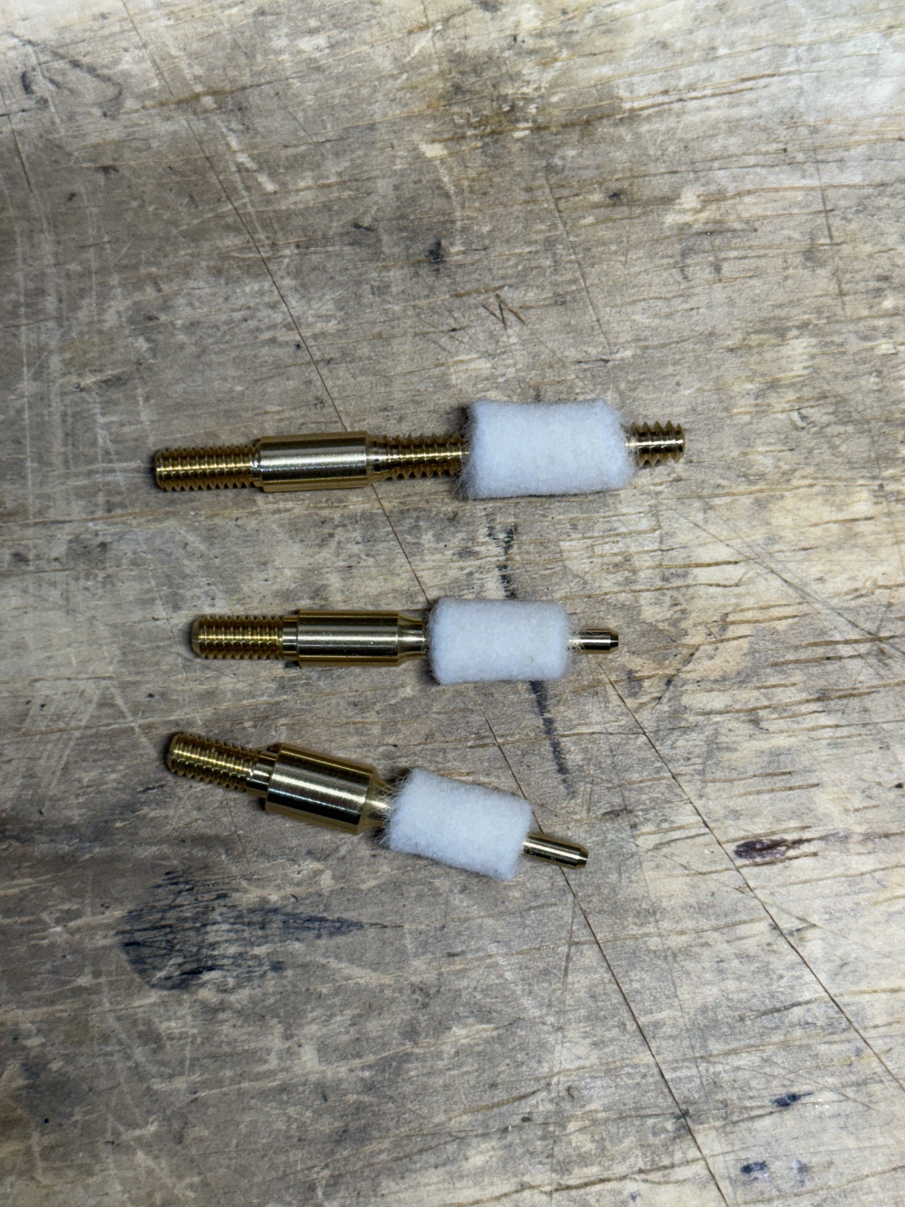

I have been using VFG pellets for 12 years or so (recommended to me by @Zak Smith) . I use this on my Dewey Rod (pictured below). You can use one pellet either screwed on or just slipped on. You can also use two pellets where the first one drops off at the muzzle while the other stays put for scrubbing.
Choose in drop down menu:

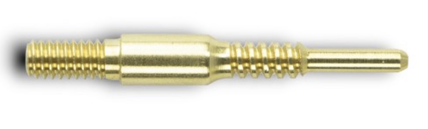

I used to use those a bunch for 30 cal. Kinda lost interest in them due to the smaller calibers only having enough thread for one pellet. The 30 cal holds two (and a half) pretty easily.
I seem to recall finding a newer jag for the smaller calibers that held at least two pellets, but I don't recall where.
