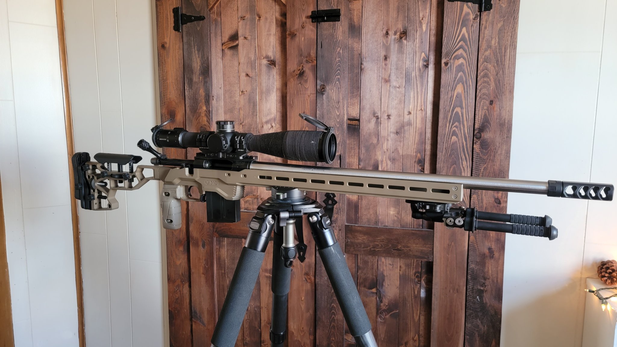

Hey guys, my build is coming up on its "final" evolution. What I'm hoping for is a short action ELR rig. It doesn't really need to do anything else in this configuration.
Here's what I'm working with if that matters:
As of now I have a 224v barrel and a 6.5 creed barrel.
What I'm wanting is a 7 SAUM. Don't really want to mess around with the Sherman's or anything. I'd like to use mags (even of the rest of the build makes no practical sense).
Where I'm lost is barrel specs and what to realistically expect.

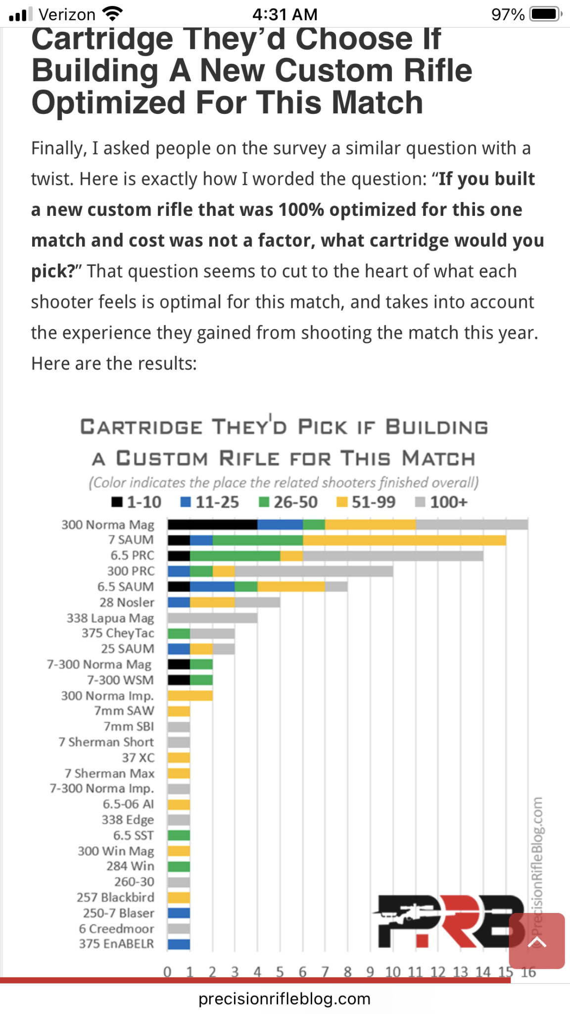

I shot a short action 7 Saum at the NF ELR - ran 183s one year and 184s the other. Had lots of feeding issues - defiance and atlas actions, different magazines too - running at 2.95 leaves little room for error - about one in ten would hang up.
I moved to the XM platform and feeding issues went away, plus I picked up speed from the extra capacity. If you want to stay short action, I would run 6.5saum/prc - lots of great bullets in 6.5.

For a Joe Shmoe wanting to do some ELR with a lot of bang for the buck 7 saum makes even more sense.
I do think that if you want mag fed and ELR it’s better on a medium or long action.

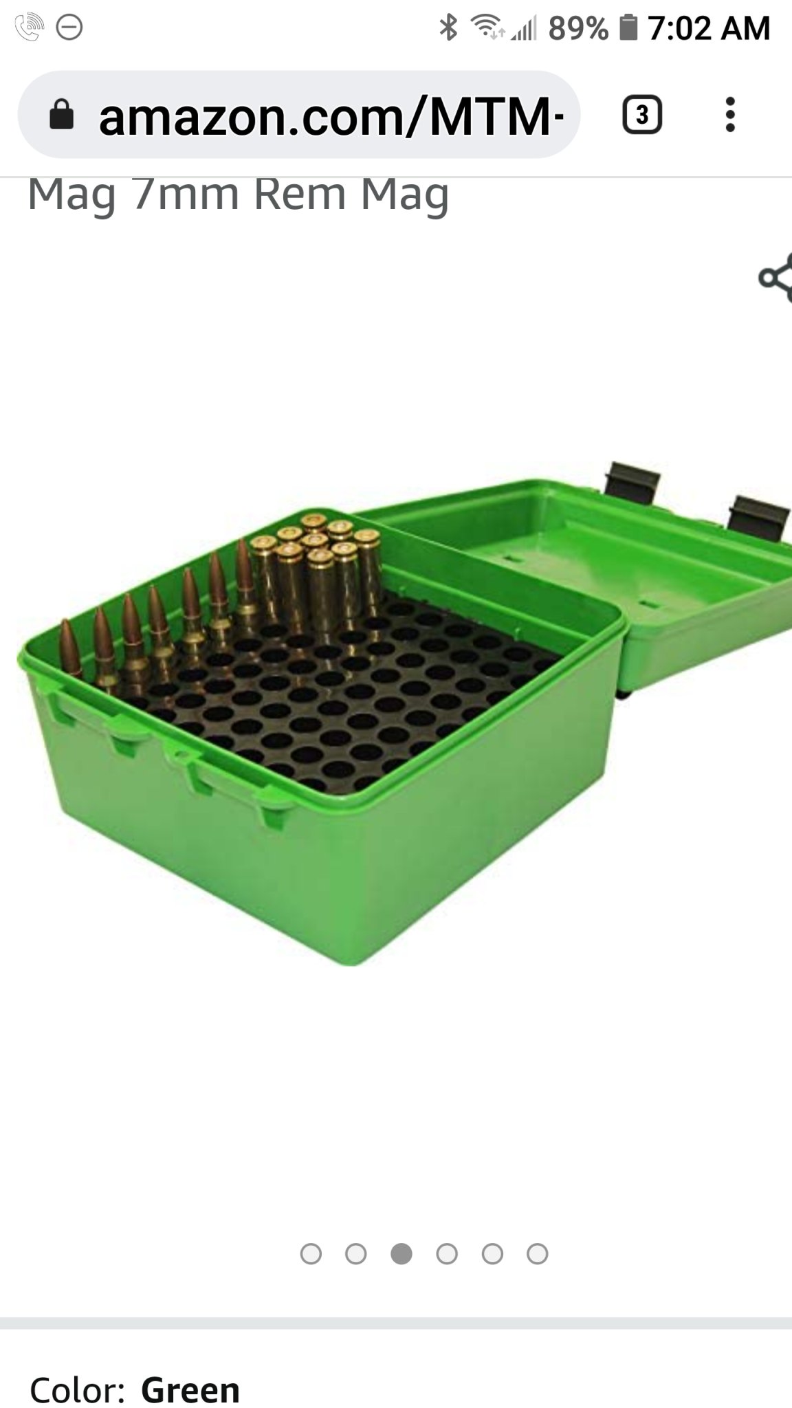

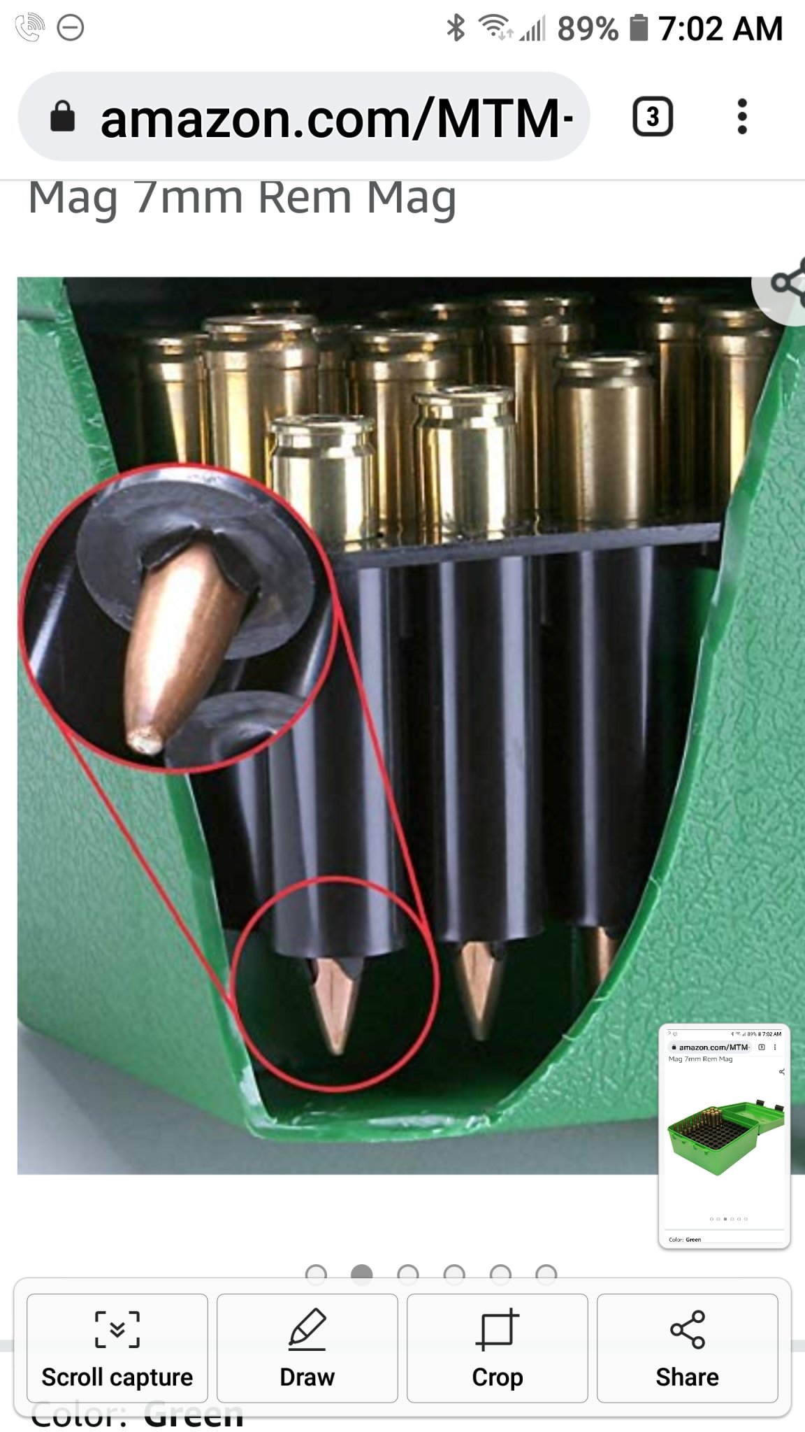

A kinetic puller uses the mass of the projectile to remove it from the case. If you watch the above video, you can see this on a smaller scale from leaving rounds in your car while you drive around. Many f class shooters seat long and do final seating at matches to avoid this issue.
Actually, they seat long and reseat at a match to avoid any possible cold welding.
Are some of the competitors transporting their ammo in these?
Even though the insert supports the projectile, I can see how it's weight would allow it to move outward if stored in the bullet down position.
I agree that it would have to be super light neck tension for it to happen.
Easy fix is simply to seat long and do final seating at the match.
