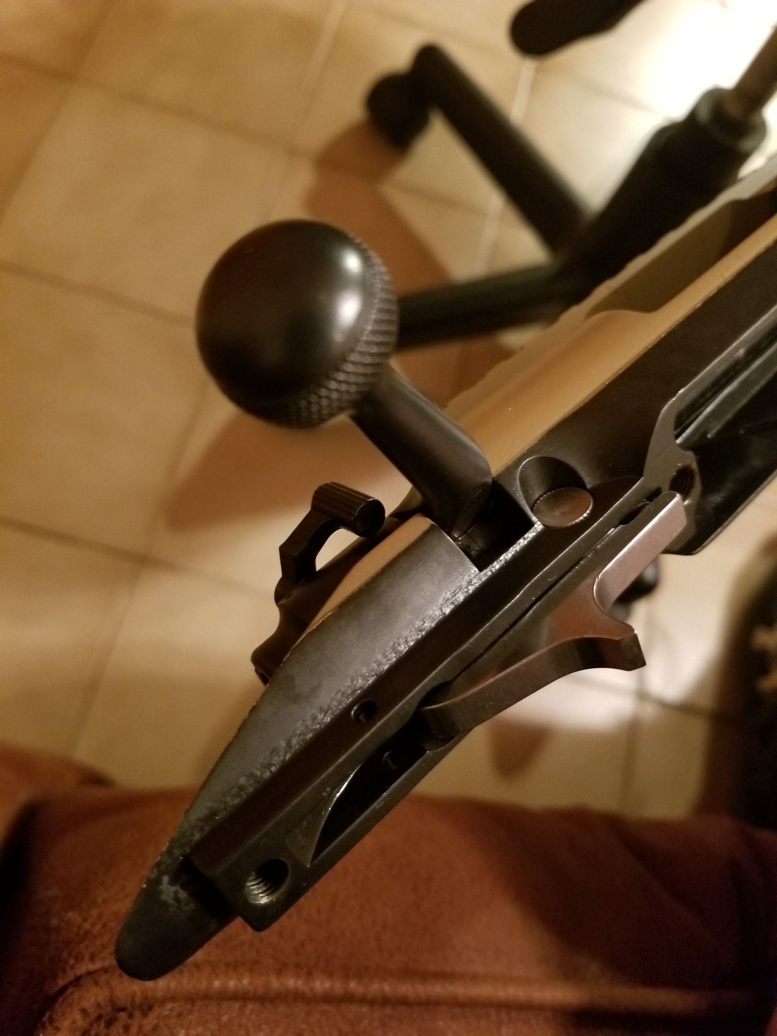

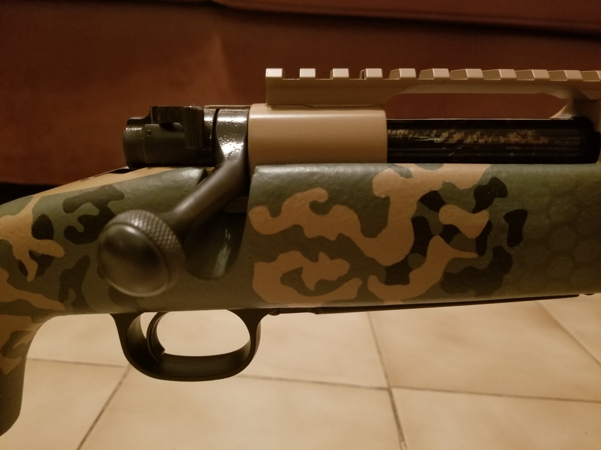

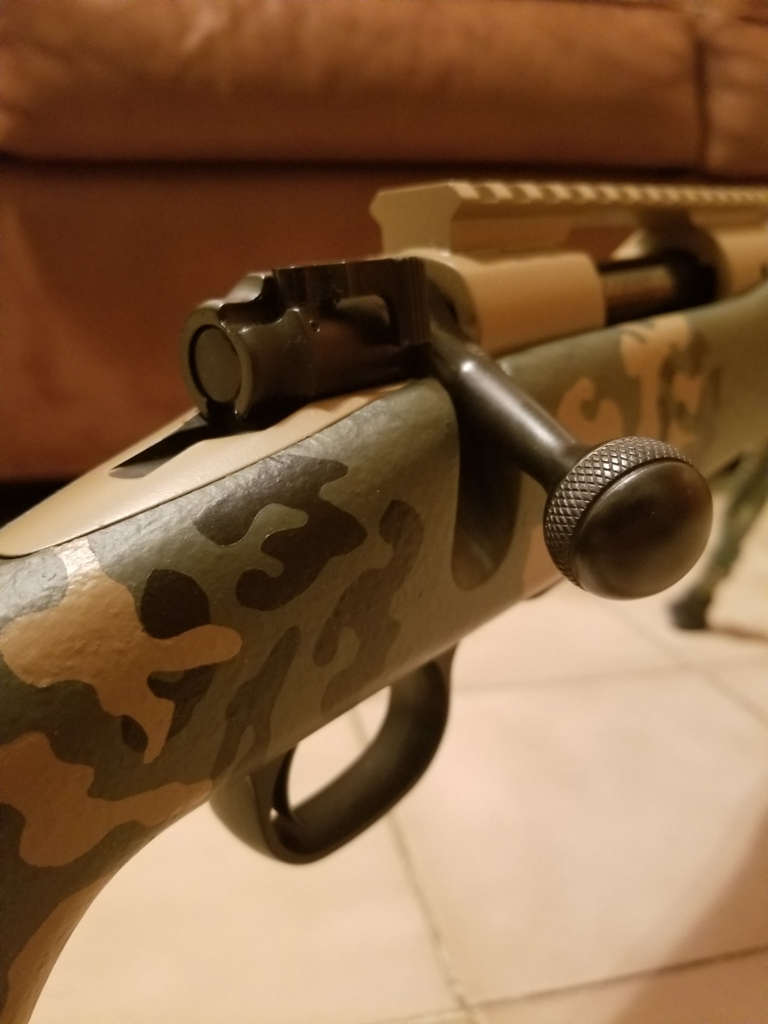

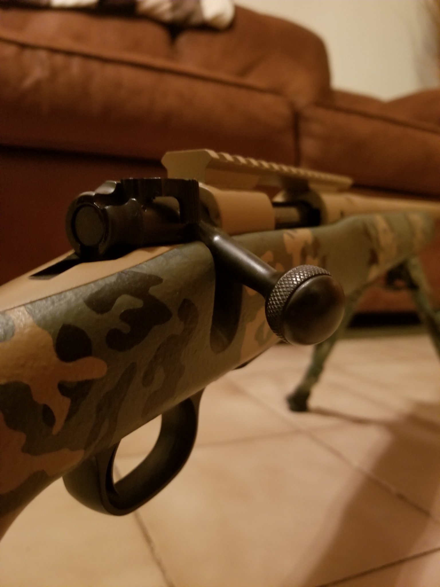

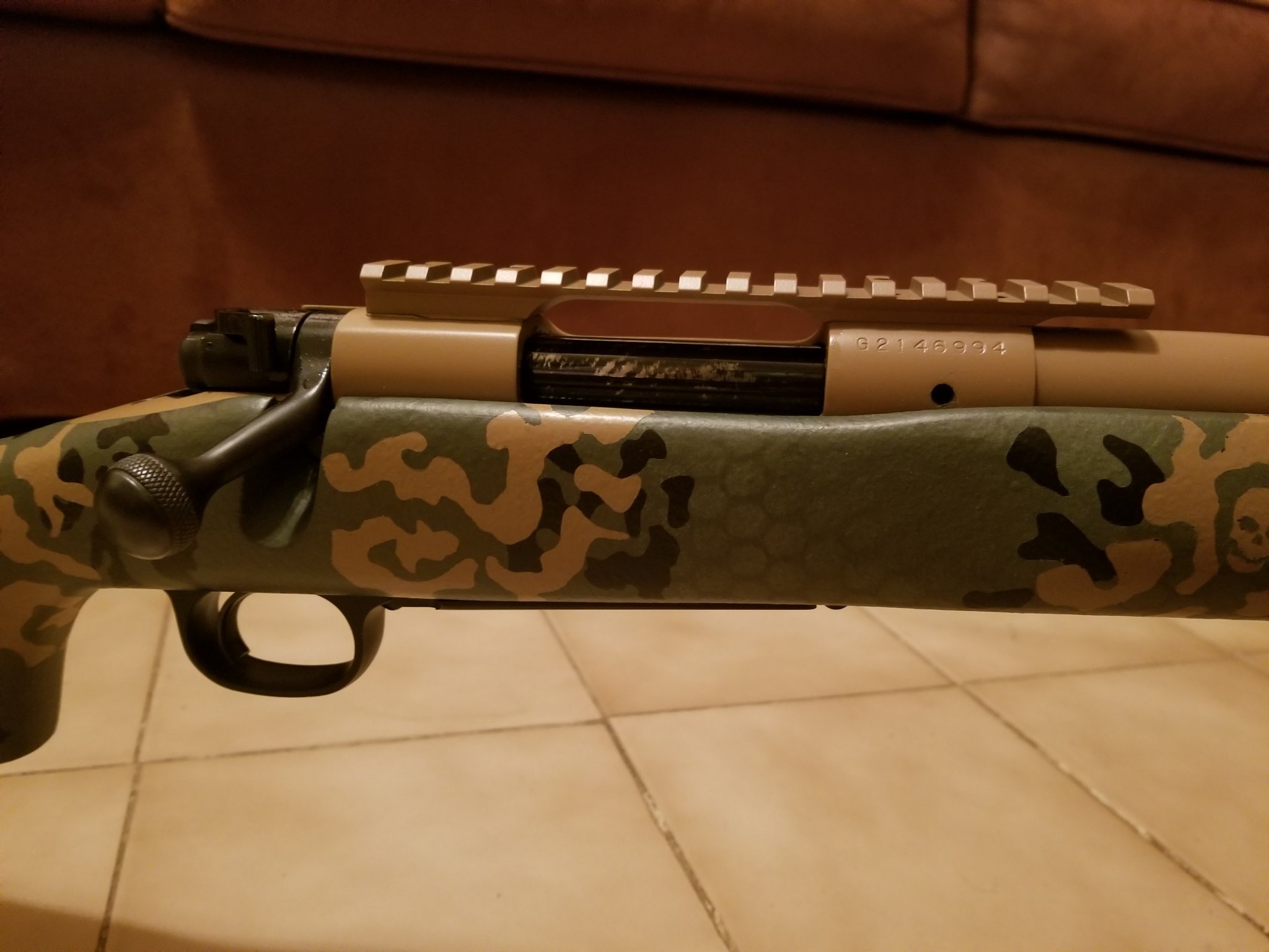

    Hello all,
    I recently took apart my new to me win70 to give it some style (new paint job) and have already put it back together. At first, I placed the barreled action in the stock and realized I was missing the trigger. Took it back out, put trigger in, etc. Now I've got the whole thing put together but I can't get the bolt to rotate down and close properly. I haven't put any live rounds in yet but it dry fires just fine.
    I turned it's 90 degree throw more into like a 40 lol. Maybe this is a good thing. No but seriously, am I missing anything?
    It's probably something simple that I can't think of at the moment. If someone can help, I would appreciate it.
    Thanks,
    Serg

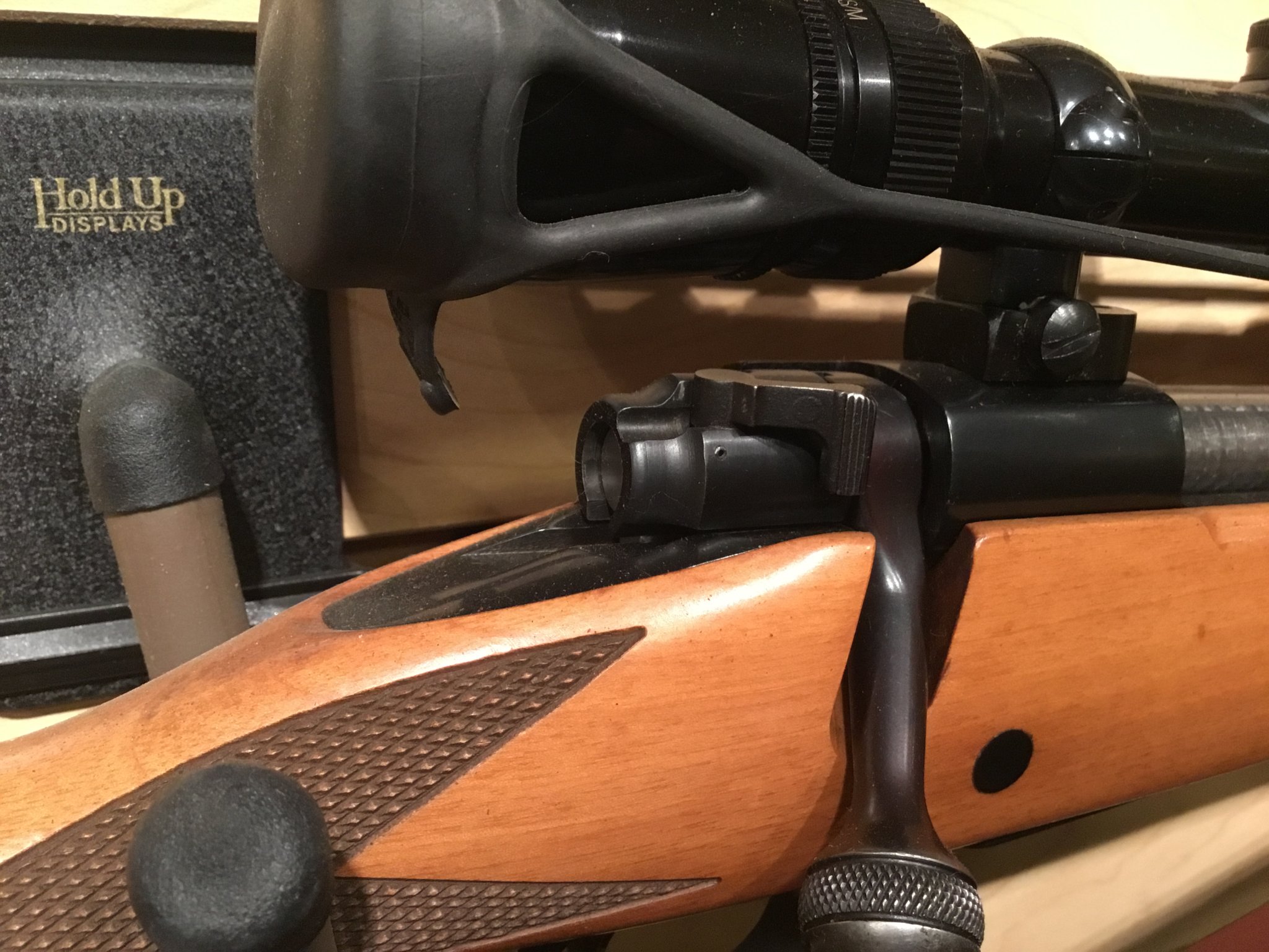

    If you raise your bolt will it cock? You may also make sure you didn’t put your action screws in to tight or the wrong order, the one in front of the trigger will go up into the action and not let it close
    You can take your bolt out and either look in the action or just back out your front action screw and see if that lets you close the bolt completely

    How the heck do I get the safety into the middle position. It'll decock because I can dry fire it or I can decock it manually but I would have to take the bolt out.
    I'm trying to move the safety but it seems to not want to move at all.

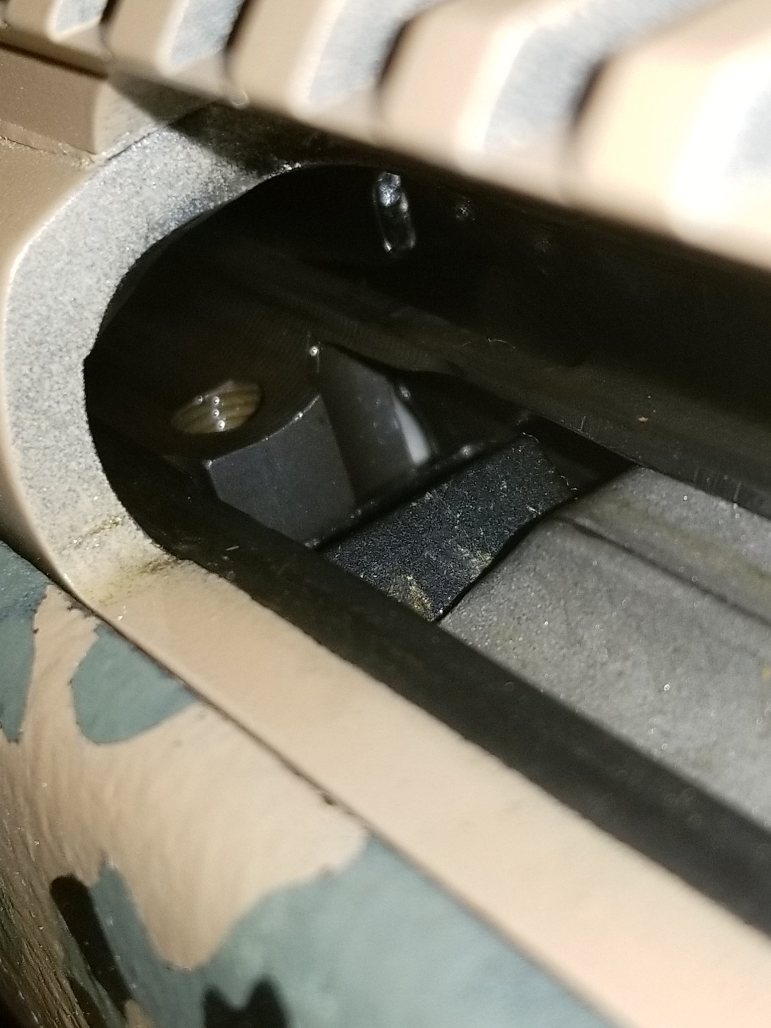

    Took the trigger off but that did nothing. It still won't go down all the way. I'm guessing it has something to do with that other part still in the action. I've never messed with or removed that part though.
    If the bolt won’t completely close you shouldn’t of been able to dry fire it, that’s why I’m confused on how it isn’t cocked.

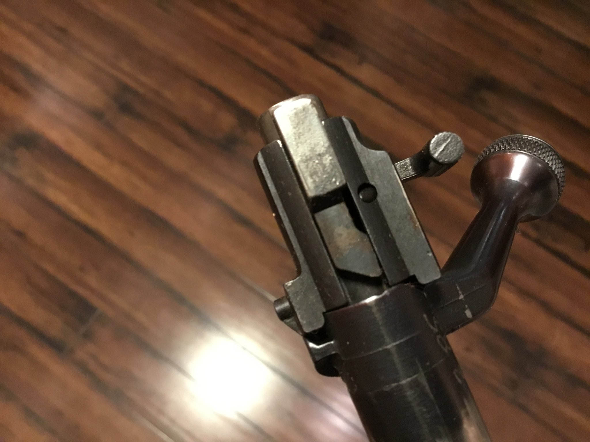

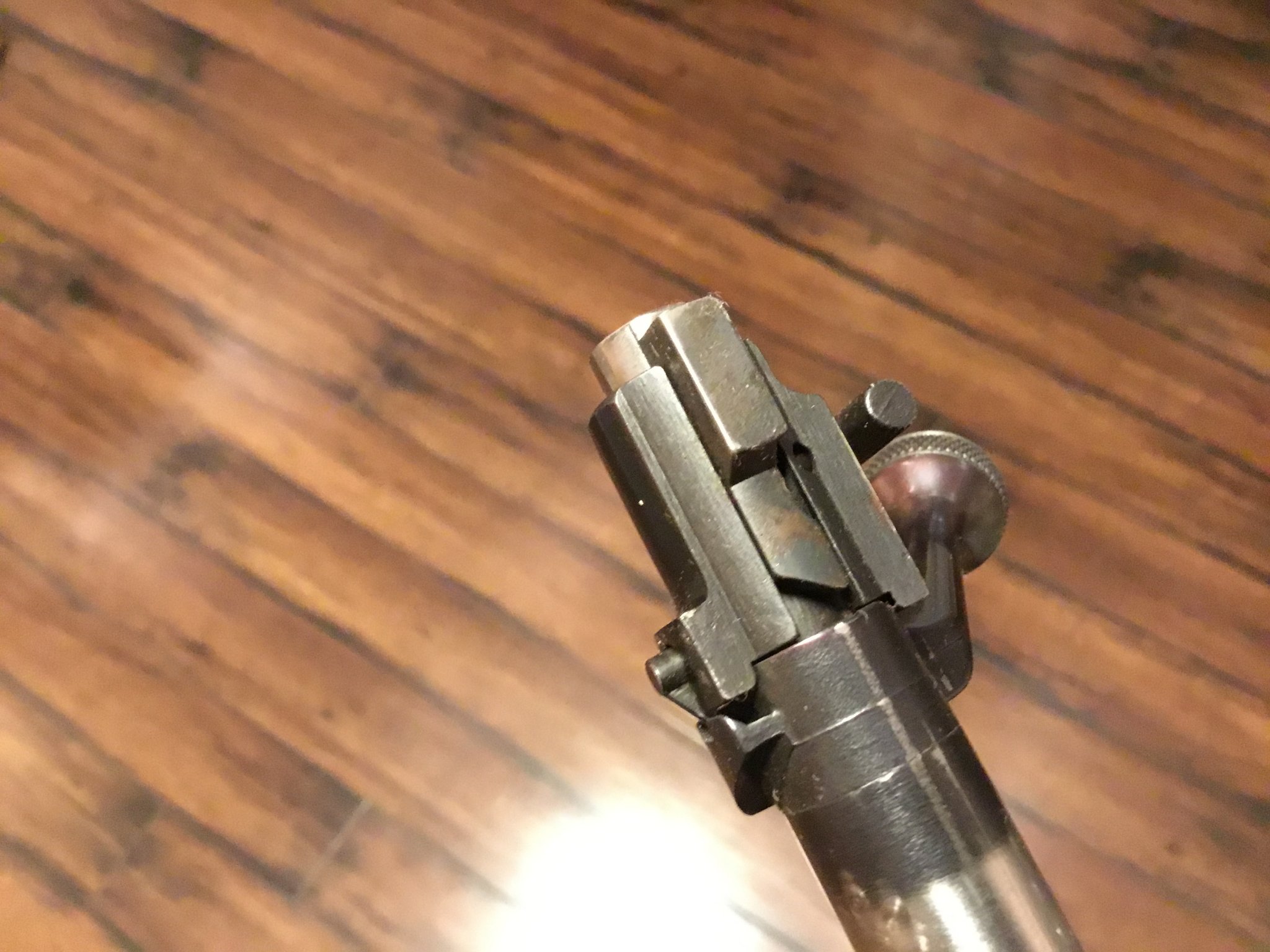

    Does the bottom of your bolt look like that?
    No no no, I know you insist on that. The firing pin is not cocked in all my pictures because I just happened to take the pics when I "fired" it. I could have taken the pictures with it in the cocked position but it would have been the same thing.
    I'm actually laughing my ass off because I just figured it out though. One of the base screws was too far inside the action. I backed it out and problem solved. Which brings me to another problem though. I had that screw torqued to spec, now it won't be if I want my rifle to function properly.
    Damn it!!!

    I just took all four out and they are all the same size. This sucks because I can't get any torque on the rear one (from the front two) and this can't be good. At 10 inch pounds it won't let my bolt close all the way. This is a brand new 20 moa weaver rail and the screws are the ones that came with it.
    Sorry, I misread you post, I thought your action screw you removed, your base screws are to long, that’s a new one for me. Well at least we know now. Looks like a call to weaver Monday might fix you up.
    Quick update:
    I found some other screws. These are the ones that came in the crappy cheap bases that came with the rifle. I guess they aren't so crappy after all. The screws on there were literally shorter by a hair lol. They worked though, I'm able to torque to spec and run the bolt all the way in its full range of motion as it should...
