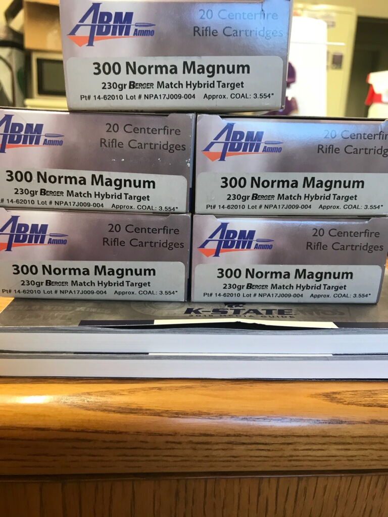

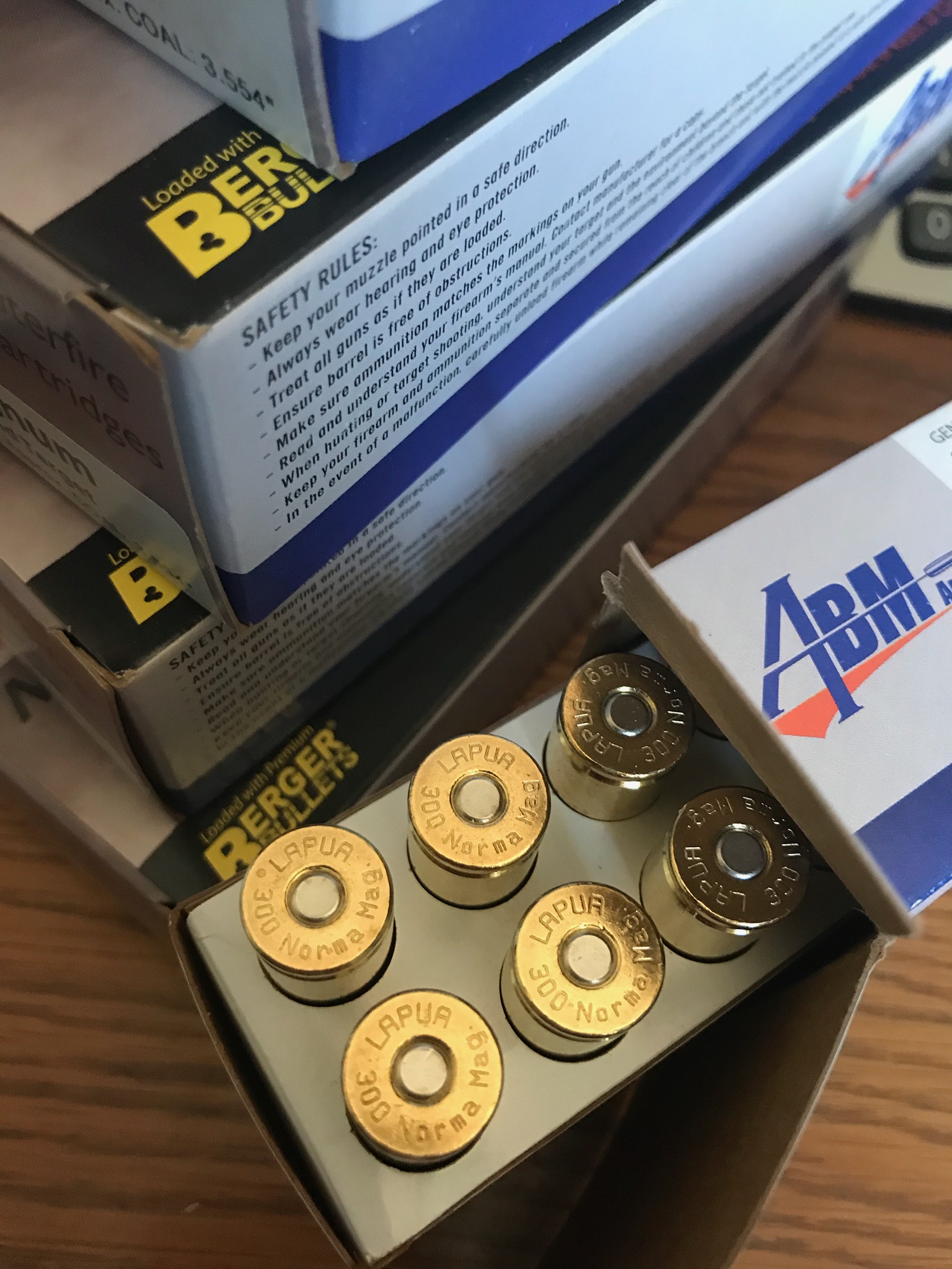

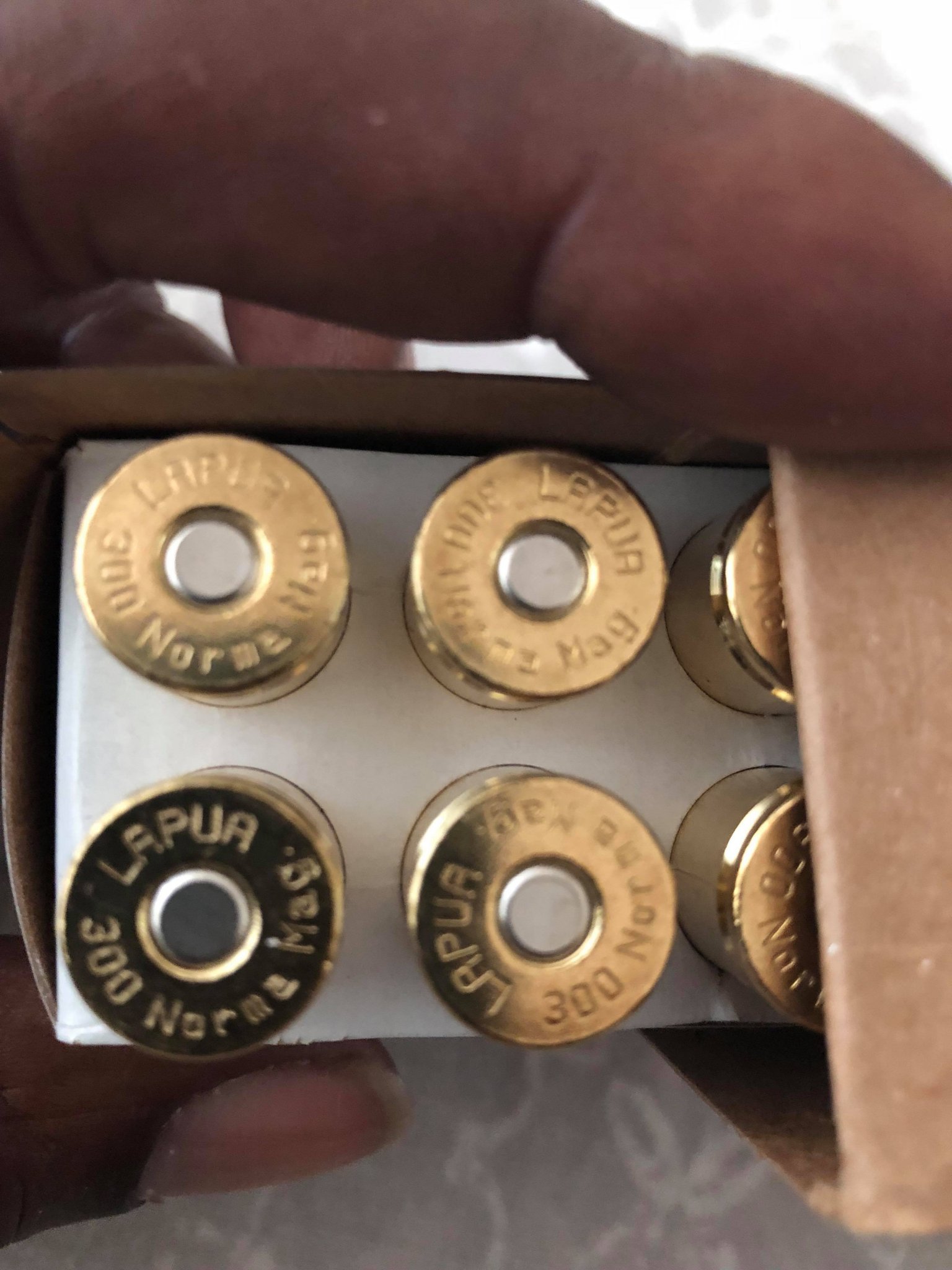

As mentioned it does use the lapua bolt face and you can also get 300 norma lapua brass. You can also buy new ammo loaded with Lapua brass from ABM ammo which I think is now made by Berger if I'm not mistaken. I agree that it's a huge step in the right direction having Lapua brass. I'm pretty sure Peterson makes brass for it as well but u have no first hand experience with their brass yet.

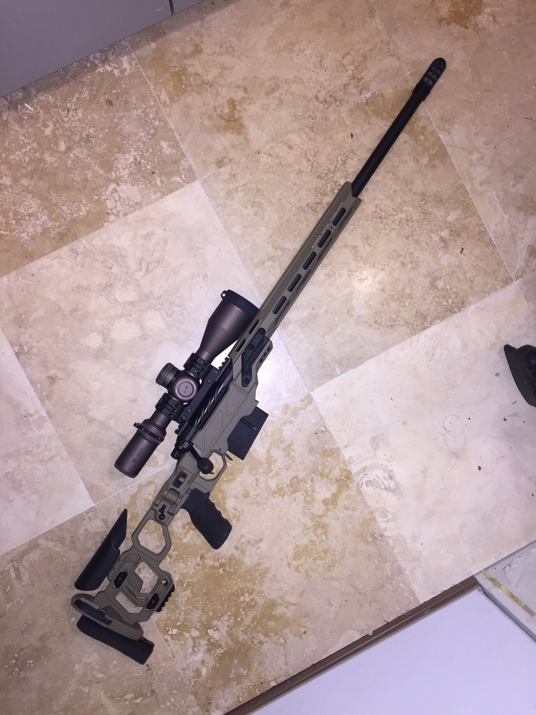

I went custom for mine. I had the exact same intended use and couldn't be happier.
Mine is a SAC 300NM
Defiance Alpha 11 Action
Bartlein Barrel - 26" Heavy Palma 1:9 Twist set up for 230 Berger Hybrids
Cadex Chassis
TBAC 338 Ultra
RL33 and Norma Brass @ ~2900 fps
Old pic prior to receiving stamp for suppressor. Now running the Area 419 break and TBAC adapter.
I love this rifle. You cant go wrong with whichever you choose. I went custom so I could have it set up just like I wanted.
Damn that thing is nice. I was inches from going Cadex Lite but really wanted a full top rail.
When a man is wrong he is wrong and I am very wrong.

300 NM bolt is same as lapua bolt. And Lapua does make 300NM Brass. I just ordered peterson brass which most people say is as good as lapua and there was plenty in stock. A little while back when only NOrma made the brass I def would have stayed away from it!
It happens to all of us ? I've really been kicking around the idea of a 300 norma barrel with the lapua brass. A buddy has been shooting his at 2k yards and it does quite well.
Midway had one hell of a deal on them, if I would have had the money laying around I would have bought a bunch. Isn't worth reloading at that price.

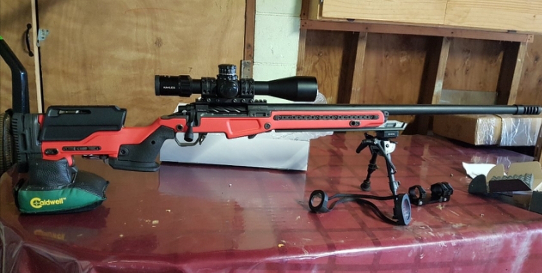

My vote is build custom rifle - that way you get the rifle to exactly the way you want.
I went custom route with my .300NM, and absolutely love it:
- Defiance Deviant action, polished rails and DLC'ed
- JAE chassis with paint job from Custom Gun Coatings, NV rail and hopefully a bag rider soon
- Benchmark and Hawkhill MTU contour 1:8 twist barrels (I have two barrels spun up for it, it's a barrel burner)
- Bix 'n Andy Tacsport 2 stage trigger
- Khales K624i scope with AMR reticle
- ARC M10 rings
I couldn't be much happier with it, puts a smile on my face every time i shoot it. The JAE is the most comfortable chassis you will get behind (the AI is a bit hit or miss with how it fits people). I wouldn't change a thing with how this rifle is built.
What two round holder is that and how is it attached to your chassis?
@ratrod54 Very nice rifle! What is your overall length and what bag are using to transport your rifle?
@kthomas same question.
Thanks
I forget the overall length. Originally I wasn’t going to do the folder, but the overall was too long to fit in a pelican case. With the folder, it fits in a pelican 1750 case nicely with the bottom foam cutout for the folded buttstock.
