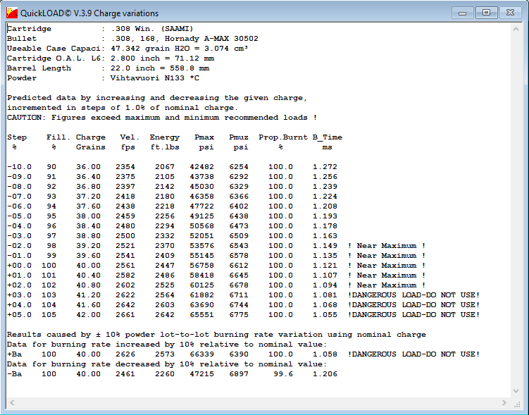

Gungnir388 Sniperish Minuteman Nov 14, 2020 73 44 Wisconsin Mar 7, 2021 #1 Mar 7, 2021 #1 This is for 308 Hornady 168gr ALD Match, Alpha brass, and fed 210 primer. I remember seeing it but I can not find the thread it was on. Thanks in advance!!! Jason

rustyinbend GySgt USMC 1976-1992 Full Member Minuteman Dec 9, 2018 3,382 3,797 Bend, Oregon Mar 7, 2021 #2 Mar 7, 2021 #2 Made assumption of a 22" barrel ... if otherwise, let me know and I'll rerun for you.
Gungnir388 Sniperish Minuteman Nov 14, 2020 73 44 Wisconsin Mar 8, 2021 #3 Mar 8, 2021 #3 Yes 22" barrel, my bad. Thank you Sir. @rustyinbend
