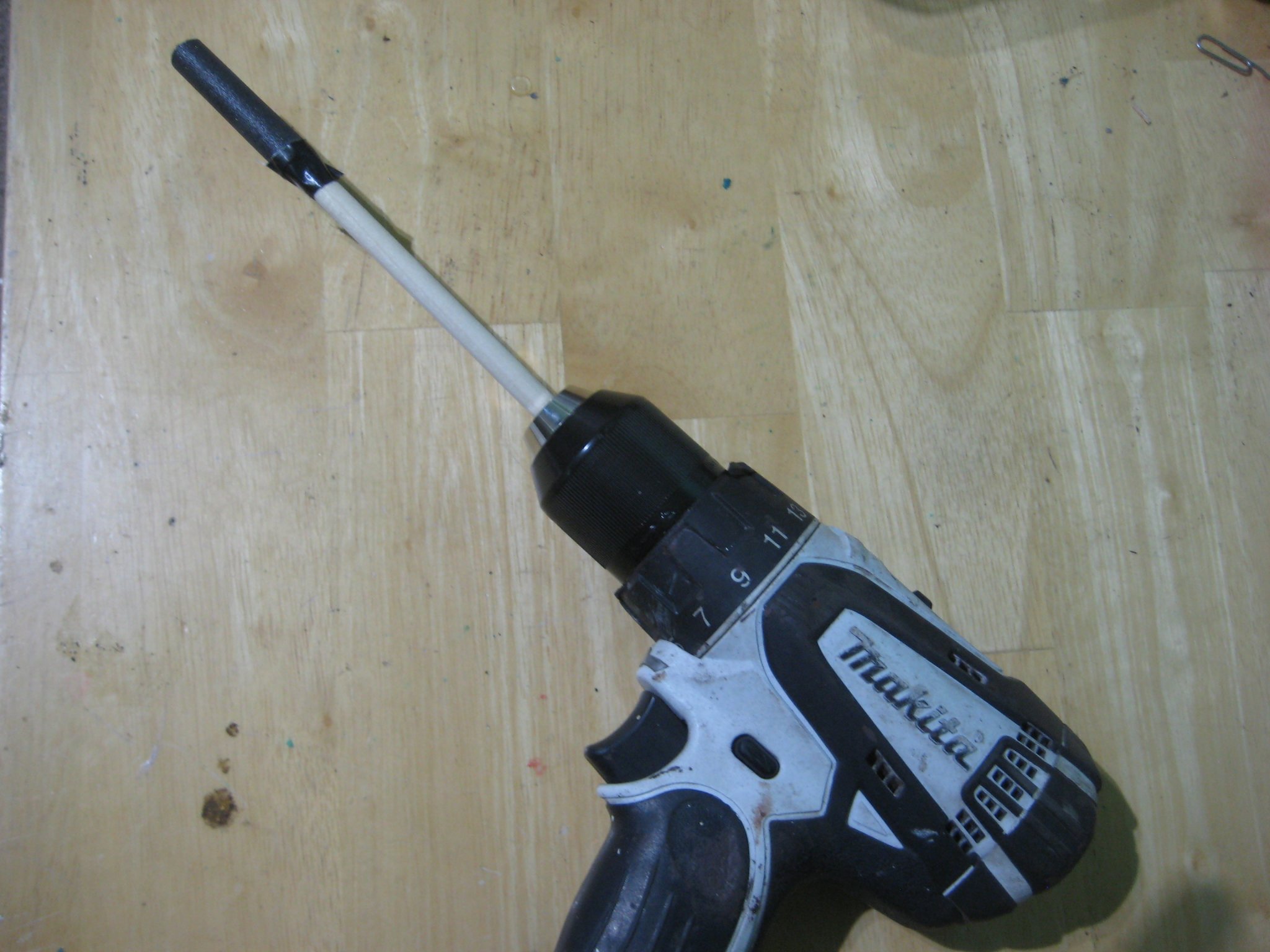

An idea:
Take a wooden dowel rod and affix a piece of emery cloth to one end. Chuck it into a hand drill and polish out the rough area in the chamber. Let your son watch and learn something. He may see a day where ordering a new barrel is not an option. Drop a cartridge in as you buff it out to check your progress.
Open to criticism.

An idea:
Open to criticism.
I tried that with an undersized chamber before and it wasn't enough, you need a few turns with a finish reamer.
Well, we don't know if it's undersized or just needs some finish work. Nothing to loose and he might teach his son a few things along the way. From a mechanic's point of view, this old method of cleaning out a cylinder evolved into the modern day "flap wheels" that are used in every industry.
I would try that just for laughs and giggles. If it worked I would still replace the barrel, but then I would toss the “fixed” barrel in the “extra parts” bin for a rainy day.

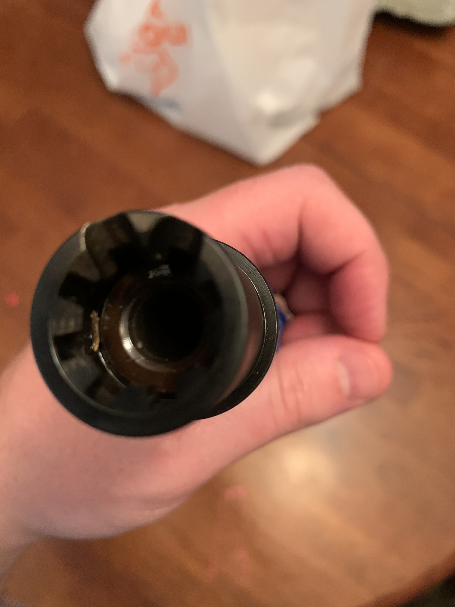

The picture is very blurred but looking at the primer pocket it looks like it may have been reloaded. I see what looks like a primer crimp remover that swages the ring crimp of fired military brass. If the brass was not full sized it could cause it to stick.
Also I agree with a comment about a rough chamber. If the brass is shearing off this could also be hydrogen embitterment from someone washing the brass in a chemical with high ammonia content.
What ammo have you tried. Be careful in firing 556 ammo in a 223 bbl. Only fire that in a 556 bbl such as Daniel Defense or a Wylde bbl.
The correct buffer weight and gas port comes into play also. An oversized port can be detrimental. I normally use an adjustable gas port for direct impingement. My preference is an Adams Arms gas piston. Especially for an SBR. The gas pressure from the gas port position is higher plus the blow back from a gas impingement on a short bbl is brutal even with the charging handle ported. Look closely at the brass and the ejector.

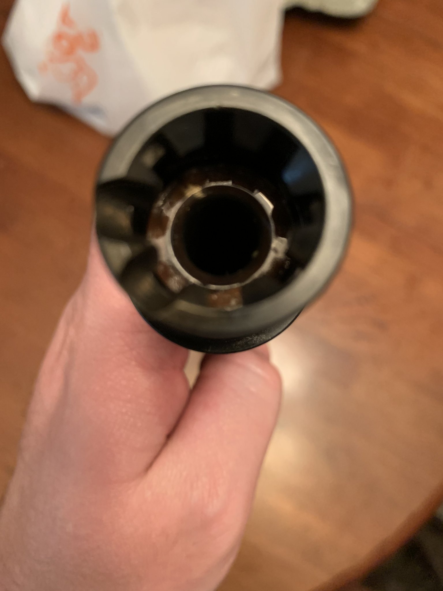

Took our oldest to the range with his new rifle his uncle built him. We were shooting 5.56 through it and it would shoot but not extract. Pics below of the brass aftermath. Tried 223 and it would shoot, eject, shoot another but only halfway eject while it tried to cycle another round in. The RO and someone else tried diagnosing it to no avail. We swapped the bcg for mine and it had the same issue, although I don’t think mine was shearing the brass like his. What could be causing the issue?
My thoughts?
1. Not chambered for 5.56
2. Gas tube issue/pressure issue
3. It didn’t seem to like the mags I brought for it but he left his at home his uncle gave him.
It’s an Anderson lower and I don’t know about the upper.

Um, I'm no longer a military gunsmith and the photos suck but Hoss, you gots a problem there. If I had to guess JUST from that single photo I'd say that your chamber was cut with a well boring cutter in SERIOUS need of sharpening (Sarcasm) AND your gun is so overgassed that it is slamming your bolt into oblivion and ripping the rims off. Without a doubt I'd put money that the cases are scored something fierce, too.
Buy a NEW barrel and 0.075" NON-ADJUSTABLE gas block and have it installed. Personally I don't buy anything but Rosco barrels for quality builds. Primary Arms and LaRue make superb barrels as do a number of others but if you want a good BASIC upper/barrel, I have several from PSA that have been giving me STELLAR service for comparatively little cashish, so don't turn up your nose at them but don't delude yourself into thinking you'll take home medals at Wimbledon, either. Just sayin'. Good luck.

maker of gun? need chamber go/nogo 223 and 556, gas port size tube length, recoil spring/buffer. why do people they can buy parts and build

Got the barrel swapped but nenes to get the fsb pin slots in the barrel. What came from white oak wasn’t what the fsb needed. Taking it to sons of Liberty on Monday.
Here is the old barrel and the sheared brass inside of it.
