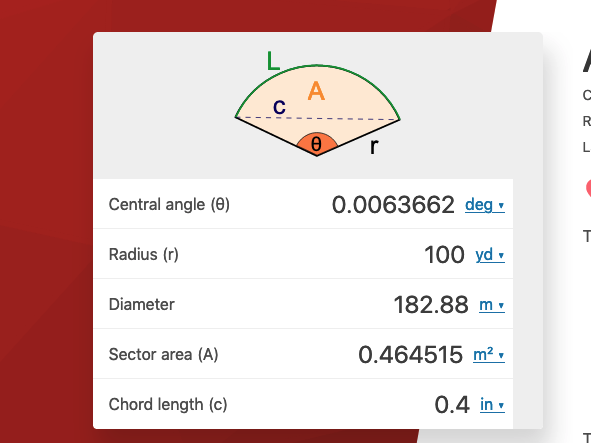

Lateral displacement at the target is the inverse ratio of the distance from your shoulder to the chamber on the rifle vs the distance from the chamber of the rifle to the target multiplied by the displacement at your shoulder. My rule of thumb is 240x. So a .01 inch movement at your shoulder is 2.4 inches.
Reactions: harry_x1
So given that it takes additional .3 milliseconds for bullet to leave, the chances of lateral movement go up significantly? Possible to quantify that number as well...thanks again for your insights, super helpful.

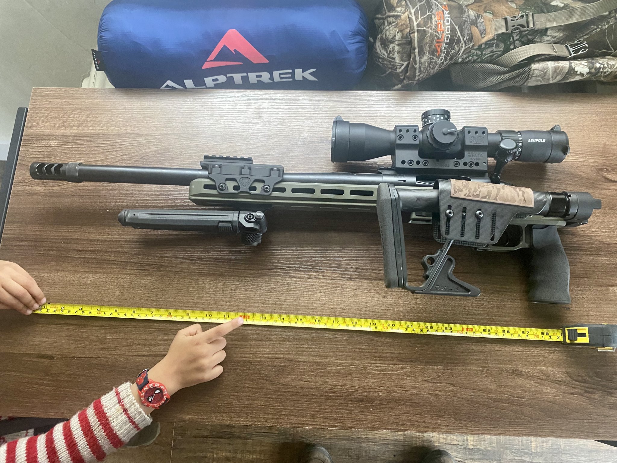

I think everyone in this thread deserves a look at the rifle in question. See attached image. Total lenght (stock folded) ~28.5 inches, weights 12 lbs (can be bought down below 10 lbs easily with lighter scope etc). This rile has negligible recoil (super soft), is like a laser beam uptill 1000 yards (0.25 moa),single digit SDs, is capable of taking night vision clip ons (illuminated reticle etc), fires a 147 grain projectile at 2600 fps (and thanks to the inputs from SH members, now does that within safety margins at 41.2 grains). I think I have achieved my mission of building a do it all rifle which is practical and effective (PRS, tactical, hunting, NRL hunter etc). I took it out for a match this weekend, and this rifle surely piqued the interest of many a experienced shooters, especially some of active army snipers (as they play more in realm of practicality)
My next experiment might be with a titanium action with even shorter barrell and slightly lighter bullet while meeting all the criteria given above. Will share pictures of the new rifle when done.

I saw that. I had the same one. Got a Harris with an ARCA kit from Short Action Precision and my group size was cut in half.
Driving a magpull bipod is like driving a Miata low on steering fluid.
Just for clarification...only reason to pick Magpul was its light weight. It is not a great bipod, but honestly I have never felt it lacking in comparison to my other atlas (minus the weight). I am curious regarding your comment about better accuracy with a harris. Can you add more color to why your harris seems to perform better. I do want to try a diff bipod vs magput, so trying to learn from your experience before buying one.
This make no sense. You say you care about weight but your component choices suck.
Sphur mount is adding unnecessary weight when you could go with lightweight rings.
Barrel is chonkey, run a smaller profile and/or carbon.
18" is also a retarded idea for a 6.5cm to meet power factor. You are cucking yourself for no reason.
You have a NV bridge that is adding unessisary weight to the gun. Why?
You could replace the muzzle break with a TI one , which will shave a few more OZ off.
This is if you actually cared about shooting NRL hunter to make weight class/power factor.
