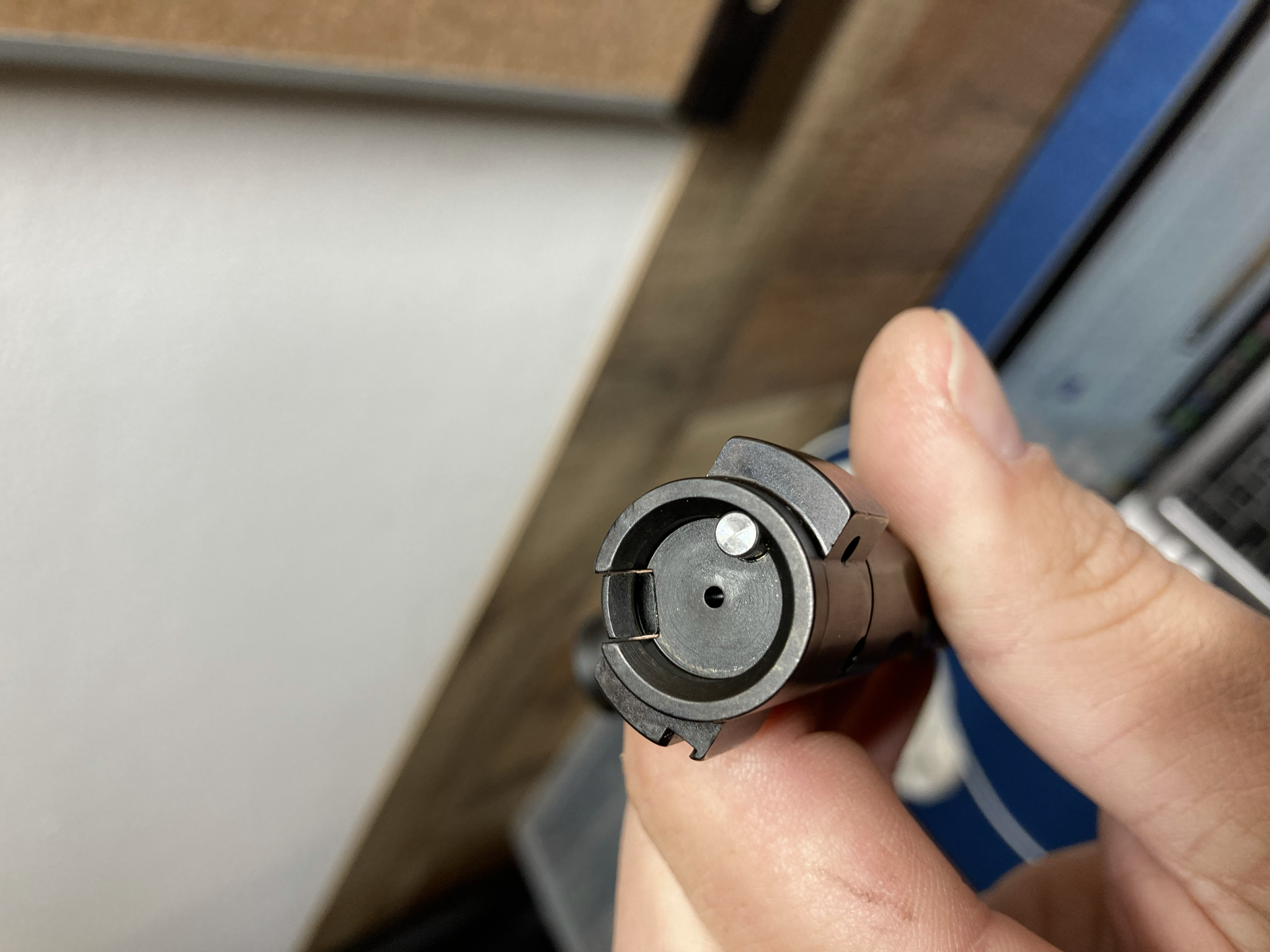

Ok guys don't blast me but this is my first custom build as well as first 700 based. Finally received my barrel so just got done torquing it down.
LP Fuzion action
6mm BRA Prefit shouldered barrel
Brand new Lapua brass
I made two dummy rounds last night while barrel was off getting CBTO measurements and using these once I chamber the round it won't extract the case when running the bolt. What am I missing? I measured the bolt head and it looks to be .480 and when I much a round down on the bolt seems that the extractor just barely catches. Ill attach a pic of bolt head.
No expert here, but the spring for the extractor is it installed correctly? Also the plunger spring ?
Hopefully this is brand new action never disassembled. I was hoping not to have to fly springs all over the place this early in the game but if nothing looks out of the ordinary it might be inevitable.
New extractor showed up today but now how do I change it. Tried finding a video but haven’t had any luck. I see the roll pin, just punch it out or is there some secret steps. I don’t wanna fuck it up.

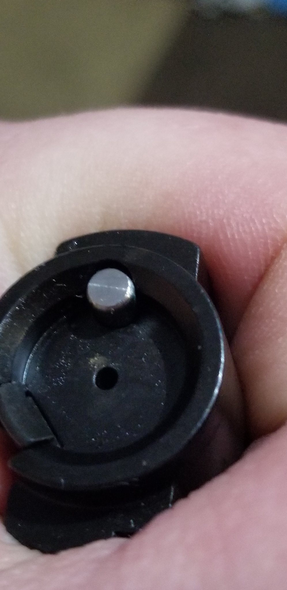

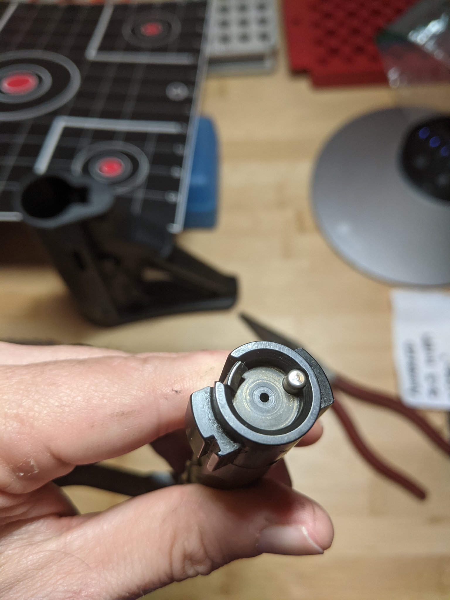

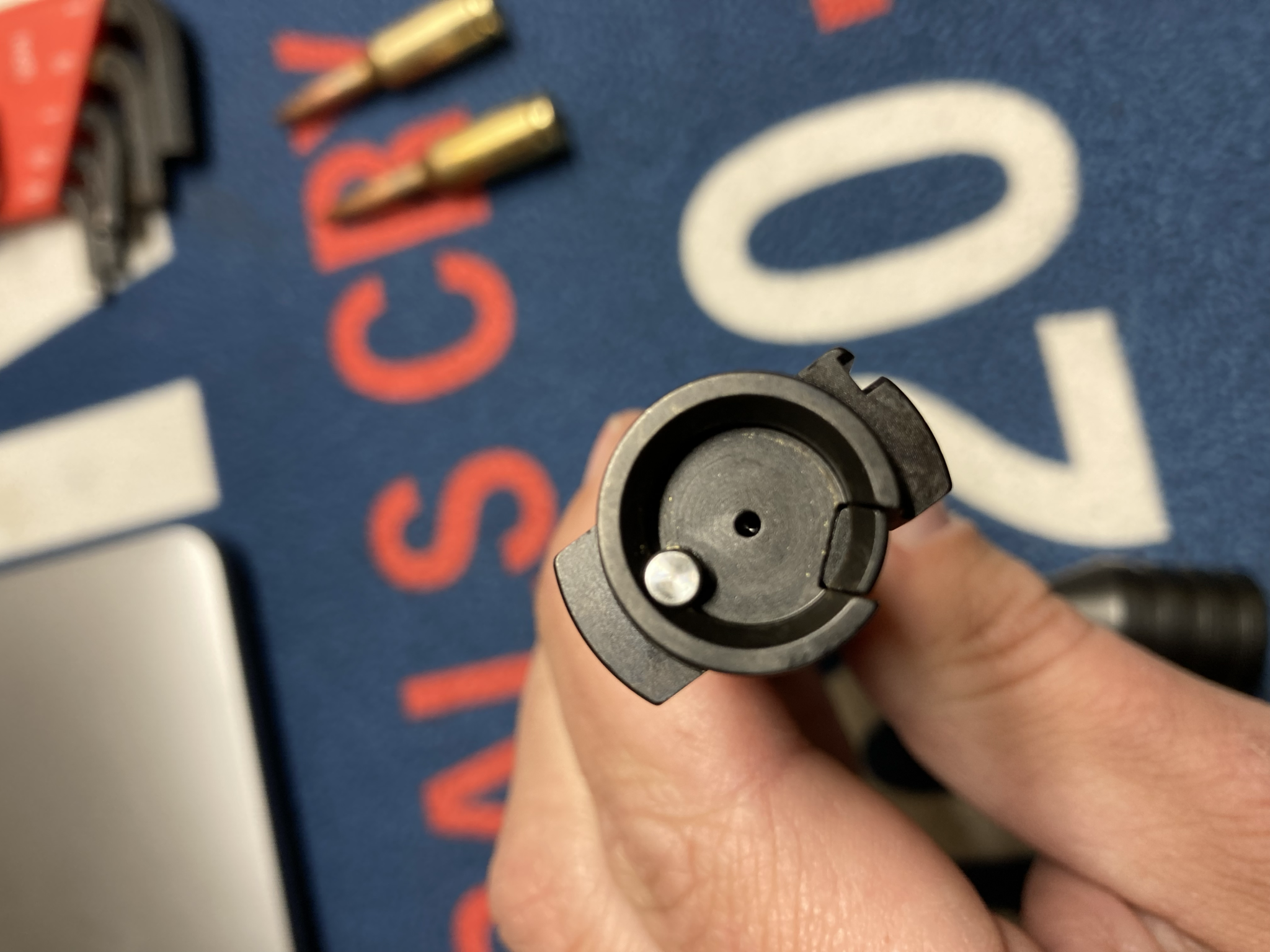

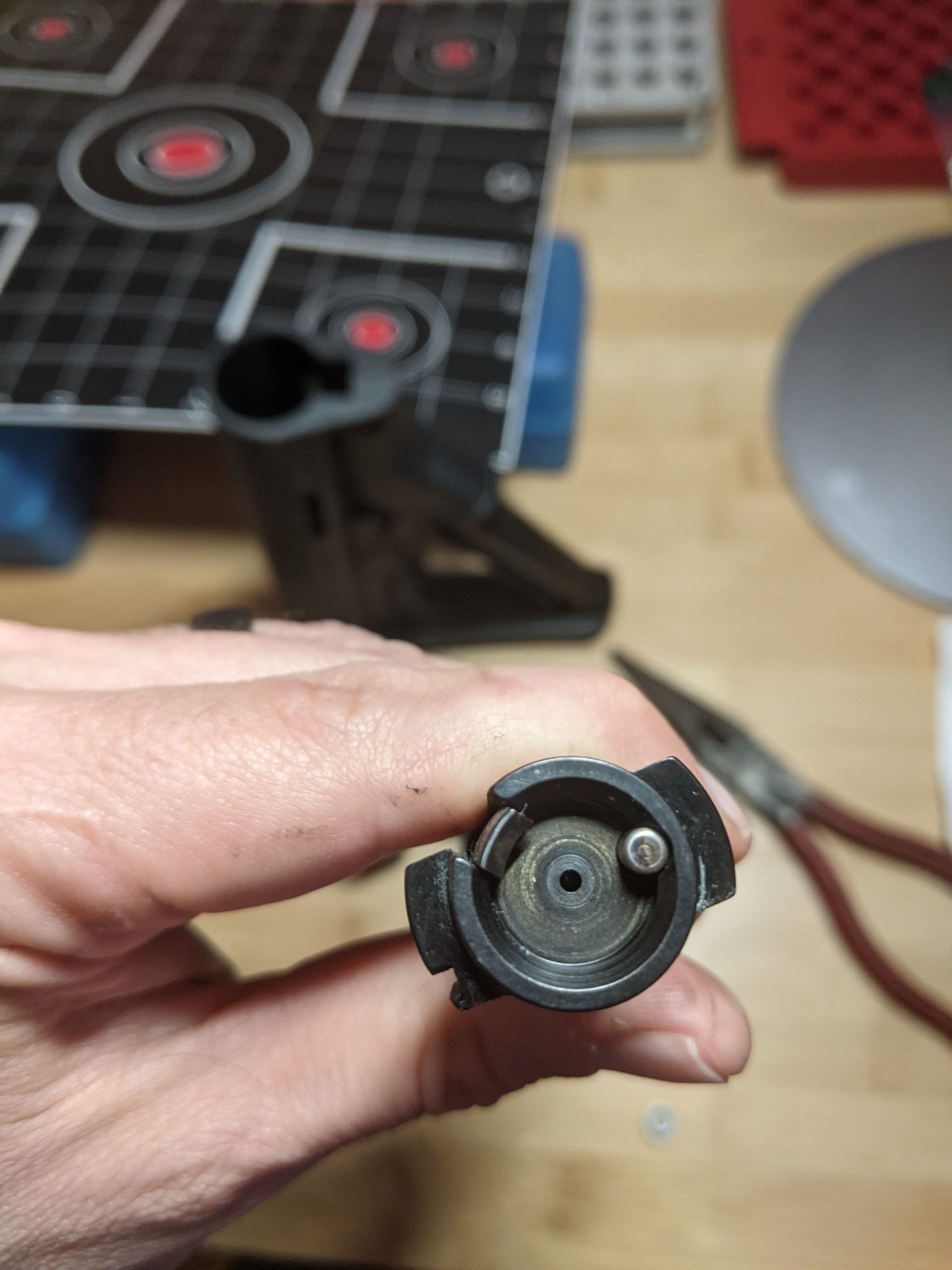

Its been suggested to me possible bur on ejector or something, this is a brand new action. I am going to take ejector out and maybe try to knock down anything around ejector hole as well as ejector face itself. KThomas my ejector definitely looks a lot flatter with less radius than yours pictured.

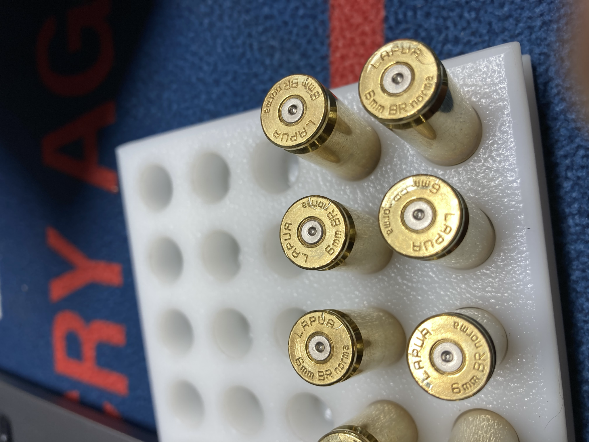

Was a slight drizzle, bore and chamber were cleaned. I think I might have narrowed it down. After pulling the ejector I did notice a bur around the ejector opening so I tried massaging it out the best I could. While that was out I also pulled the FP and chambered a piece of virgin brass and the bolt just fell closed. Although I thought there was a slight crush it seems like there is not.

Yes the simplicity of fireforming was my main reason for going BRA over dasher lol. I’ll reach out to them see what they think. I tried probably half a dozen peices of virgin brass and stripped bolt fell on all of them so either the Lapua brass is short or chamber a tad long.
I have a comparator for 40 degree shoulder when using that the fireformed brass is .001 longer. I dunno if I can use that as a solid number seeing the br brass has a different shoulder angle.
Got a go gauge?
With the ejector stripped from the bolt so it’s not pushing on things-
you can add a layer of scotch tape at a time to the brass case head, trim the overlap with a razor around the edge, and measure how much further it takes for to feel the br brass to touch when you chamber it.
