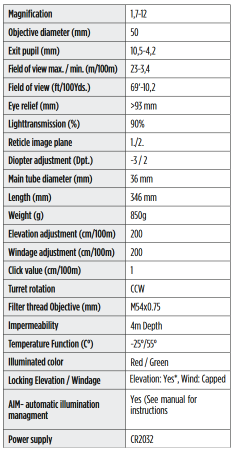

    I have never in my life looked at Hawke. I mainly attempt to avoid buying Ch-Ch-China. Browsing their webpage though, these two options are extremely interesting from a feature set standpoint:
