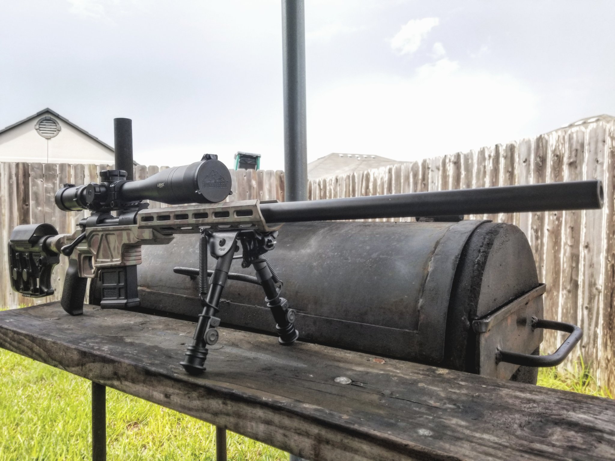

    I'm planning on keeping the scope base on there but removing rings/scope. Good idea on not painting the bottom part of my action. Had not thought it all the way through. This is how she looks now, not just want to kinda camo the whole rifle altogether since I do take it out into the field for hunting.
    Don't know exactly when I'll start to paint it, but I'll post pics once it's done...
