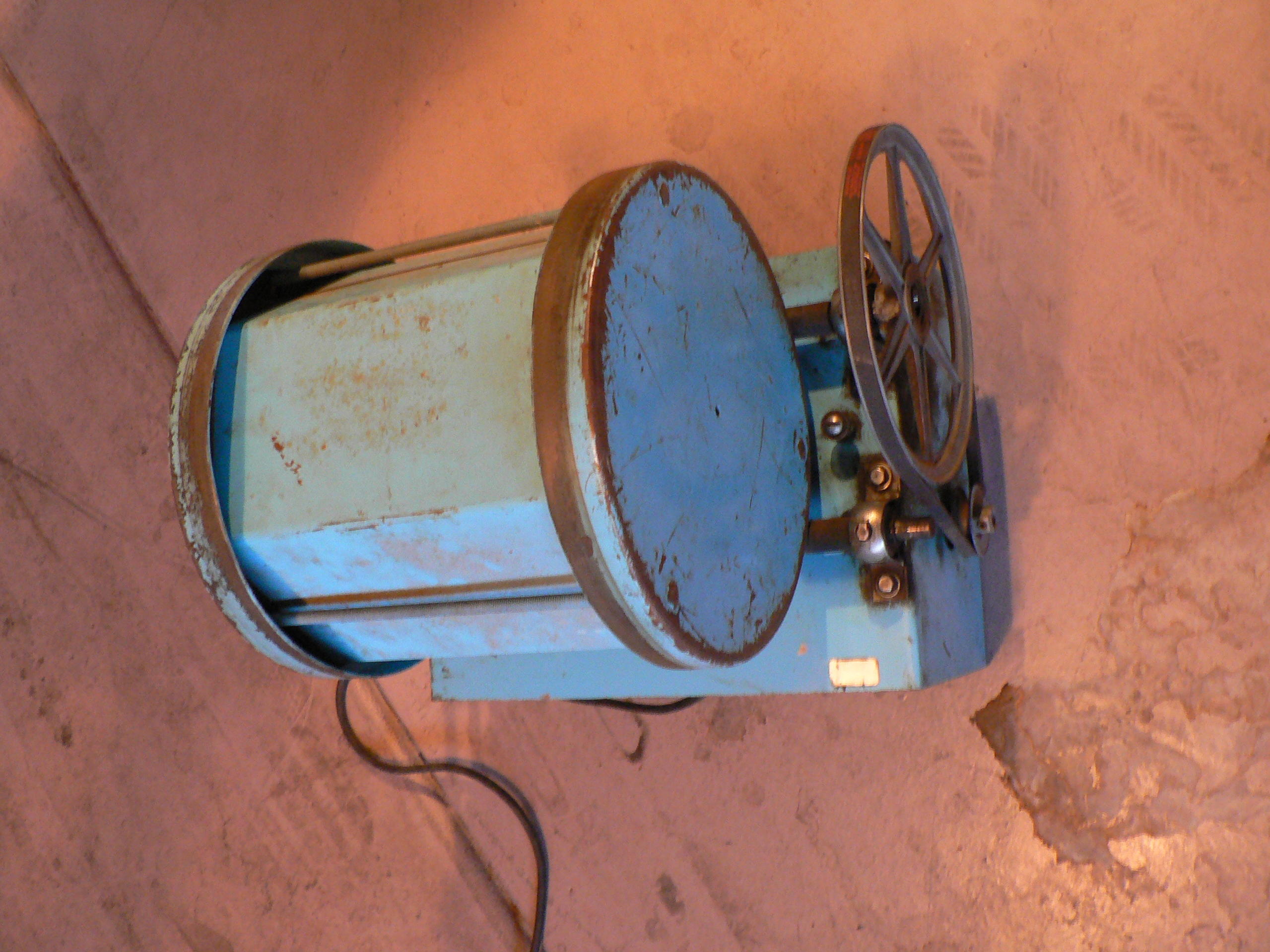

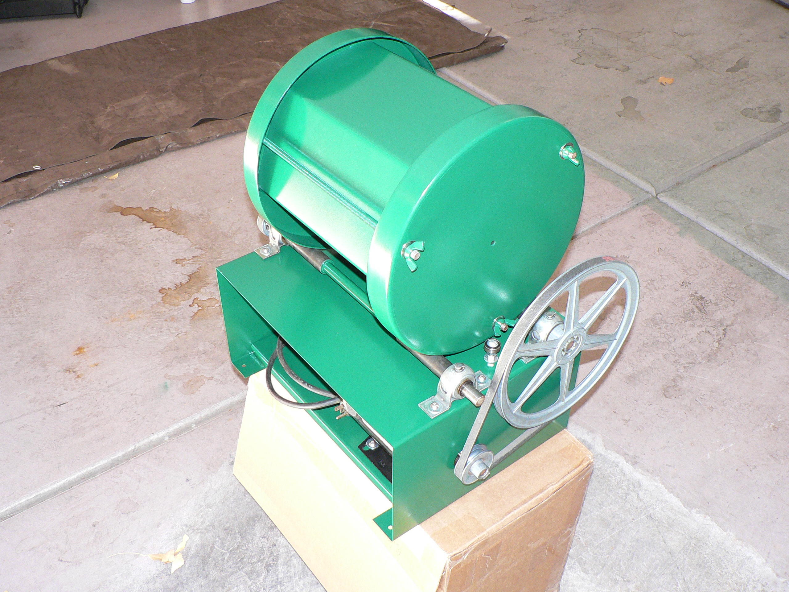

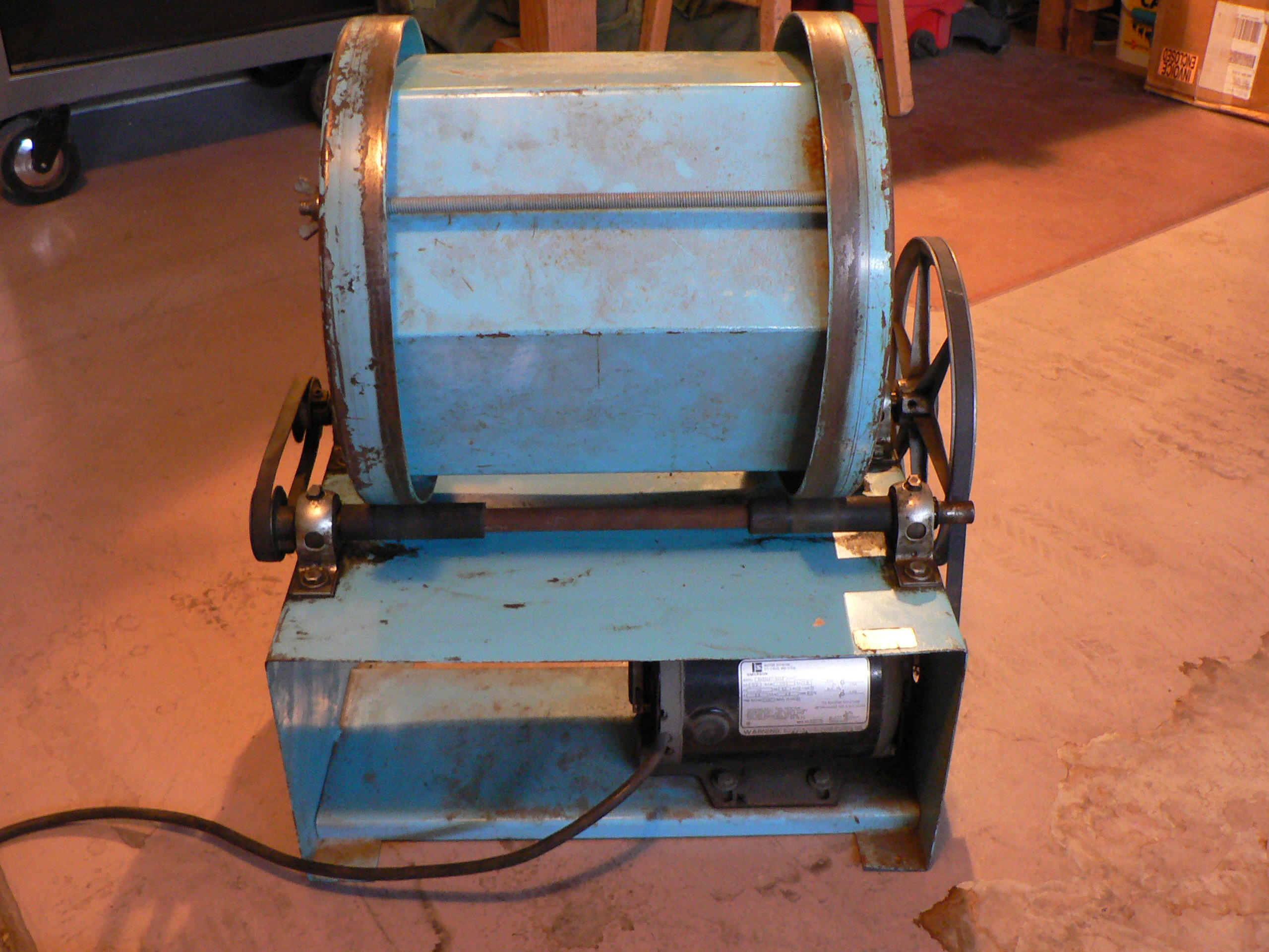

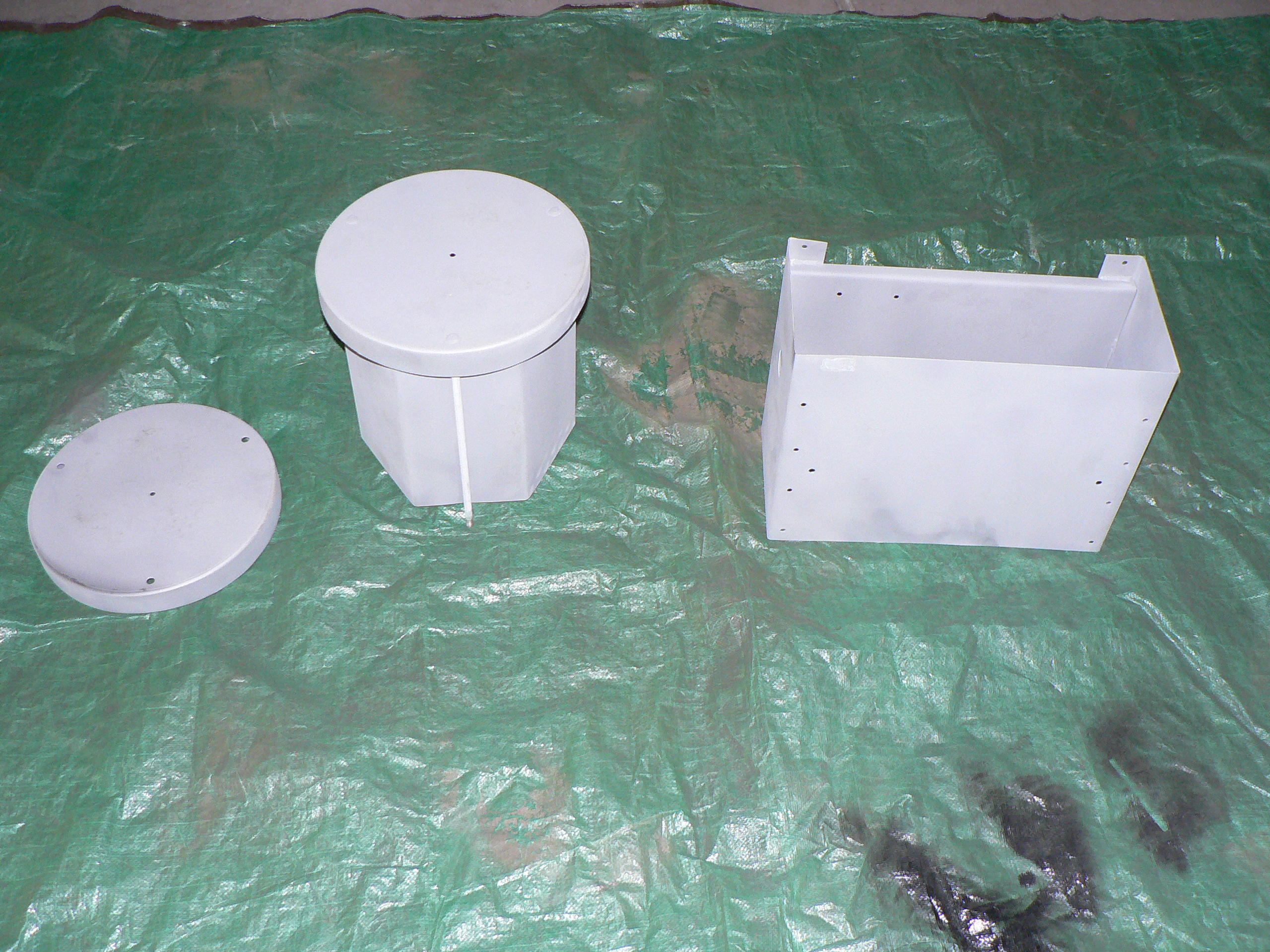

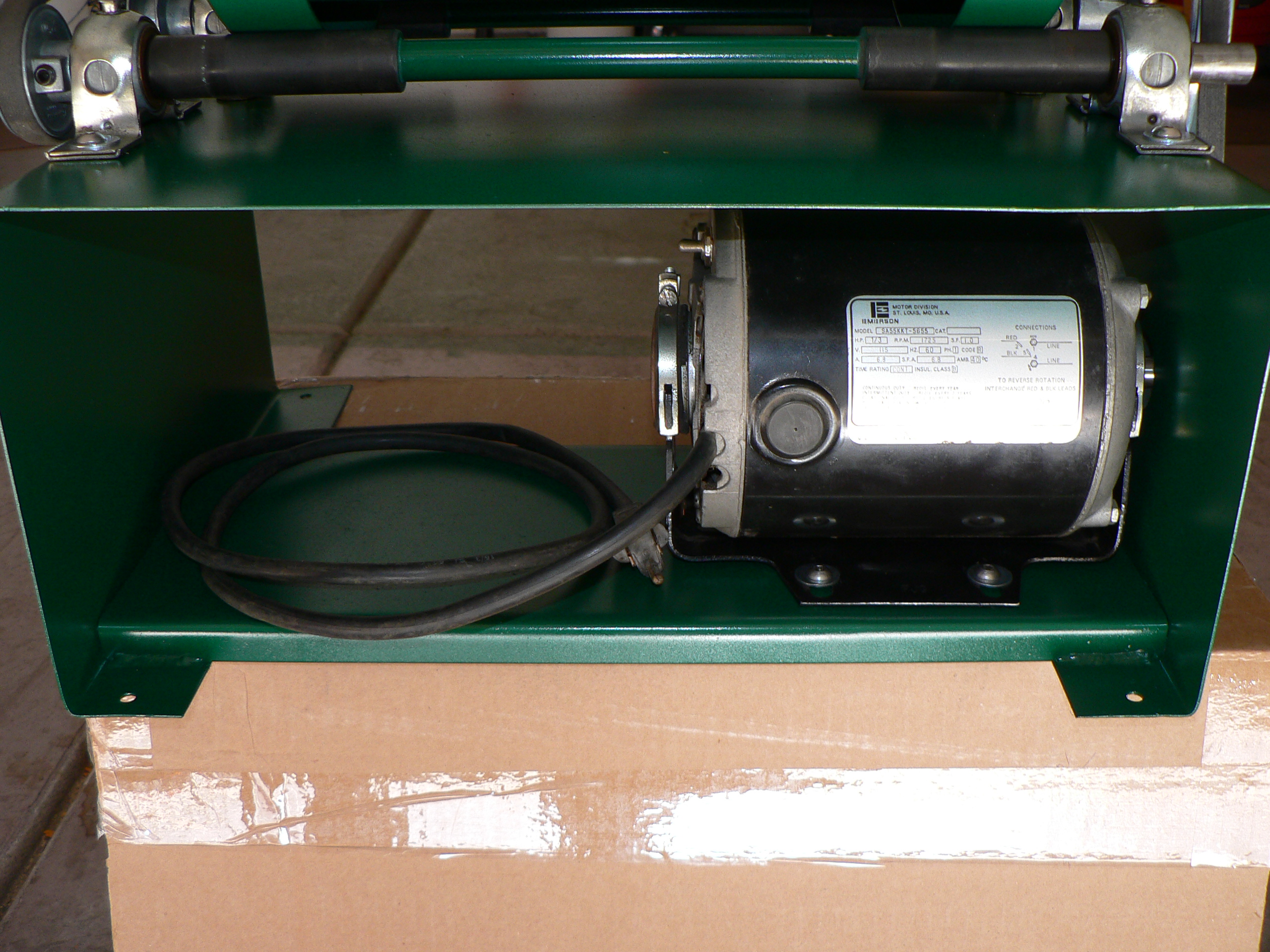

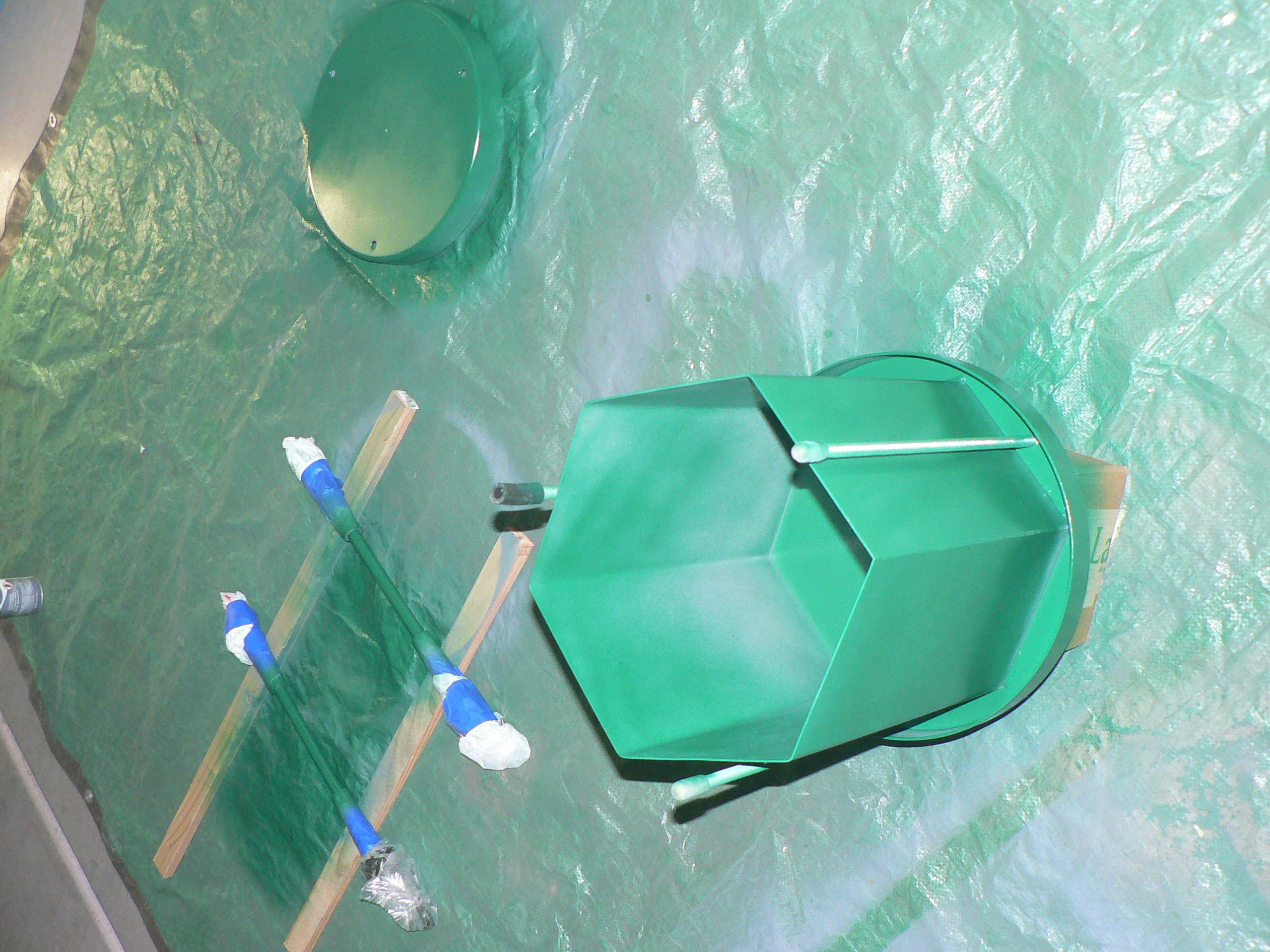

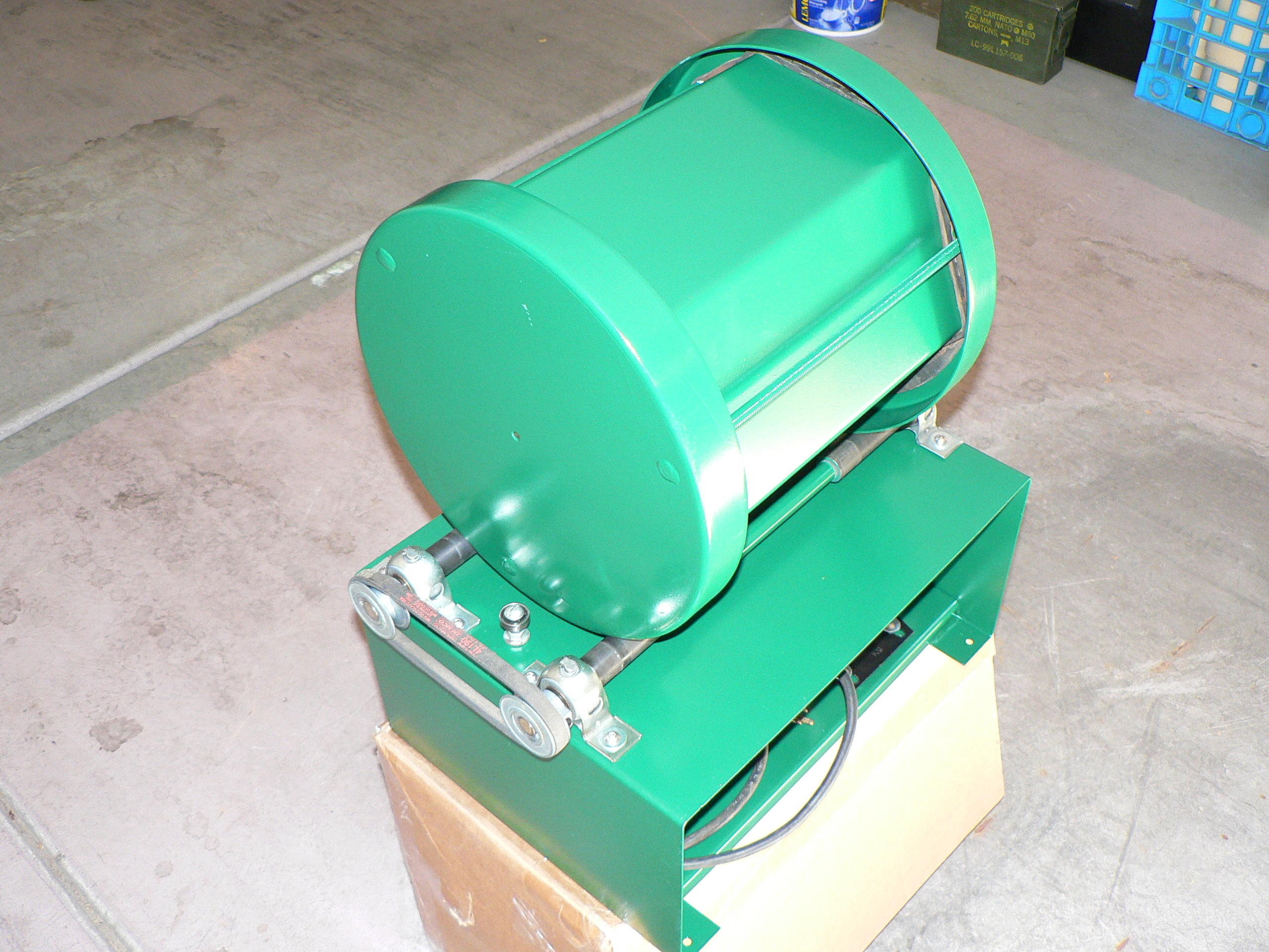

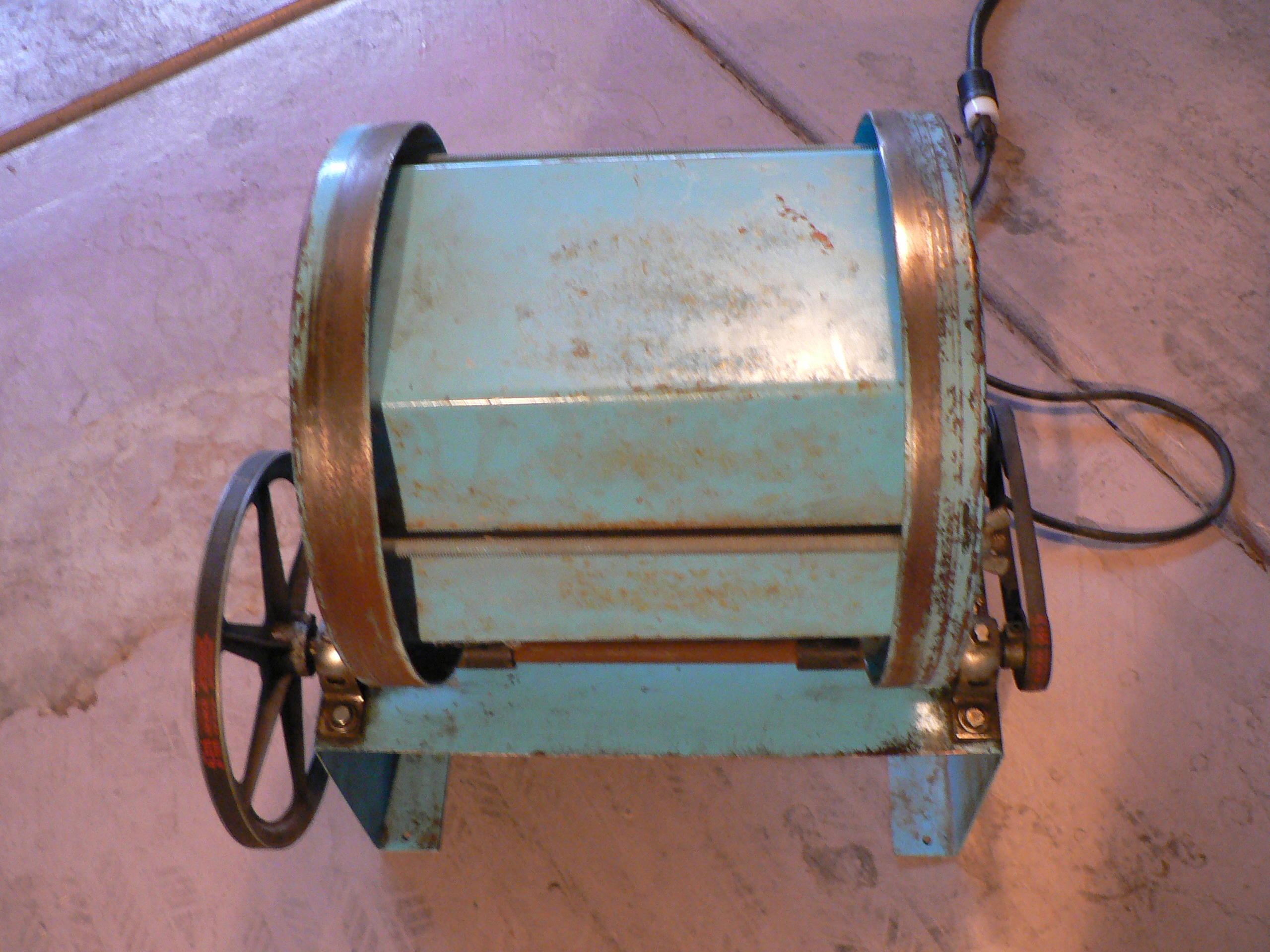

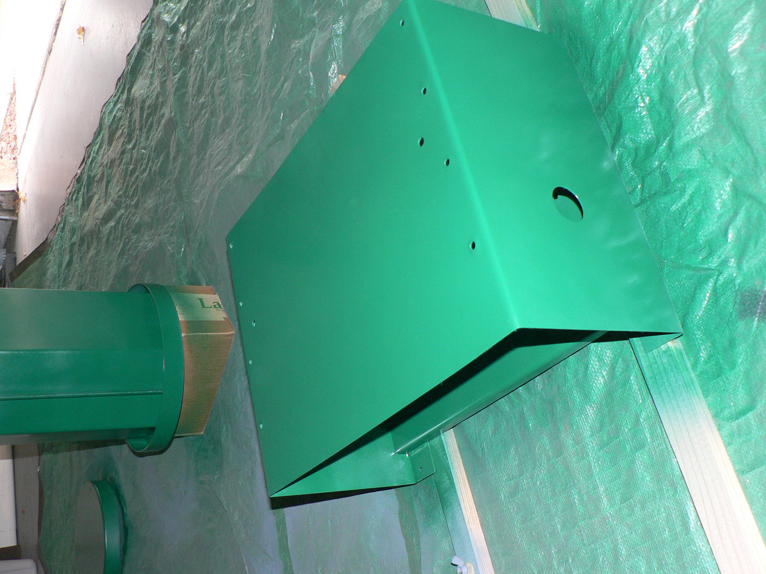

When I switched to wet tumbling I looked at the Thumlers. I wanted to do really big batches of brass, 1,000 5.56, 500 7.62, 1,500 9/40/45. I looked around and found Lortone tumblers. Next stop was eBay where I found a used 40lb. capacity C40 for $275 including shipping. It was in rough shape but worked great. Had it blasted and then I repainted it. I use 15lbs of SS pins, a squirt of dish soap, a pinch of Lemishine, and around 2 gallons of water. The biggest problem is seperating the large amount of brass and pins in an efficient manner, which is the next project on my list.

Here's some before and after blasting.
