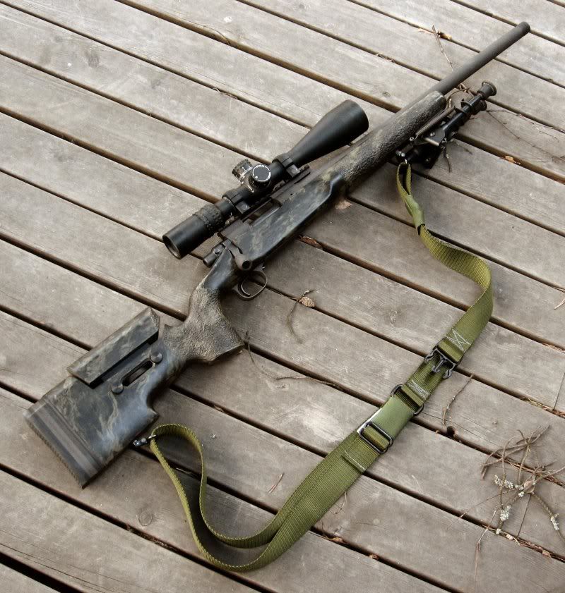

Ok my next build is going to look similar to these rifles. One is a Chandler M40. IBA's site says "Hart #7" but Hart's website doesn't give any info on the size of a #7. Basically I'm wanting to know what the type of contours are on these barrels.
Thanks guys
Re: Help with my next build!!
<div class="ubbcode-block"><div class="ubbcode-header">Originally Posted By: dagger</div><div class="ubbcode-body">The barrel taper is the Hart Regular HV taper. (1.200" for 4" x .913 at 26") </div></div>
I'm not doubting you but it looks a bit smaller than a .913.
Maybe my eyes are messed up. I have a MTU contour thats 24'' and it seems it would looks larger if it was 20''
