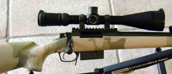

I have a Non-Zero Stop 5.5-22x56 NXS with .25 MOA Turret adjustments (Model C231).
It’s mounted on a GAP 308 bolt rifle with a 20 MOA base.
When I zero the rifle at 100 yards, the rotation indicator line is at “4” (indicating 4 rotations from the bottom).
Is there a way to adjust this particular scope so that the rotation line is at the bottom with a 100 yard zero?
I have attached a couple of pictures for reference. When the outer cap is removed, there appear to be only two possible adjustment points.
Any advice will be appreciated!

No, that isn't adjustable. After you zero, where it is is where it is. I used to infil the lines with a paint pen so I only saw one line when at zero. Seeing no line clued me in that I dialed under zero, seeing 2 lines meant I'm in the second Rev, etc...
