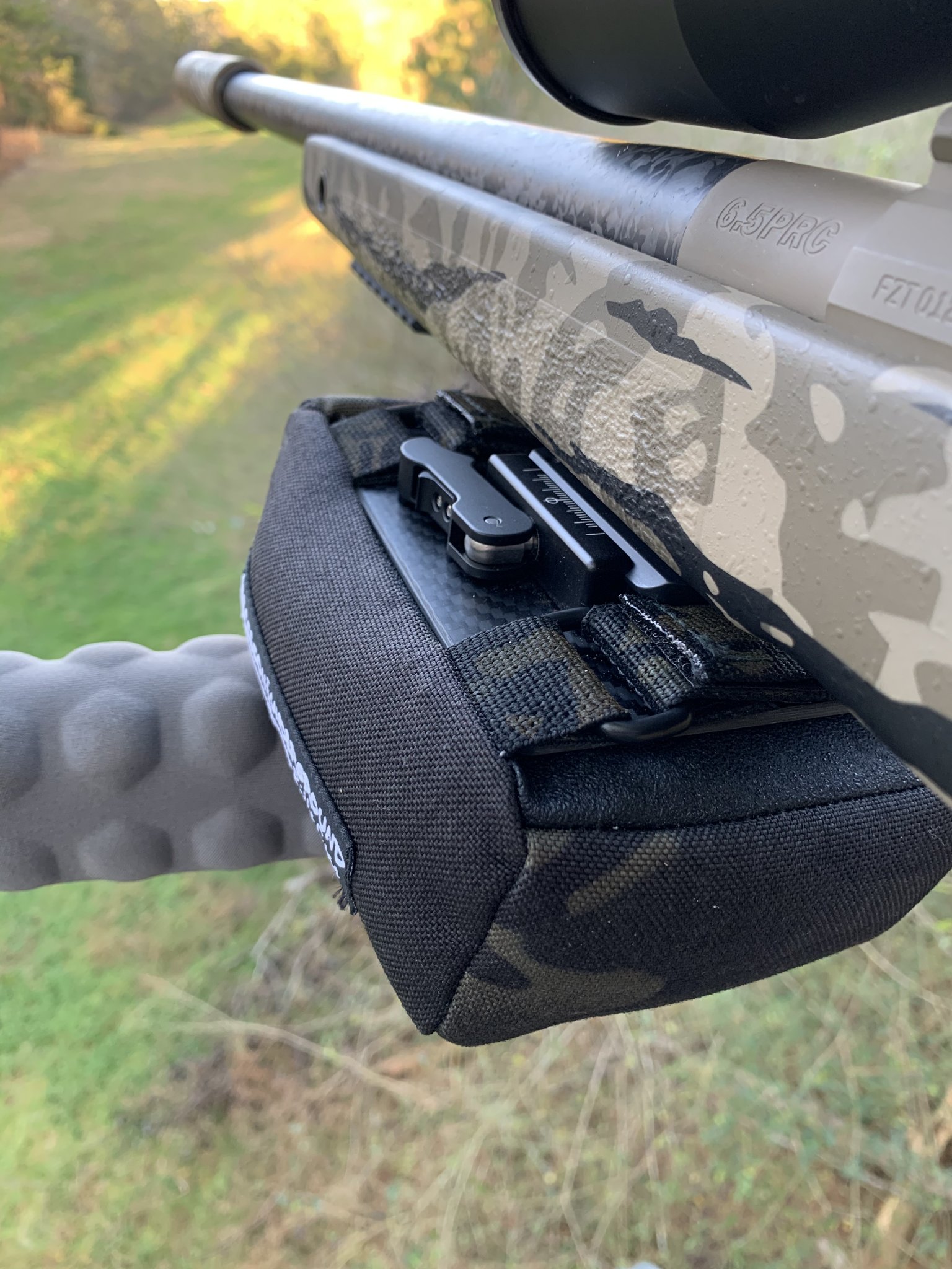

I used a Hog Saddle for the first time hunting this fall. It worked well with how I had it set up especially with my rifles that don’t have a dedicated rail. However, I must admit that I need some more practice shooting off the tripod setup. I have an Ingenuity Gunworks Adjustarail on my A5 stock with my Vudoo; with that setup I have an Arca-Swiss adapter which I used with an Arca Swiss monoball. That configuration works well but is heavy. It also allows me to mount up the Hog Saddle but again heavy. I will fix this in due time but I think the Hog Saddle has its place.
