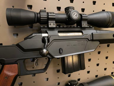

Rifle - Ruger American 6.5 Creedmoor - Added a muzzle break.
Scope - Vortex Strike Eagle 2-25x56 in a Spur mount (not a cheap mount but it was all I had that would fit)

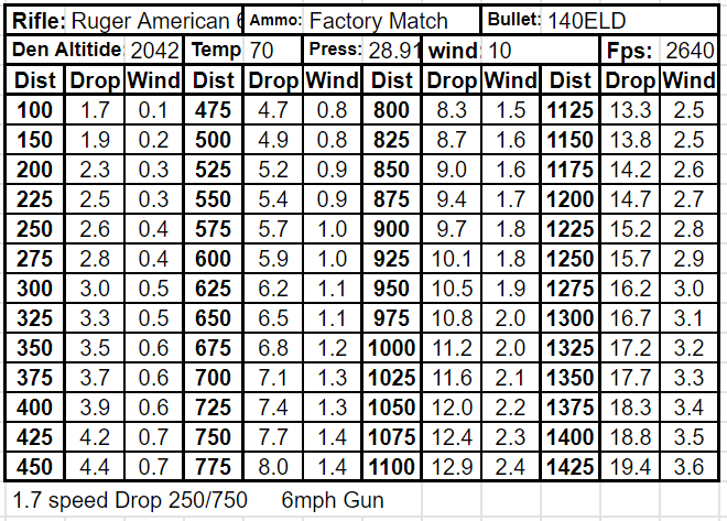

Arm Board Data
I retyped my arm board data to add 1.7 mils to each yardage. See the table below - 100yards = 1.7 mils. Hence the adding of 1.7 to everything. This way if I had a target at 1100 Yards I could still look it up in the armboard and dial what ever is says. 1100yards --> dial 12.9mils (Bang!)

IT WAS F'n AWESOME!! When on a stage all I had to do was range the target, write the distance down, then dial the scope. I didn't have to wait for the ballistics in the furry 5k to work, I didn't have to look up data, I didn't have to remember random numbers to dial too because the distance was right on my arm bar. 422yds - 4.2mils (BANG!) or 567yards 5.7mils (BANG!). This was the easiest, fastest, simplest way to shoot this match and I will 100% use it again. The entire match I had to look up data twice and that was because the targets were inside 225 yards. Really I could have held top of target and sent it but, at the top of my arm board I had written out [100-1.7--150-1.9--200-2.3--225-2.5] for the short range targets. After 250yards I knew the speed drop would work and all the way out to 775. For targets farther than 775yds I knew I would have to look at my arm bar and see what is says. I never had to shoot a target further then 775 so this was perfect. Speed Drop cut so much time out of the process, it was awesome!!
