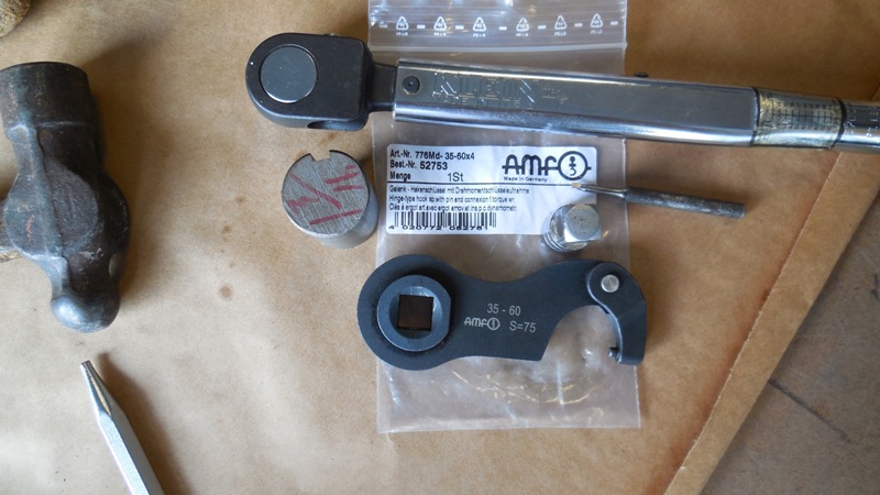

    Does anyone know of a manufacturer that makes a hook spanner insert for a stahlwille torque wrench?
    If not what do you all use for setting torque on a buffer tube nut. Specifically for an H&K but any info on any other would be appreciated.

    I can find hook spanners that will work but not with the cut out for the torque wrench. I need 60 newton meters or 44.25 foot pounds of torque. I like to do it by the book. Torque sometimes can seem arbitrary but if they call for 60 NM that's what I want to give them.

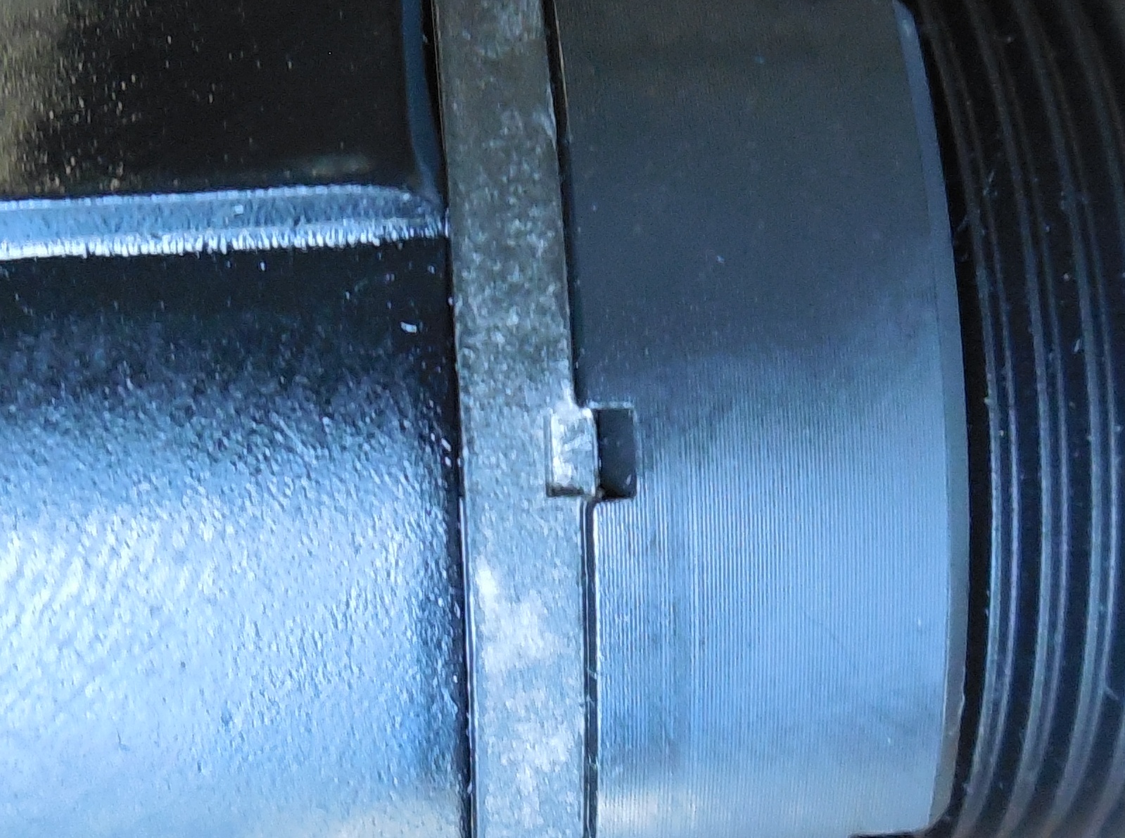

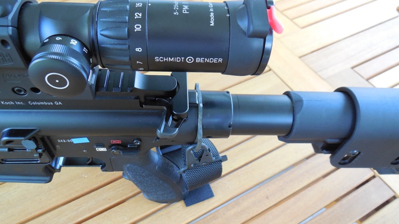

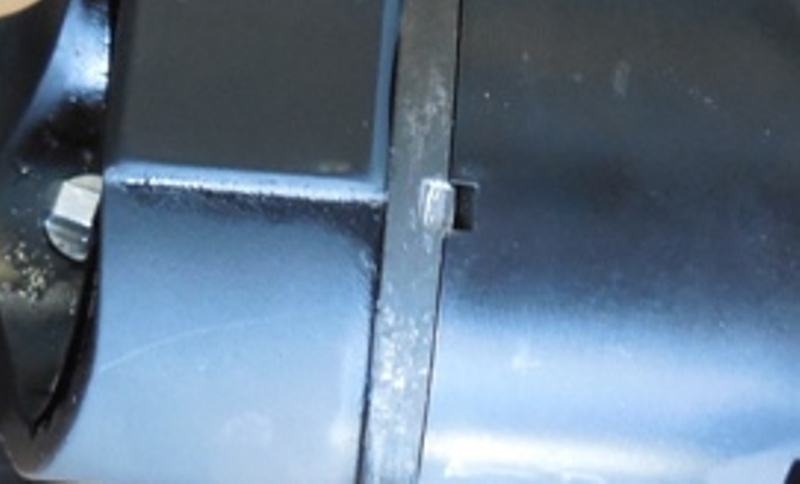

    If Anyone has a MR762 and wants to change the buffer tube to the g-28 style? This is how I did it. Constructive criticism welcome.
    Klein torque wrench
    adjustable hook spanner from samStagSales.
    30mmx40mm round stock cut from a 1 3/16 (30mm) shaft stock.

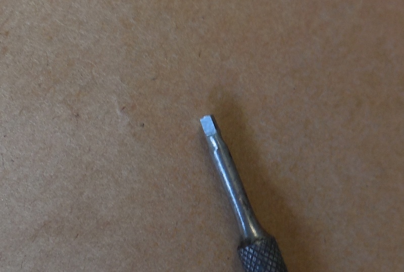

    Staking punch ground down on a bench grinder from and old broken 1/8 in punch. I think its about 3x1.5mm.
    Need to calculate the extension from the square drive center to center with the spanner. The set torque will be lower than the applied torque.
