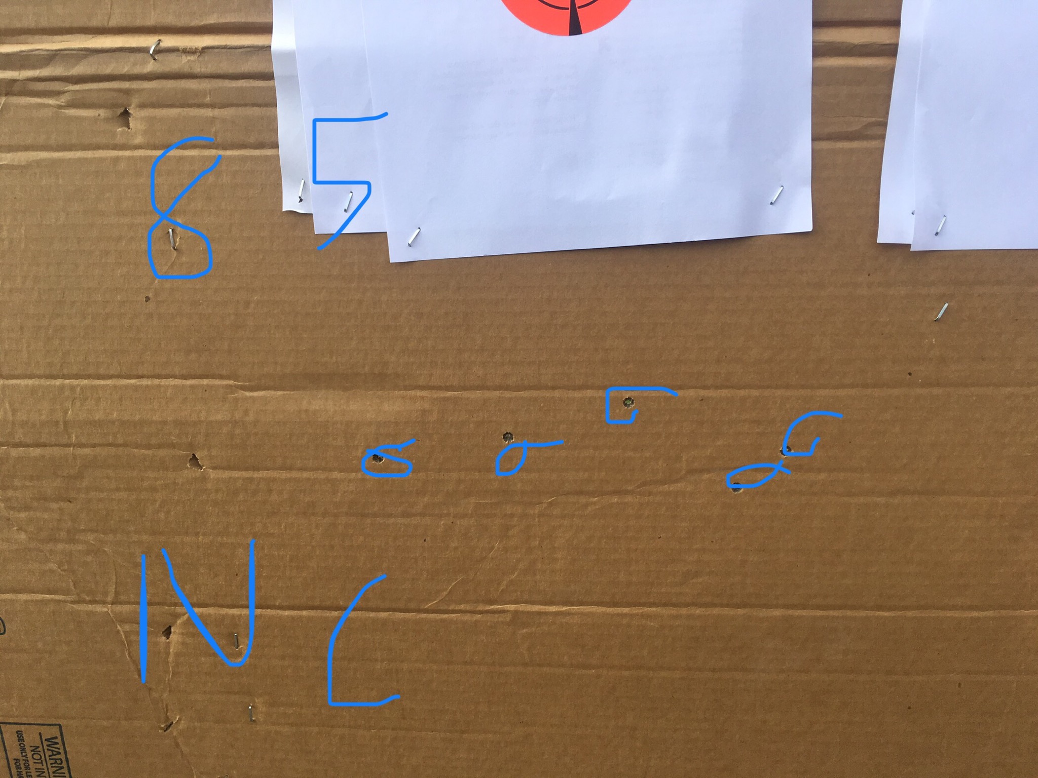

So I've been shooting at 400 yards the last few weekends. All my hand loads seem to string horizontal. Is it me or my loads? Velocity spreads should give vertical strings?
These are 85gr Speer soft point boat tails from my 243.
The orange dot is 3 inch
Seating depth would be where I’d start. Velocity seems pretty even.
I have a .243 and that is my favorite bullet. I've seen scope parallax issues do this. Not necessarily the scope, but the way you're looking down the tube.
Wind, trigger control, and scope sight picture are usually the culprits of horizonal shot groups. Sometimes position allows rifle to pull, but 1st 3 are more common. If those are not the issue, scope screw tightness or God forbid, bad scope... Hope it all works out for you next range day.

I will do this. I think its me. I'm new to shooting past 200 yards.
You didn't give shit for information on rifle or optics specs but it looks to me like a shortfall in fundamentals.
Its an old Remington sportsman 78 .243. Heavier then a sporting barrel but not a target barrel. The scope is a borrowed Falcon FFP 5.5-25.
I also think its me. That's why I asked. Its just a little odd that I don't get the horizontal strings with factory ammo.
The wind was almost zero, and I'm shooting next to a wood line that blocks what wind there is. Trying to shoot when there is no wind because I'm trying to work up loads.
My groups will all loads are fine for hogs and coyotes but need to tighten things up if I want to go shoot a match.

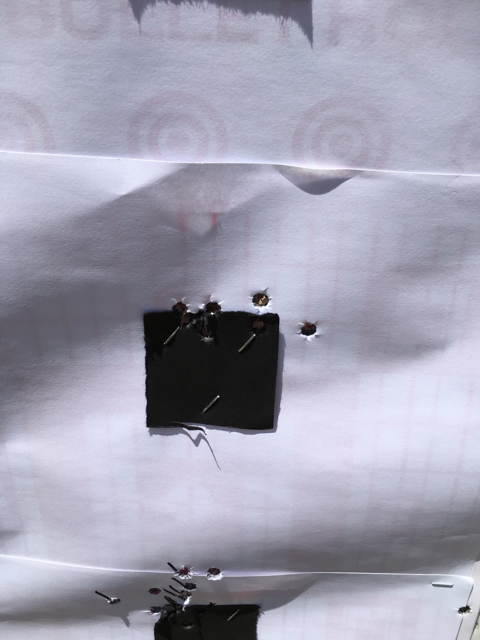

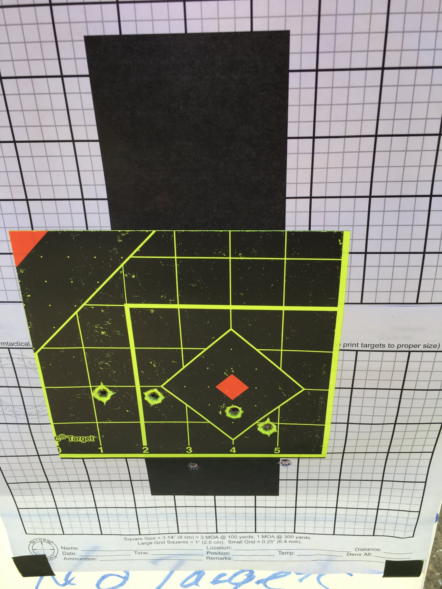

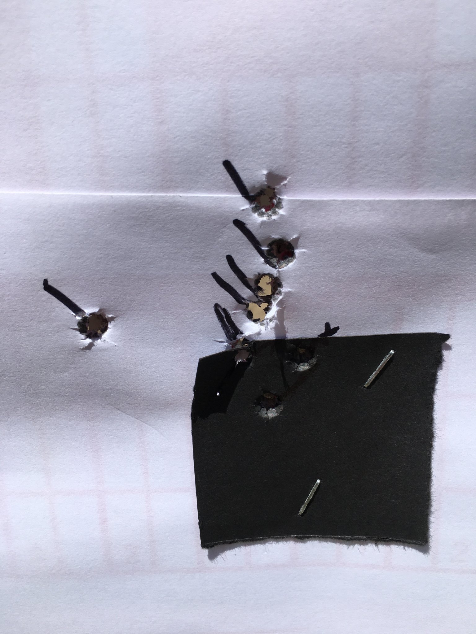

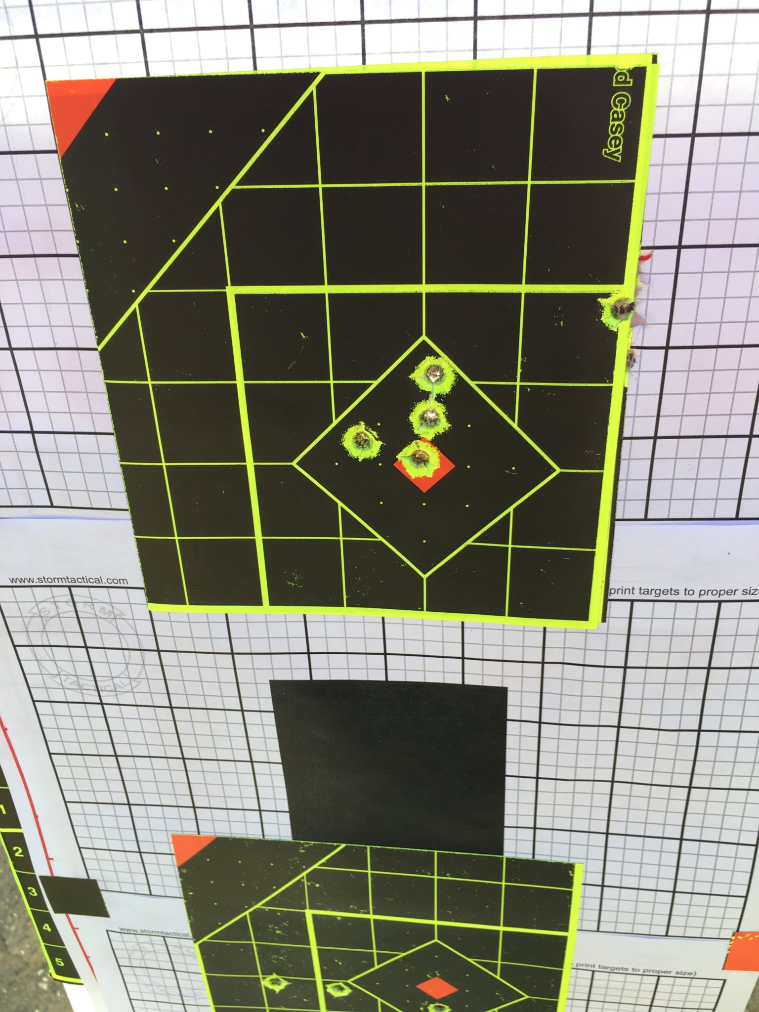

I experienced similar stringing recently. My personal diagnosis is a weakness in my shooting. The attached photos are from the same day. I was using a tripod as a barricade w/ a sandbag resting on it. @ 300 yards, high double kneeling. The black squares have 8 shots each, with breaking/re-establishing
position every two shots. Same on the shoot n see except of course only 4 shots. The only difference between the targets is one was above/below the the. That slight change in position resulted in the change in stringing. I think the vertical is due to not shooting at the same point in my breath pause. The horizontal could be trigger pull.

Fundamentally speaking, if this is a shooter issue, it’s too little/tapping/pushing trigger finger (if it’s stringing to the right on right handed shooter) or a natural point of aim issue. The NPA is off horizontally with shooter muscling it back and as shot is breaking body relaxes and rifle returns to NPA.
