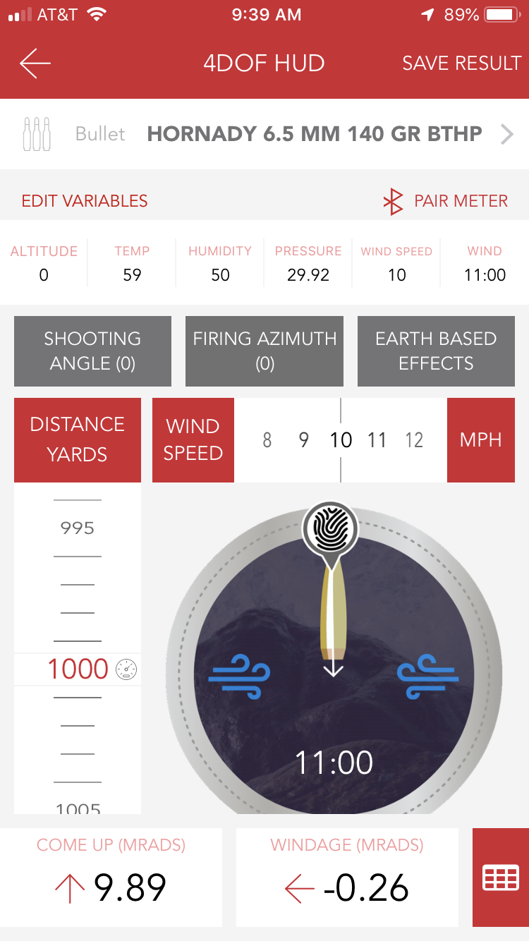

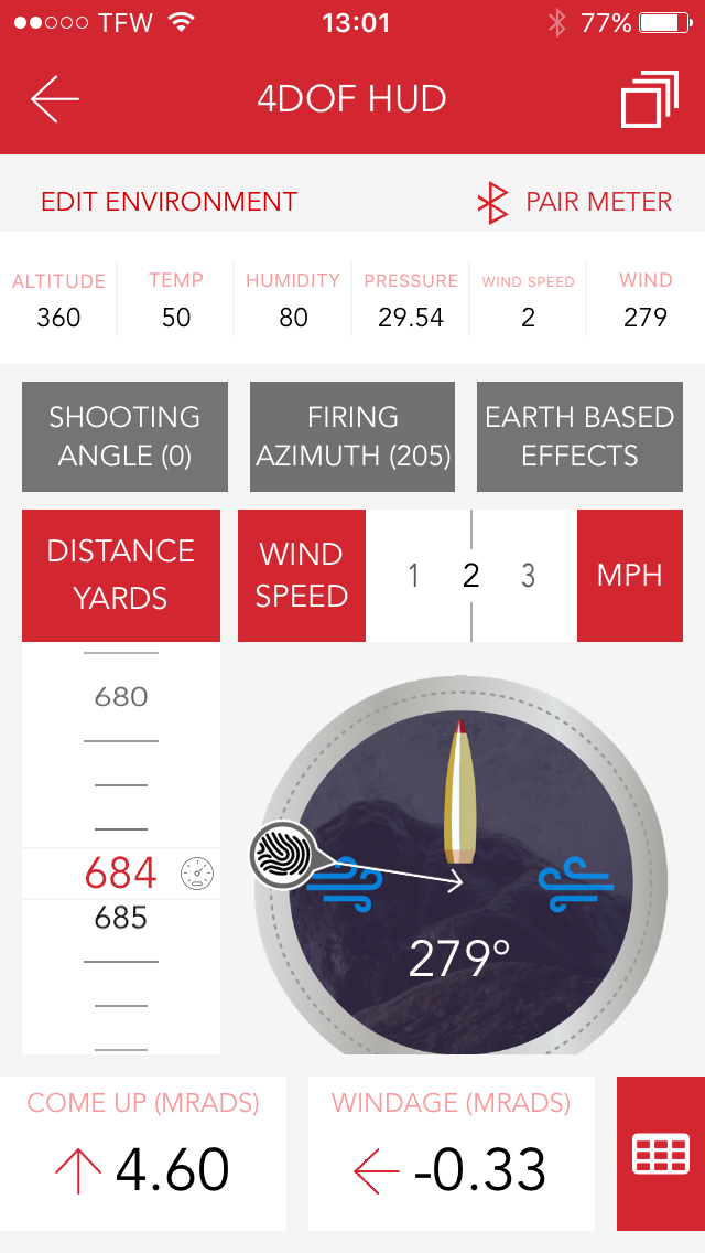

i think i tend to agree with you. i havent used it at the range yet, just messing with it and comparing to AB. there are some big differences between those two so i will be interested to see what actually happens. i think the interface needs some work, navigating it is kind of a PITA. and for sure they need to fix the wind stuff. They should be referncing clock positions not degrees. it could be confusing.
Haven’t read every thread yet as Im just getting started on this. I just recently downloaded it and they now have an option to use a clock for wind vs degrees. The option is in the settings. If this has already been said sorry.
Have always had the option for wind clock on the app. They don't on the site

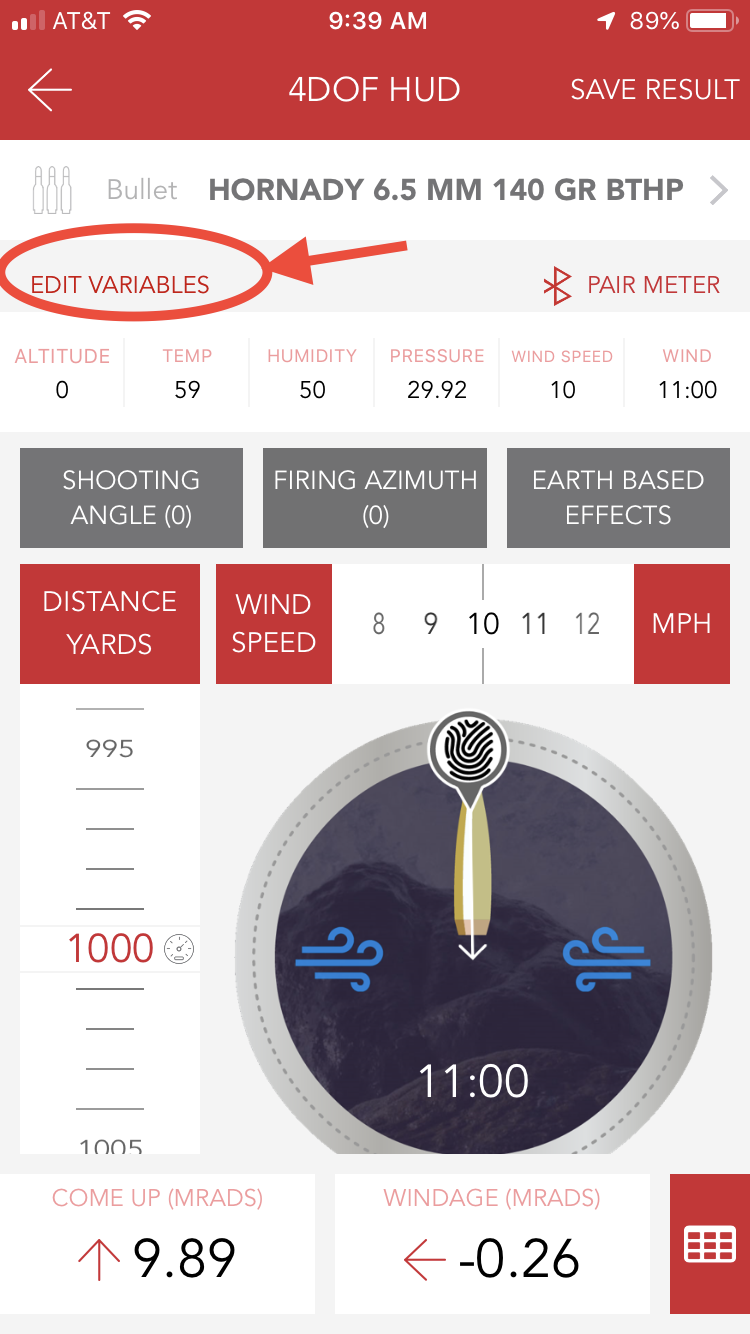

How do you enter atmospherics without a kestrel? I can’t figure out how to enter in manually.

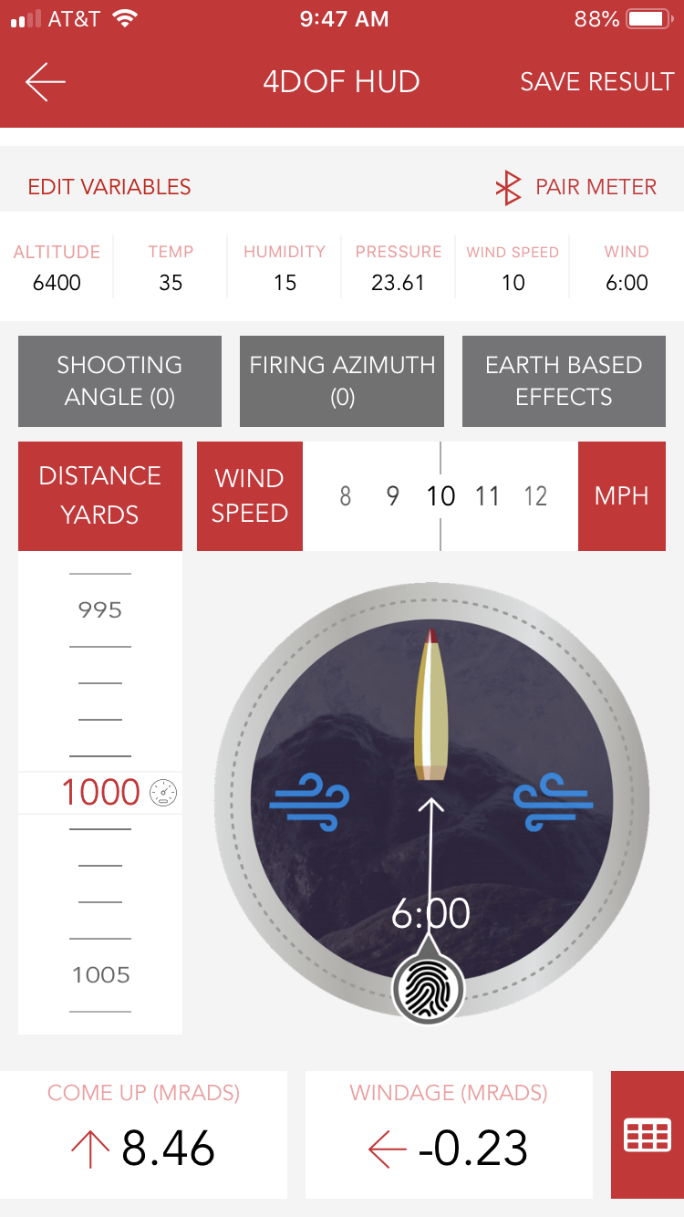

Is there a way to manually input da? If not is there a reason environmentals entered pressure, altitude etc would be more accurate than da and temp?

Using the BC calculator in the app (not the 4DOF) because my bullet isn’t in the library, I’ve input my BC and and am gonna do some shooting to true it up but am wondering about the zero range input in the BC calculator. It doesn’t have the zero angle or compensate for zero offset like the 4DOF.
Should I just be trying to estimate my zero yardage based on my offset? For example say my zero is a 1/4” high at 100 yards.
Or I guess just get as close to true zero as I can and not worry about whatever difference the offset makes and it’ll come out in the wash when I true the BC?

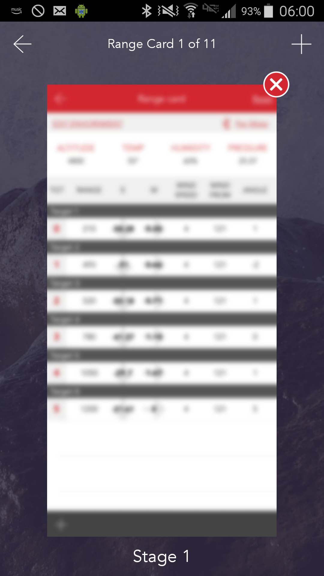

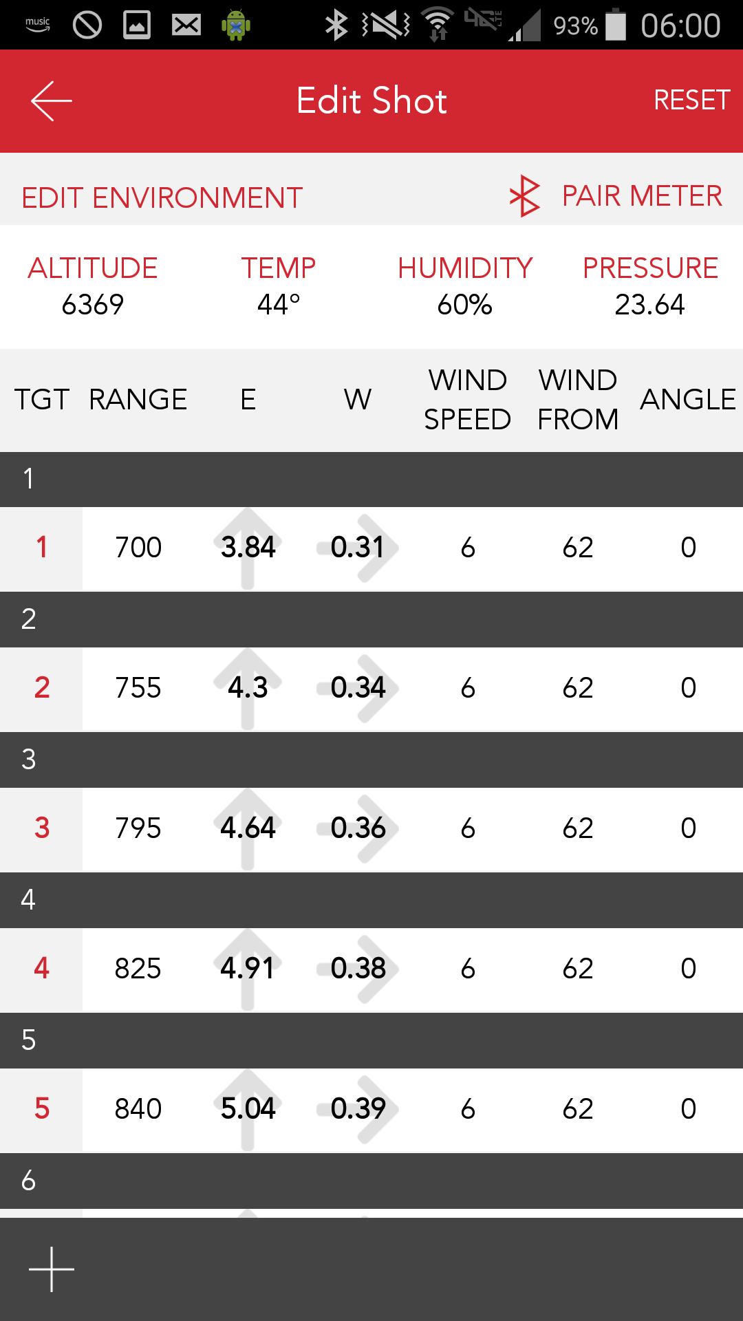

Agreed, range cards in the app are great. Don’t carry my phone to the line. Will roll OG with a pad and paper til a range card is available on the kestrel.
Range card
ETA - Now I understand what you meant....The Kestral does not have the range card.
I have my phone in my pack, and will use the saved range cards to fill out my little card that I hang off my scope before the stage. I shoot the same match every month, so my App range card rarely changes.
The Kestral has too small of a screen. The Kestral HUD however is better suited.
Range card

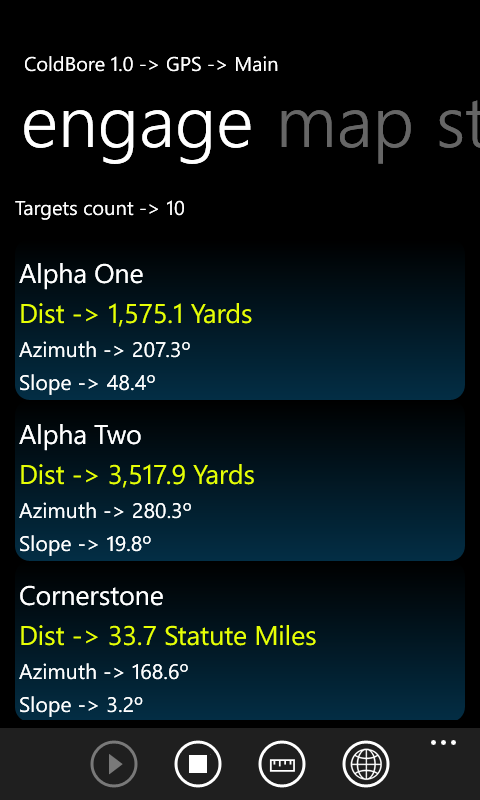

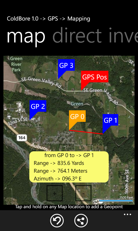

Looks like a dope table... a range card is a different animal where you add targets based on geolocation, and the onboard GPS calculates distances then the solver gets the solution.
