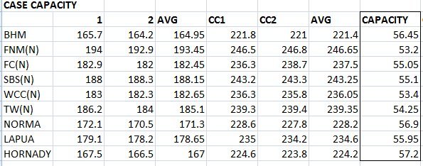

I guess I didn't have any Remington brass to check at the time, but Lapua versus Hornady on the lower two lines.
I am curious to here your results. I was using lapua switched to Hornady once fired factory brass to use it up. I had a few that had primer pockets so loose the primer would just fall out after 1 reload. I also have a 6.5CM and had the same issues with Hornady brass as I did with 308, not impressed. I am now going through my Silver State Armory once fired 308 brass I have collected.
