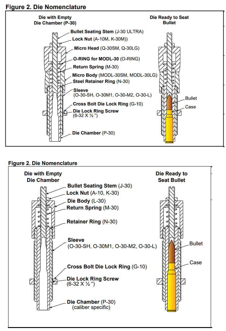

hi all.
Curious... the difference is the presence of the micrometer on the competition die.
when you buy a custom die set... and a micrometer separate.
the custom seating die has the "rough" seater at the top, with a little black "o-ring" below it, if you swop this unit out for the micrometer, do you still use the o-ring, can't imagine as it introduces possible flex that you don't want.

No, remove the o-ring.
The o-ring is to provide tension to the seater adjustment screw so that finer adjustments can be made and also act as a compression lock.
The micrometer has a spring inside that essentially does the job of that oring.

Hornady sells the custom die, which have the little threaded top holding the seating stem in place.
They then sell the computing for which is the exact same body, but the “little threaded top” replaced with a micrometer.
Not exactly an afterthought.

Also wanted to add - Add on micrometers to convert standard seater dies isn't a big deal and if manufactured properly, nothing would be wrong with the product from a functional perspective.
Forster is considered to be a great reloading die manufacturer and the major difference between their Standard Bench Rest Seater die and their Ultra micrometer seater die is the micrometer head. If Forster wanted to offer a micrometer upgrade for their standard Bench Rest seater die, they could (unfortunately they don't), as the sleeve that the micrometer head would screw onto is the same between the two product lines.
Even Whidden makes a micrometer top for their Simple Seater die.
