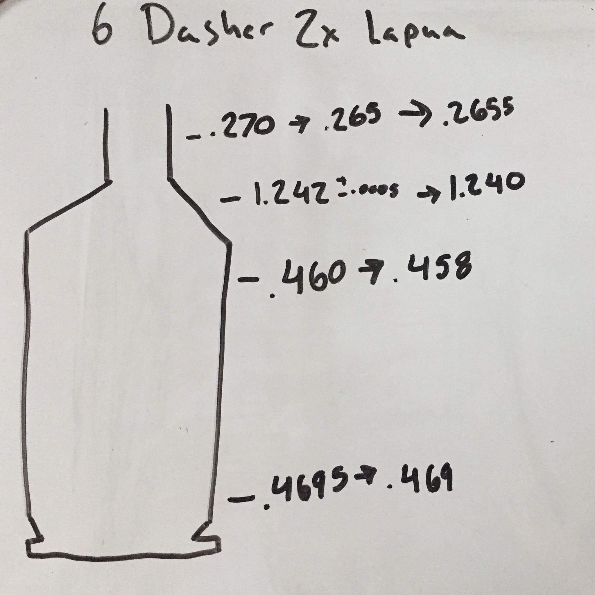

Make a chart like this for your brass to compare fired vs sized measurements to see what’s actually going on.

You want your shoulder bumped .001-.003 from fired length. You are working on having case head separations in a couple firings, because you are bumping the shoulders way too far.
The +/- on sami spec is more than .003. So just because a dies wont reach minimum SAMMI doest mean its not getting the brass inside SAMMI specs. But again we don't care SAMMI specs. We want our brass to fit our chamber, with .001-.003 shoulder clearance.
