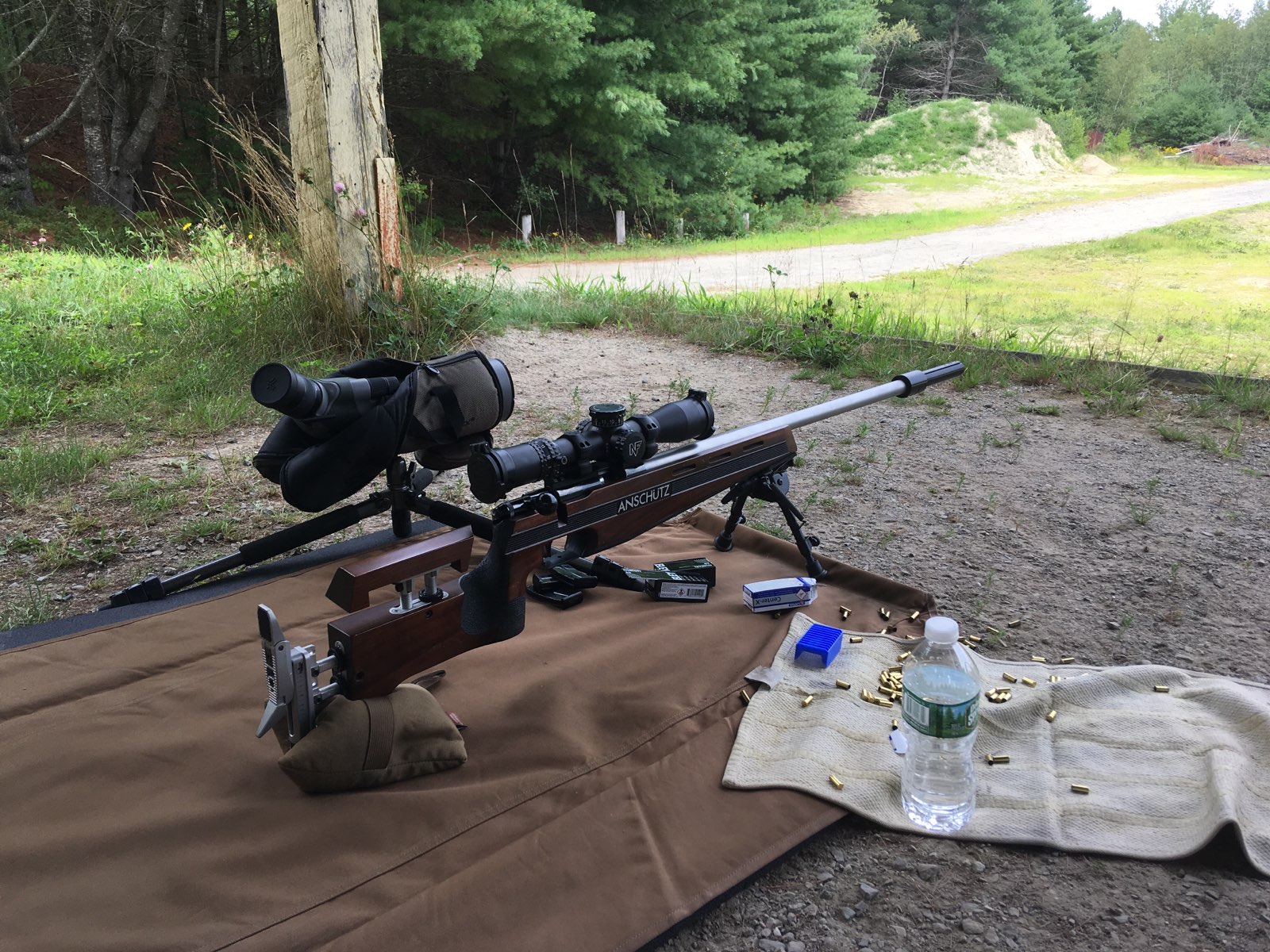

The rifle is an Anschutz 1827B that Mark Penrod installed a Benchmark 3 groove 1-15 twist 26" barrel, in a 1907 stock that I opened up for the magazine assembly. It is not bedded, just torqued to 35lbin. It has an ATACR F1 4-16X42 on it. The ammo is either Center X, Eley Match, or Eley Tenex. All targets are shot off a Harris bipod and a small TAB rear bag prone. Here is the rifle
