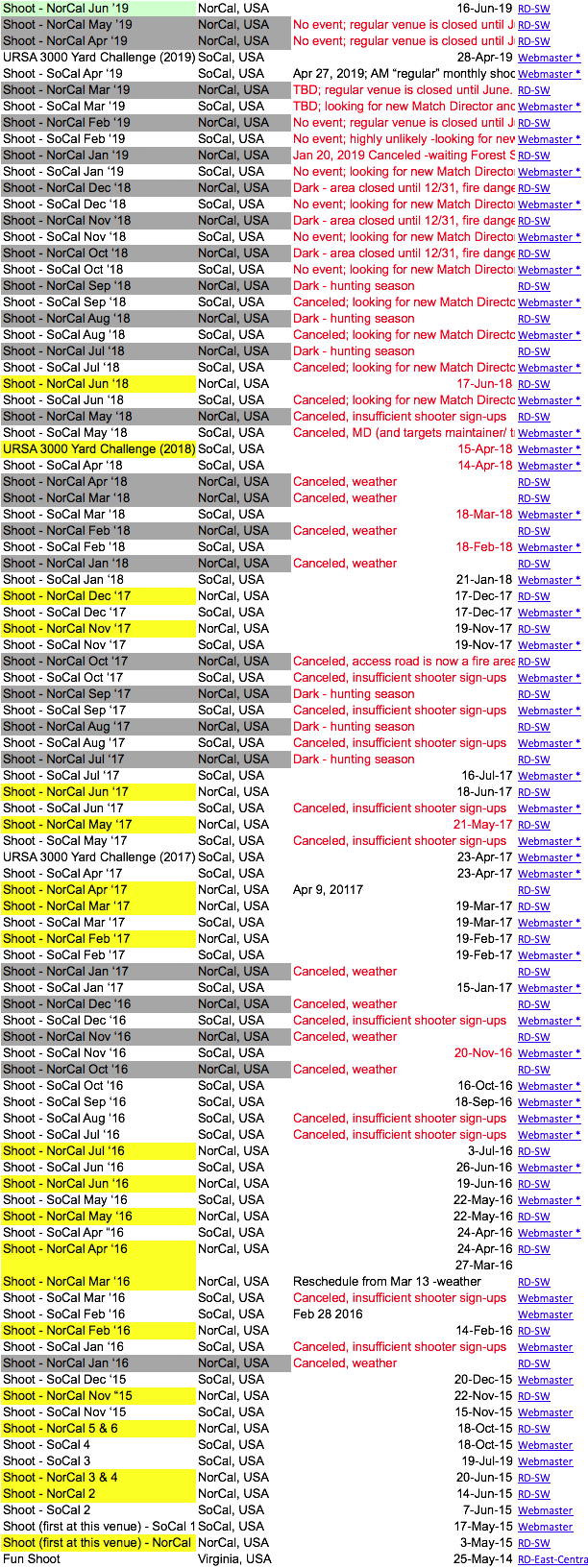

    I think it is kinda key to be on the level here. Oscar started this in 2014, with matches in 2015 ( I know this because he had location and target questions of me). You started doing this 2015 it would be very hard for you to actually put on 42 matches.. that seems like a stretch even for you, the fires and closures I remember canceling the shoots, seem to line up with the schedule and maybe overstated by a fair bit. I found about 20. Posted below and highlighted in yellow.
    Also lets put this into perspective the matches are very small and usually with a very small pool of shooters. I'm not saying 8 is typical, but it is not much more and it's not 40-200 like most of the guys on here think when talking about matches.
    From the 4-19 combined Norcal Socal event
    Those numbers were not the numbers of folks that actually showed up - there were 8 shooters
    I like Oscar because he is honest -

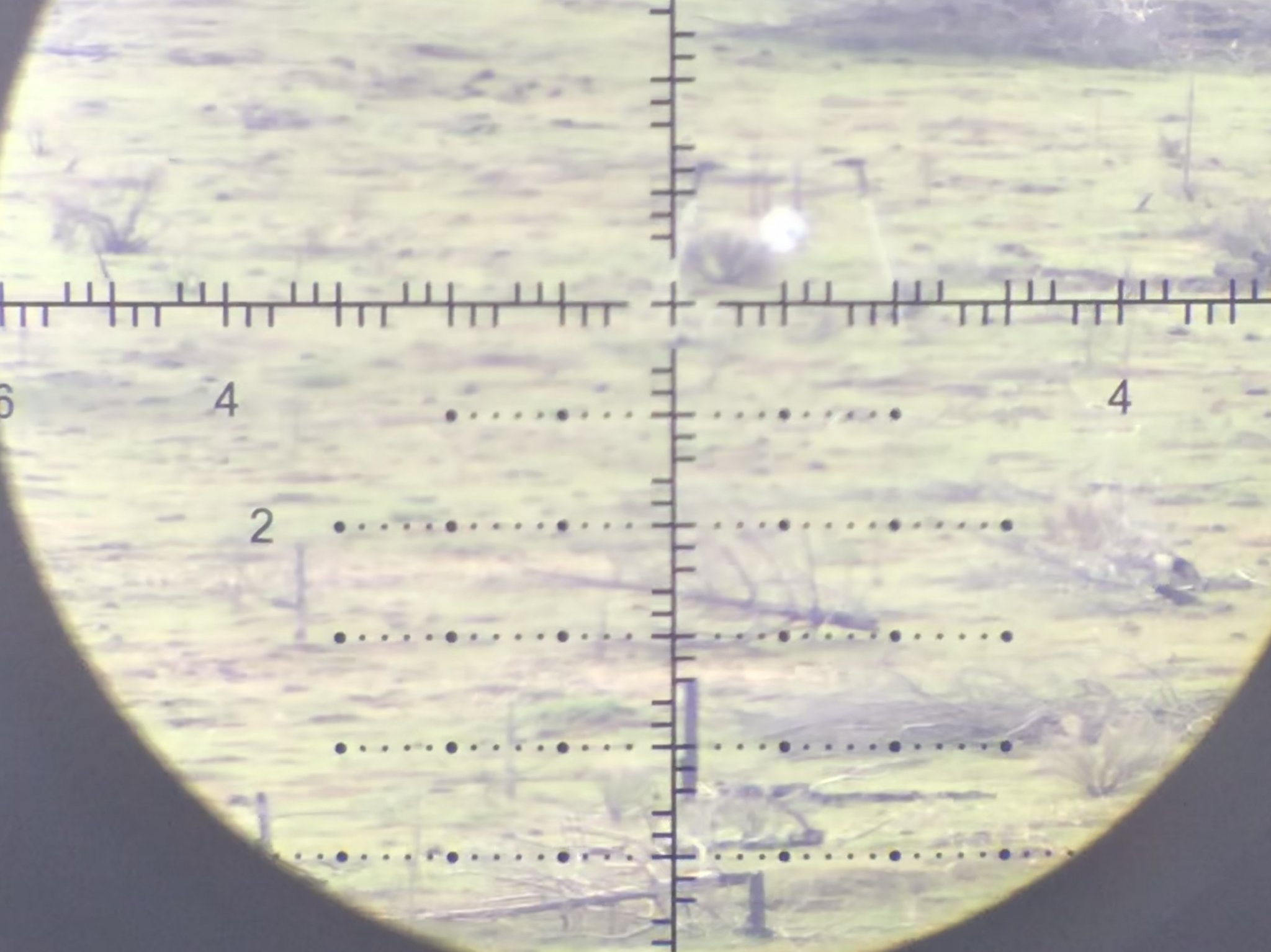

    My friends and I like to place steel at random distances and roughly range them using our rifle reticles then send shots.
    I could see SFP being having a place at extreme long range shots, say maybe 3000+ yards provided you know your reticle at various powers.
    This is a 16” target at I think over 1000 yards.
    Maybe 1100ish
    Not like the reticle is blocking much.

    I see your point but something like a MOAR-T or a specifically designed SFP reticle could Change that.
