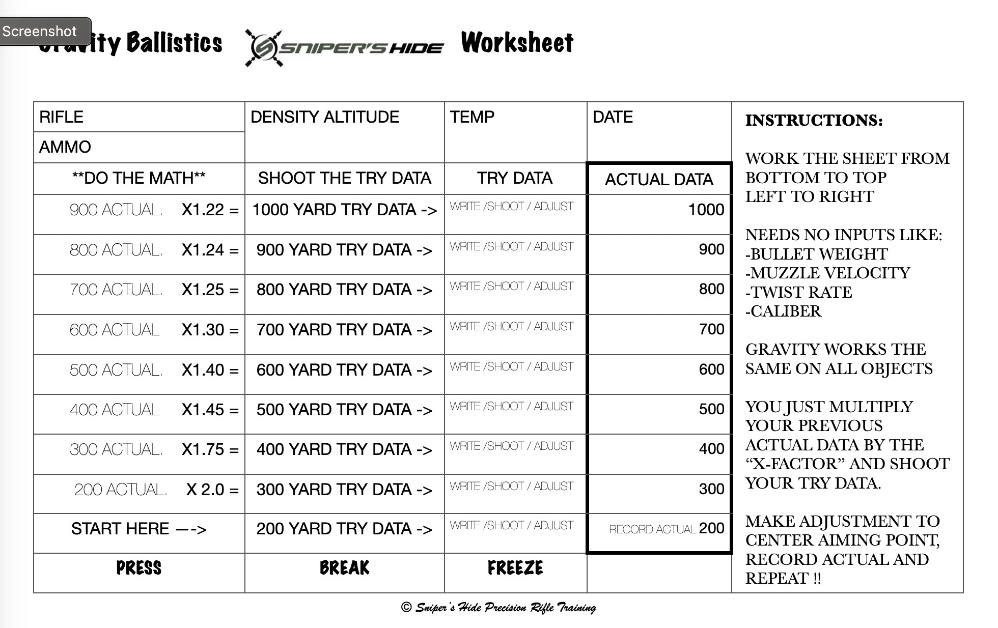

All software must be trued, they are almost never correct out of the gate, my recommendation is to use Gravity Ballistics to feed your solver after it has been doped.
A 6.5 at 600 yards is about 3.4 to 3.6 mils
But use Gravity Ballistics first, then add in the data to your solver it will work right
