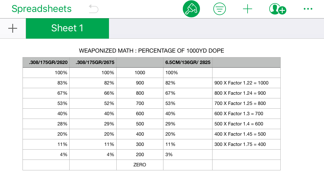

    Ever notice that the use if gravity does not require parameters like weight, or location on the globe? It does not vary.

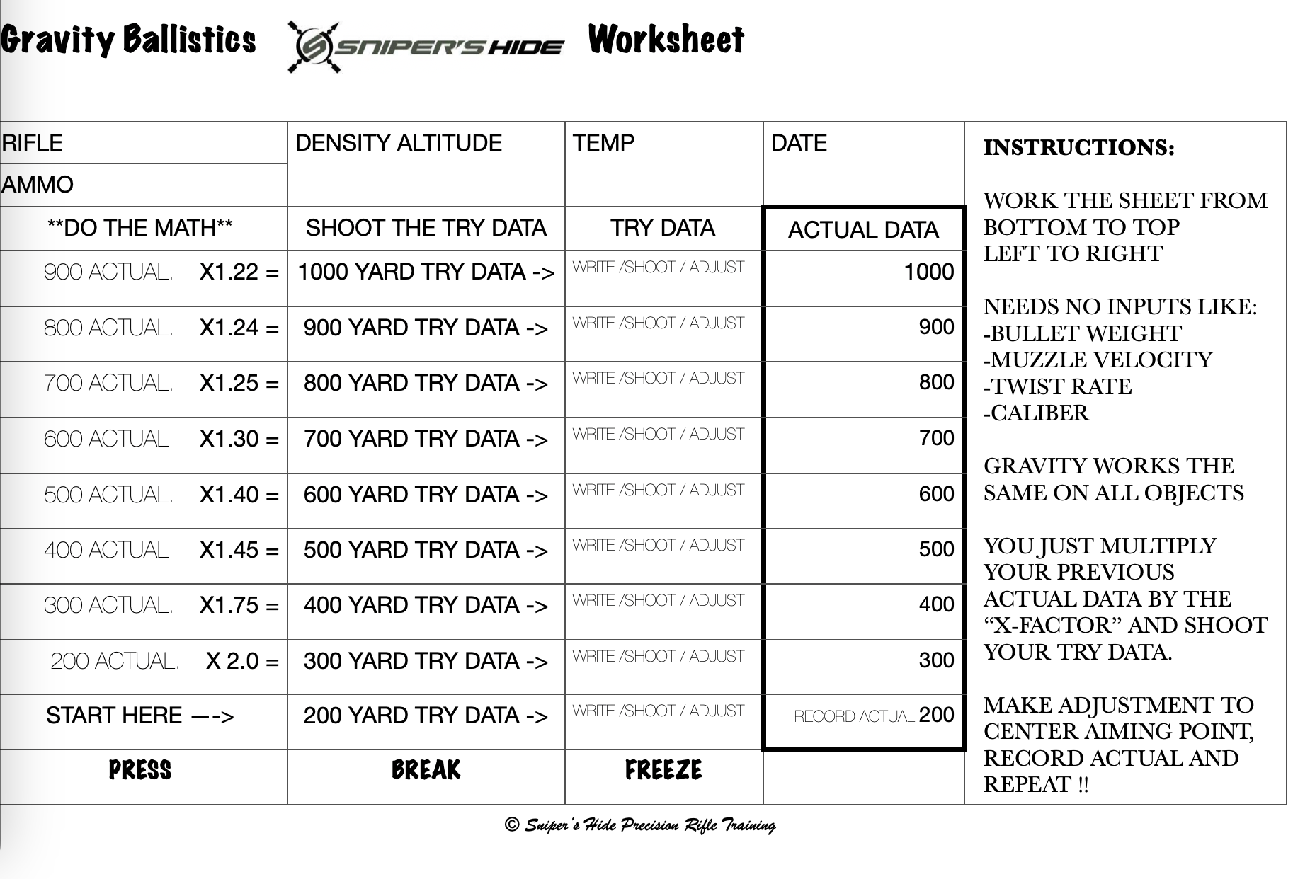

    Take this worksheet to the range with a .308 and a 6.5 CM and work from the bottom left of the sheet to the top right using unfamiliar ammo. The math will march you out as far as 1000 yards, perfectly, with hits for both rifles on or near the waterline (fundamentals and wind!)
    Clearly the .308 is moving slower than the CM, but it does not matter, they both use the same multiplier representing the drop. They will have different data, but the math will work for both.
    With the Gravity Ballistics Ap, you fill in your correct, tried and true 300-yard data based upon reality and the app will populate the remainder of the data card based upon that hit only until you add 400 yard data, then the app recalculates farther and closer ranges based upon that reality.
    It is very important that you are precise and do not base your entry on a small sample like one hit on the line. Shoot a follow-up or a group to pin down the precise elevation to a yard line before you move on.
    A large aiming point will yield a less precise data so AIM small-HIT small(!) and don't hesitate to refine to a half-tenth to make data reflect reality at farther ranges. There is quite a difference at the farther ranges' data when you refine to .15 at 300, or .95 instead of settling for 1.0 at 300 because you are close.
    REMEMBER -- GATHERING DATA IS A PROCESS, NOT AN EVENT.

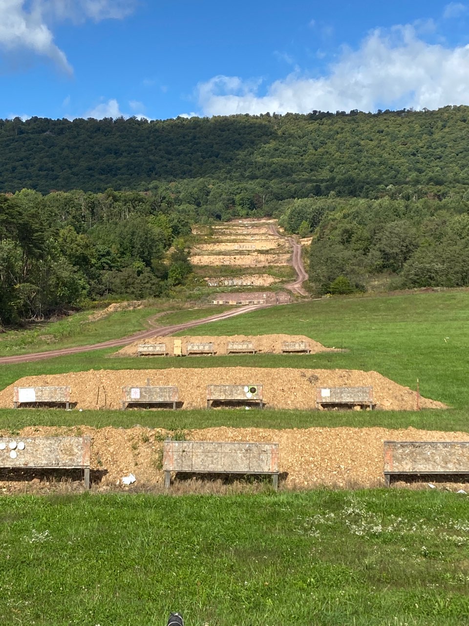

    At Mifflin County we had a steady increase in angle to 15 degrees at the 1K. I developed a sheet just for that range and it all worked out perfectly for each shooter.
    Reactions: Baron23
    Yes. But the multipliers are adhustable for that reason.
    is that all it was...15 degrees? I thought I was shooting up mount Everest at goats haha
