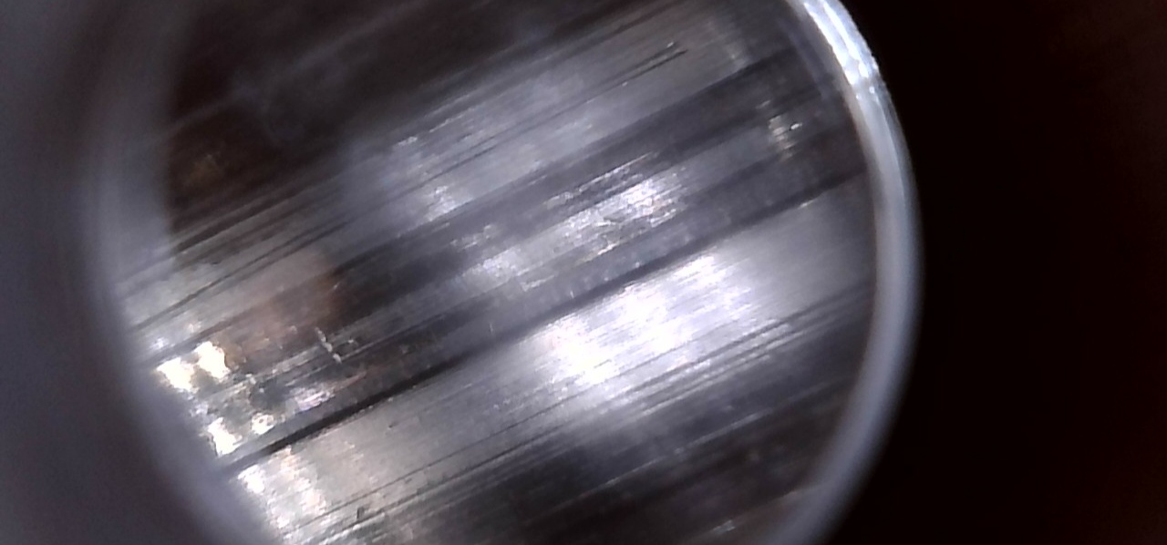

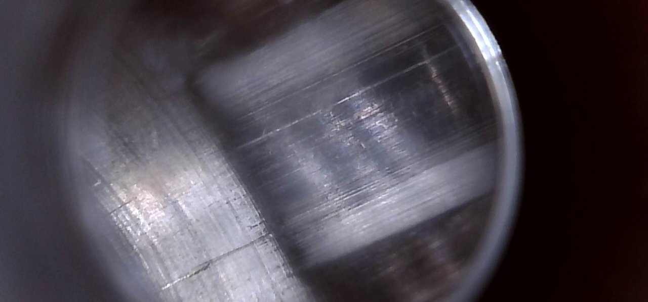

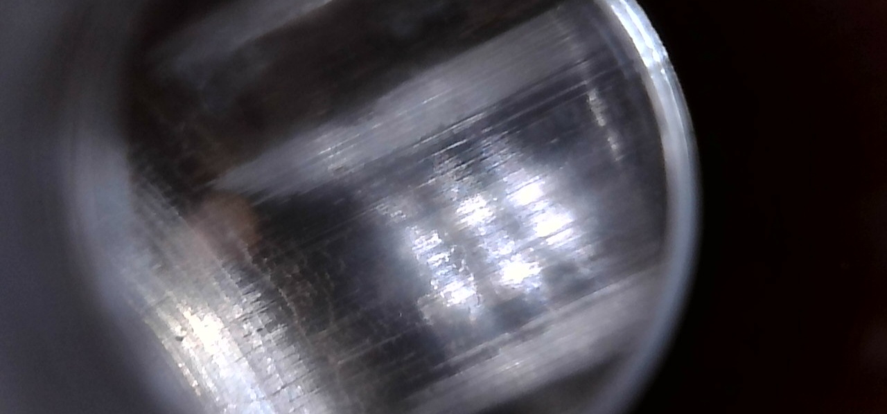

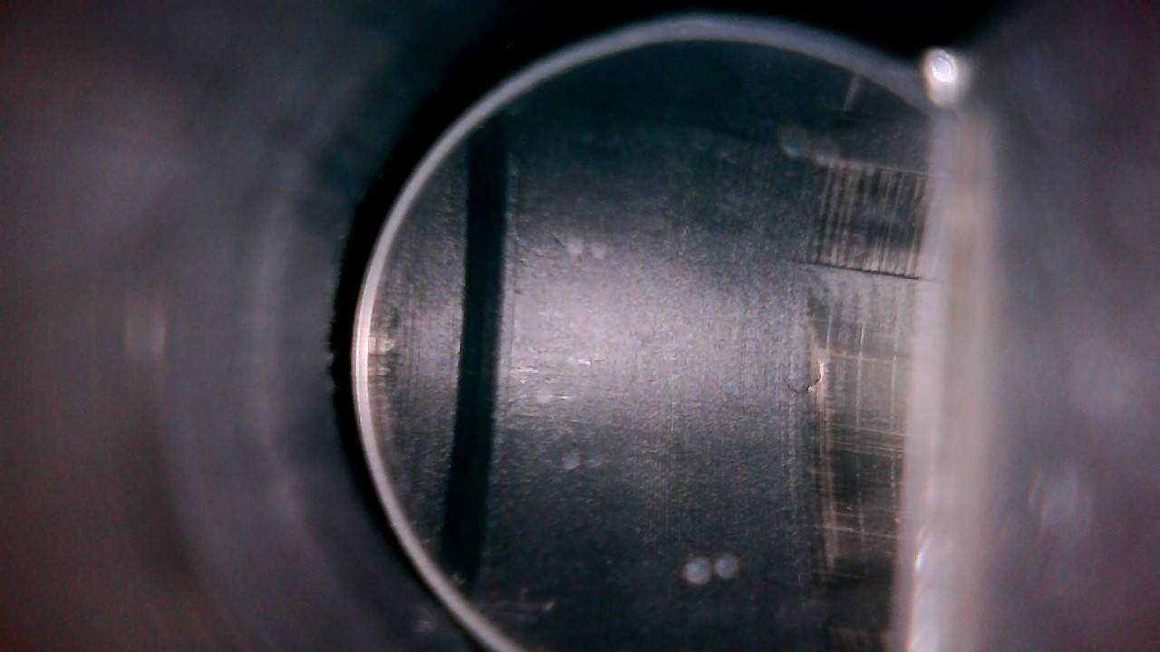

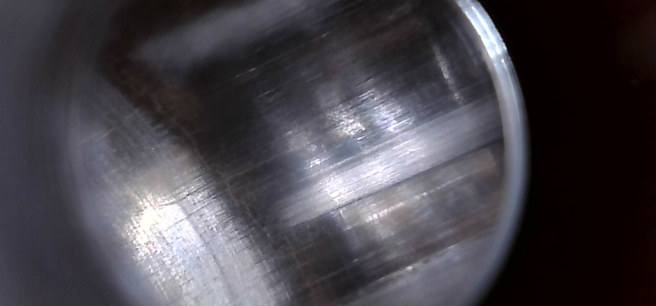

    What works for me is KG-1 Carbon remover, CLR - Calcium Lime Rust for the really stubborn carbon, and KG-12 copper remover. How do I determine whether or not a barrel is clean enough - I think of it in terms of estimated percentage and "crispness" and take into consideration barrel machining quality. Never experienced pressure issues and the results work well for me. Ultimately though, what is good enough is determined by your level of OCD and what side of the camp you fall under.

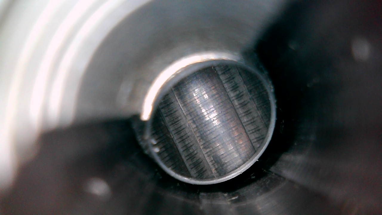

    Example #1 - 95% condition. Less than 1% carbon remaining, very little copper remaining. Edges of lands and grooves crisp and well defined. I won't spend the time to remove 100% of the copper. Most of the remaining copper is on the edges.

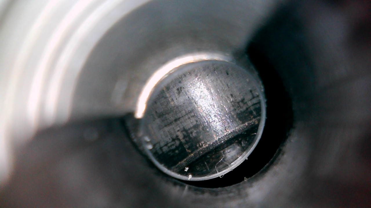

    Example #2 - 90% condition, edges of the lands and grooves are crisp and well defined. Very little carbon remaining, some copper remaining. Heavy deposits of copper and carbon removed. Some imperfections from machining but imperfections aren't large enough that I want more "fill".

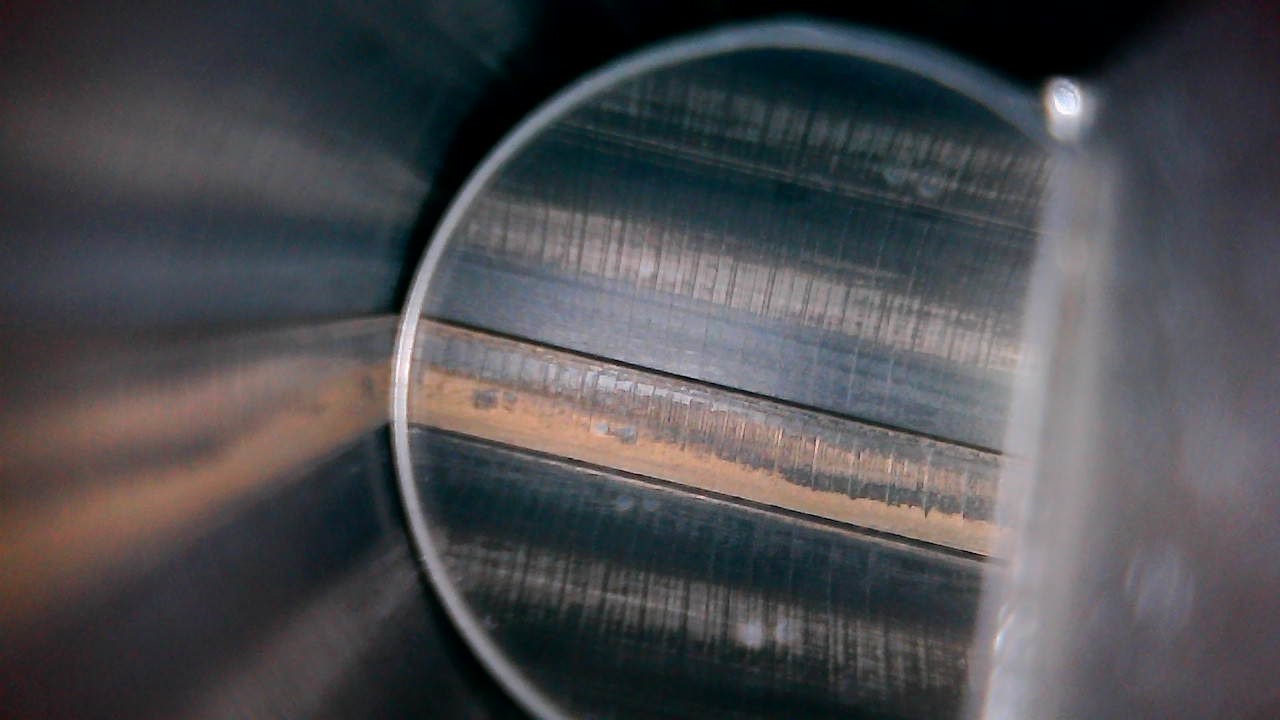

    Example #3 - 80-85% condition - this is a button rifled barrel. Note the amount of carbon and copper remaining. I leave some in there because I'm in the school of thought that barrels that shoot sub-moa but have machining imperfections should have some copper and carbon to fill the imperfections.
    85%
    80% - more carbon left behind than the 85%

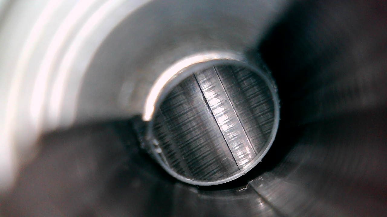

    Example #4 - 75% condition, obvious carbon and copper fouling; edges however still crisp and well defined. 120rds through, 1 dry patch through at the end of range day.
    Unfortunately I don't have 50-65% pics because that's when the edges start to look "soft" and "blended" due to the build up of carbon and copper and those definitely get a heavy clean to bring it up to a 90-95% condition (even if they have many barrel imperfections). I try to maintain a 70-90% barrel condition.
    CLR takes at most 15 minutes (wet patch left in bore on stubborn spot) for the stubborn spot.

    Example #1 - 90% condition, edges of the lands and grooves are crisp and well defined. Very little carbon remaining, some copper remaining. Heavy deposits of copper and carbon removed. Some imperfections from machining but imperfections aren't large enough that I want more "fill".
    Example #2 - 95% condition. Less than 1% carbon remaining, very little copper remaining. Edges of lands and grooves crisp and well defined. I won't spend the time to remove 100% of the copper. Most of the remaining copper is on the edges. View attachment 7759454
    View attachment 7759462View attachment 7759463View attachment 7759464View attachment 7759465View attachment 7759466
    View attachment 7759471View attachment 7759472

    If I could get this barrel anywhere NEAR that clean I wouldn't be fooling with this. I have not ever had this kind of trouble cleaning a barrel.
    I'm imagining a 50% condition or worse and probably have some hard carbon deposits, so I'll echo the CLR soak and cheap foam plug suggestions. Specifics below.
    What I would do at that point - invert the rifle (muzzle down), shove a foam plug in muzzle, drip or pour CLR into the barrel. Let soak for about 15 minutes, remove plug and let it drain, plug it up again with cheap foam plug, fill with clean water, drain, repeat clean water flush 3 times, bronze brush for 10 passes (loosens any carbon that didn't fall off by itself), plug again with CLR fill for another 15 minutes, clean water flush 3 times, bronze brush again 10 passes, dry patches until the patches are dried. Inspect the bore with a borescope.
    Every single time you pour the CLR into the bore and are waiting, just use a wet towel to wipe the action where you think CLR may have gotten on to (honestly I don't think it's necessary).
    At that point, if there are still stubborn carbon deposits in certain areas remaining, put rifle horizontal, soak patch with CLR, bore guide, insert patch at the stubborn area, leave patch in there for 10 minutes. This usually gets rid of it. Clean wet water patch through.
    After all that, KG-1 and KG-12 to remove remaining carbon and copper until I achieve a 90-95% condition. Finish with Breakfree CLP oil patch through and dry patch at the end to remove excess CLP or leave excess CLP in bore for storage. Remember to dry patch before use.

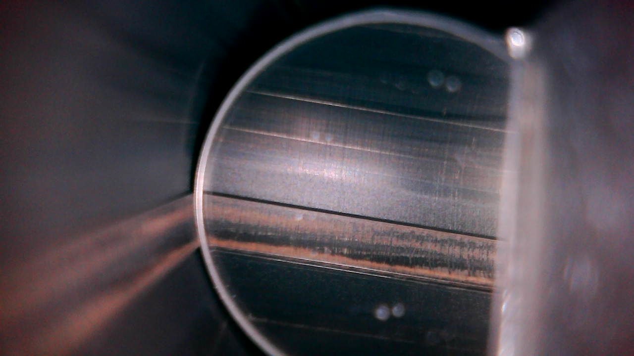

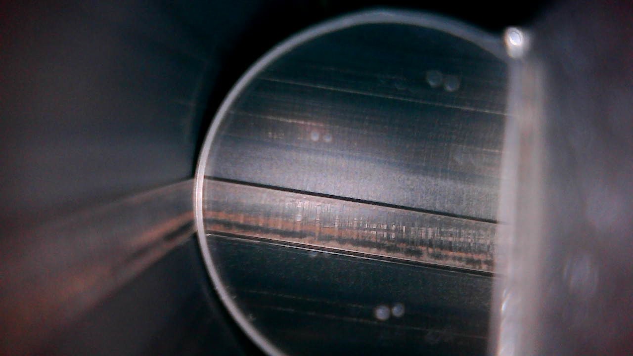

    Having a hard time getting my barrel clean even after a little brushing and several cleanings. I don't really care for the sake of being clean, but I am a little worried about the dreaded carbon ring. I am shooting win 6.5 stabal , and it's pretty dang dirty shooting powder. If I were getting my barrel clean each time I wouldn't worry about it but after inspecting my cleaning or lack there of with a borescope, I'm thinking I need to change my system a bit.
    I'm afraid to use any of the abrasive stuff but I may have to if I actually want it clean. Frank's words about using the abrasive stuff like Iosso or something like it has made me not consider anything like that as an option....
    Not sure where to go from here or even if I am getting it clean enough to prevent any carbon ring issues or similar issues. Had some weird pressure stuff that went on yesterday and it has me thinking about this. Could have just been the rain though....
    I guess my question is "how do I know when it's clean enough" and "how can I get it cleaner without risking my barrel being messed up" ???

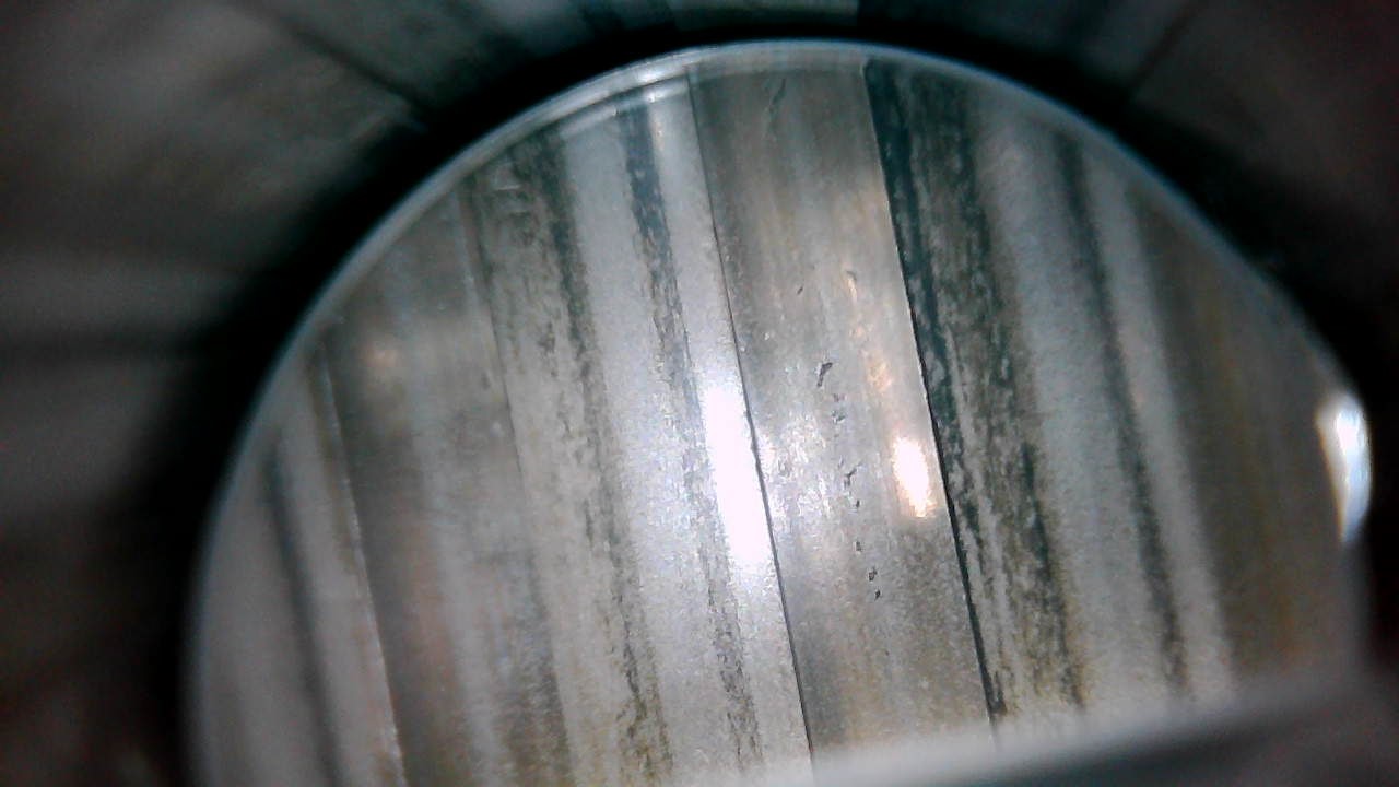

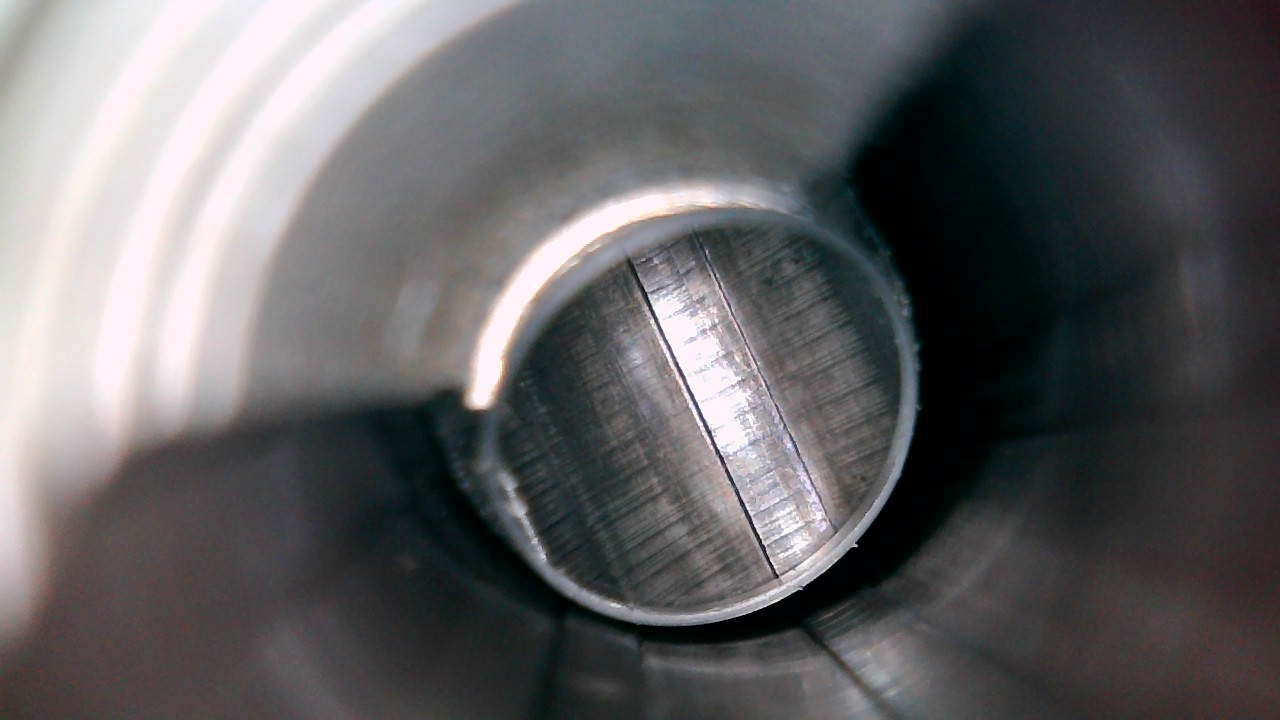

    I wrestled with that until I got this stuff ...

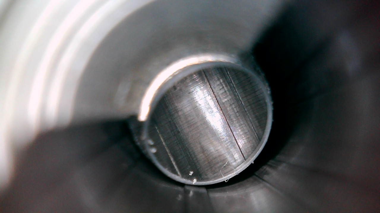

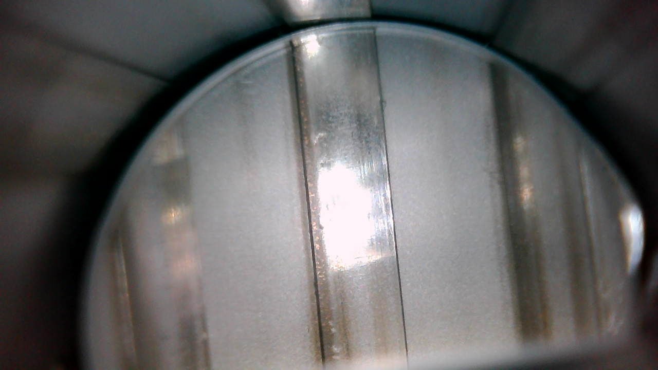

    She's soaking now.... I over filled it a little but my possum hollow bore guide seal seams to be holding and not leaking. I am keeping the rifle vertical (muzzle down in trash can) while she soaks. I'm hoping it will drip out enough to get the clr level down to below the bore guide but I don't think that's likely if I let it soak for 20-30 min. I might can actually dump it out the bore guide but if not, going to have to figure out how to get that plug out without pushing it with a cleaning rod.....
    I got the clr out and rinsed with a little more clr. Then I rinsed it with a little hoppes and then did a few really wet patches with hoppes, and cleaned the chamber out. Then I patched it until they were coming out clean. Big improvement but not quite like some guys barrels I've seen or the 90% one posted itt. This is probably typical of how clean I normally get my barrels, though I don't know because this is the first one I've ever looked in with my borescope.
    Reactions: Evintos
    I'd put that at a 80-85% condition and I would be happy with that. The carbon and copper mostly gone on the lands. The groove carbon is starting to clean up with some having been removed enough to expose the copper layer underneath. The fouling is mostly concentrated on the edges (hardest place to clean in my opinion).
    If you really, really want to get to the 90+% condition, CLR soak more to remove the hard carbon as well as start the copper removal process. Some of the hard carbon that is embedded into the copper layer will be removed with the copper, provided that the copper solvent can penetrate the carbon layer. If the carbon layer is too thick, the copper solvent won't be able to penetrate and you'll have to attack it with a carbon remover again.
    I'm pretty happy with this, I just didn't want to be doubting my groups and pressure signs and all while developing this load, because I couldn't get the barrel clean.
    Thanks all for the help.

    Heat and pressure are the things that kill a barrel. And a lot quicker than cleaning does.
    Frank of Bartlein barrels advice: https://www.snipershide.com/shooting/threads/carbon-ring-removal.7057856/page-2#post-9275488
    There’s a bunch of good Frank’s posts on that thread on a variety of cleaning topics.
    Vudoo on CLR:
    Yeah, I have watched the Vudoo vid before and enjoyed it. I do use Bore Tech and did some testing with copper pennies and diff copper removers and I'm sticking with Bore Tech. Worked the best in my estimation.
    Just past where he says do not use CLR, he talks about steel tornado brushes. My jaw dropped as I couldn't imagine anyone thinking this is a proper brush for a rifled barrel. I do use them on 12 ga shotgun barrels and they work wonderfully but there is obviously no rifling to chew up and what the heck...its a proximity weapon.
    Watch that part again. He says the SS tornado brush is "the worst thing to ever happen to firearms cleaning…the most barrel unfriendly device ever devised for cleaning…don't use those." Here's a direct link to that part in the video.
