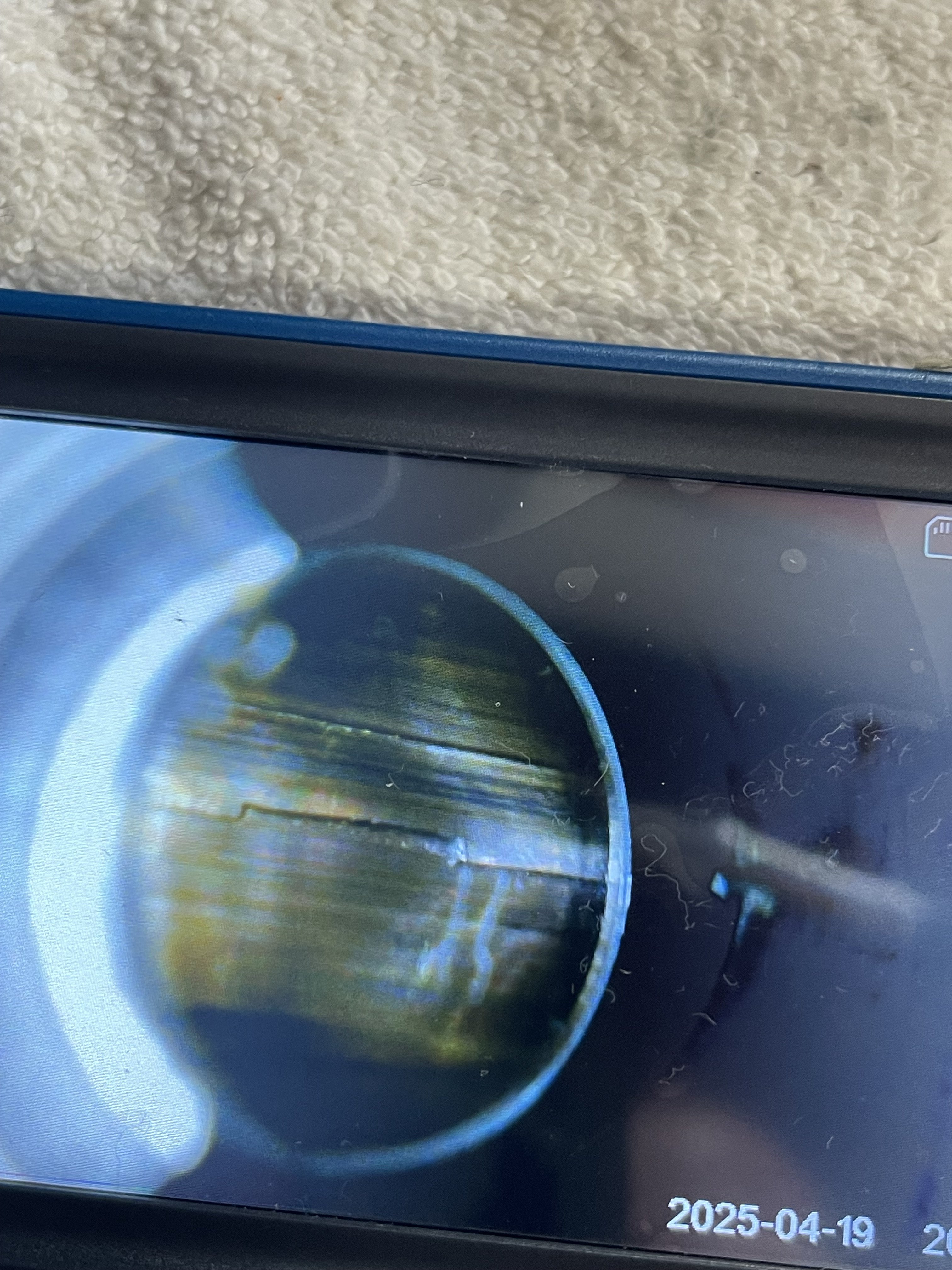

Well sent mine in yesterday. So the wait begins. The rimfire thread tagged above shows a guy with same issue. Sent in and 7 weeks later received two brand new flawless barreled actions back. So hopefully that’s the case with those of us taking the initiative to address the problem
I really want to love my bergaras. I like my 18” and was hoping my 20” would be even better and I would build a 24” off the 18” action.
Should things go sideways id just sell and find a Rimx or one of the newer actions to build on. But ideally I’d like to run a custom Bergara and a 20” hvy factory for my setups. Mags haven’t given me issues (other than one mag that was worn which I bought used) that’s in the factory stock, MDT and MPA chassis
Fingers crossed 🤞
I can say my initial contact with Bergara, email exchange and my photos I sent in were great customer service. Very prompt responses and so far zero delay or run around. Initial contact to them setting up a label for return was probably less than an hour
I have another match in a few weeks, but I'll contact customer service after that to see about sending mine in as well. Hopefully they turn around replacements quickly!
It’s a good test in today’s market for Bergara. I’m sure a lot of members or non members will come across these threads when purchasing a rimfire. It’s been referred to as “poor man’s Vudoo”. With Vudoo essentially out of the picture at least for now I’d assume the Bergara sales crept up a little bit.
They play in a dangerous price point in my opinion if you send out barrels like this and don’t make it right. Especially in the current market for CZ 457’s. Once you factor $850-$900 for a barreled action that will need a trigger upgrade you’re around $1100.
From the cheap end you can do a 457.
On the opposite side of the spectrum if you had this barreled action Bergara sitting on the shelf and I bore scoped it before buying I would just opt for a rimx action instead.
I’d compare it to 2010 where you bought a savage for cheap. If it didn’t impress you it was a “so what” and you rebarreled it inside your garage. But you bought the gun for $450 and an action alone was $350 on the used market. So you weren’t out much and could dump the barrel for $100
For the battlehawk armory deal which was $640 it’s not a terrible gamble. But when you start creeping up to the $1k mark with the chance of just using the action it becomes a bit more of a challenge to decide between that or $1150 for a rimx
