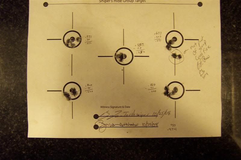

If you set the barrel back, you'll probably want to go more than one thread. The throats are long.
Here's what mine did, it was factory other than a home bedding job. It's just a little better now that SAS has cut the barrel to 20" and put a good crown and muzzle brake on it. Five 5 round groups at 100 yards.

nice shootin
